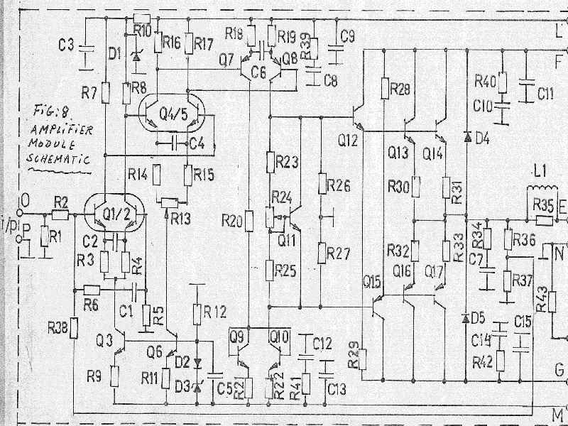

Are the schematics of this amplifier available somewhere? (the Ottala/Lostrow one)
I could be wrong, but I think it is the Electrocompaniet 25W classA
