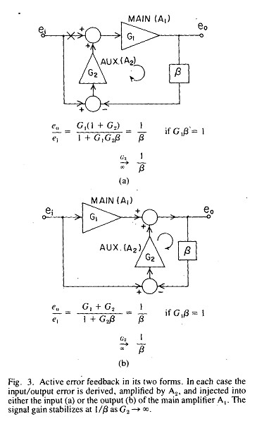

Hi lumanauw
Take a look here and here
Cheers, Edmond.,
Hi, Edmond,
I'm confused. Is it the same calculation if the connection point is base of VAS or base of (-) differential input? (Like Bob's http://www.diyaudio.com/forums/attachment.php?s=&postid=1368243&stamp=1196892957)

Hi lumanauw,
Sorry, I forgot this link
Bob's C2, C5 and R36 is my C1, C2 and R1 respectively.
Cheers, Edmond.

lumanauw said:
Hi lumanauw,
That circuit is essentially the same as fig. 3a in:
J. Vanderkooy and S.P. Liphsitz, "Feedforward Error Correction in Power Amplifiers", JAES, Vol. 28, pp. 2-16, Jan./Feb. 1980.
Cheers, Edmond.
