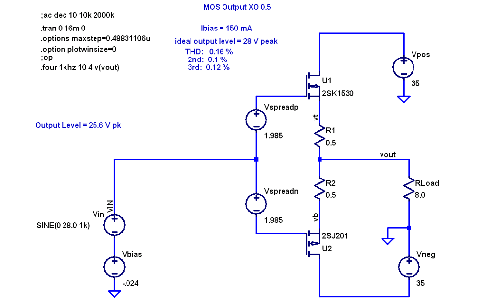

G.Kleinschmidt said:
Your own vertical MOSFET OPS measurements as revealed in your EC amp paper (150mA bias, 8 ohm) give the open loop THD “on the order of 1% as pictured in Fig. 10(a) and (b).”
Hi Glen,
You raise a good point. The difference from what I published 25 years ago and now can be largely explained by a number of factors, one of which is my sloppy language in describing the open-loop output stage distortion.
I said, “… this transconductance variation can result in open-loop output stage harmonic distortion on the order of 1% as pictured in Fig. 10(a) and (b). Mismatches in the transconductance characteristics of the top and bottom output devices also contribute to the distortion of Fig. 10.”
“On the order of” is pretty sloppy language, and I should have been more clear that I was not referring to an rms THD analyzer result, but rather the peak values of a distortion residual.
Take a look at Figure 10(a). The distortion scale is 0.5% per division. This means that a distortion sinewave at 2 kHz producing 0.5% measured THD would have its peaks at plus and minus one division. The biggest peaks in Figure 10(a) just go beyond this 0.5% point, but most of the residual is less than this. So the distortion as read on an rms THD analyzer would be more like 0.3% to 0.4%. Also notice a fairly strong second harmonic component. This is also suggested by the output device asymmetry shown in Fig. 9.
The Toshiba MOSFETs I have used recently are superior to the first-generation HEXFETs I used 25 years ago. For one thing, they are much better matched, resulting in quite a bit less second harmonic distortion.
There is another interesting issue. Note in my current output stage I use 0.5 ohm source resistors, where I used no source resistors in my old amplifier. The introduction of the source resistors typically cuts output stage distortion in half. A simulation using the Toshiba devices in the same arrangement as in the old design, without and with 0.5 ohm source resistors, shows THD numbers of 0.3 % and 0.16 %, respectively.
While the introduction of moderately-sized emitter resistors in a BJT output stage tends to cause gm doubling in the crossover region, the MOSFETs tend to benefit from the introduction of such resistors because it helps offset the transconductance droop they suffer in the crossover region. See my Fig. 9. The 0.5 ohm resistors cap the maximum transconductance of each output device to less than 2 S.
The cost of employing the source resistors is a slight loss in headroom at high power driving low-impedance loads. Consider a 100-watt, 8 ohm amplifier with two output pairs, each with 0.5 ohm source resistors. When driving 40V peak into 4 ohms for 200 watts, we have 10 amps peak, and a loss in output stage headroom of 2.5V. This means that we would have to use rails that were 2.5V higher to get the same clipping power into 4 ohms as we would if we were not using source resistors.
The only thing I’m having to scratch my head about is the relative increase in THD going from 1 kHz in Fig 10(a) to 20 kHz in Fig 10(b). It looks like it went up by a factor of about 2.5 times, and that seems a bit much given the speed of the devices, even back then.
Bob

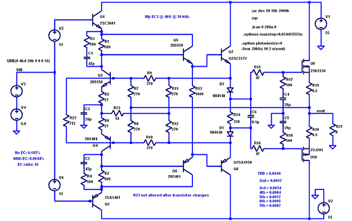

Hi Edmond,
Thanks, this seems to be a nice explanation. I'll have to give it a try with some simulations.
Below I have attached the schematic of my EC output stage using the Sanyo and Toshiba driver transistors.
Interestingly, I changed the transistors, tweaked the bias back to 150 mA, and ran the distortion without re-optimizing the EC trim resistor, and the distortion went up only very slightly from before.
Bob

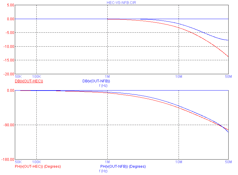

Hi Bob,
Now the gain and phase plots look completely different. For example, the 1dB gain bubble has gone and the phase shift is far less due to the smaller gate stoppers. Interestingly, when I remove the compensating cap C10 (39pF) in your original schematic, your OPS also has a small gain bubble (0.5dB at 3MHz).
In order to create a playing level field, I've used the same transistors in your OPS as in mine, so the fast 2SC3601/2SA1407 as driver and for all other BJTs 2N5401/2N5551. The 95pF compensating caps might look funny, but at this value the Ft of the NFB loop gain is exactly the same as in your OPS. Needless to say that the gate stopper stuff is also identical.
The phase lag at 10 MHz has improved from 70 to 40 degrees and, if you don't mind, it is even slightly better than HEC.
And the distortion, HEC: THD20=70ppm, NFB: 55ppm (BW=200kHz).
Cheers, Edmond.
NB: red = HEC, blue = NFB.

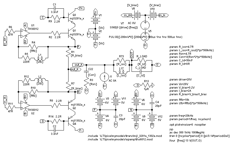

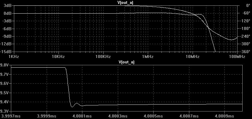

Hi Edmond,
this last OS looks nice. I tend to interpret it as (sort of) a unity gain current feedback op-amp.
I simmed a somewhat similar stage with current feedback, but it's class A. In your schem one would need to add complementary EF's ahead and tap off the feedback from the output's sources, directly feeding into the emitters of Q2/Q3 via a gain set (closed loop) resistor. Thus, standing current would be set by the voltage offsets divided through the source R's, and no other biasing would be necessary. The source R's would be outside the loop, as I'm not the maximum damping factor camp, but they could be quite low, depending on bias currenz.
Actually I tried that with current feedback op-amps (and using bootstrapped supplies on these, which is a key point besides the cascodes) and got extremly low THD/IMD, sub ppm THD20 levels at full load and almost unmeasurable with LTspice at low drive and/or freq conditions (OK, class A is cheating). Quite successfully with different cfb op-amps and different bjt outputs I tried, now I'm about to replace the op-amps by simplified discrete circuitry
Should I start a new thread and elaborate on this? It's heavy feedback, after all...
- Klaus
ahem, it's 20Vp into 8ohms//50nF (clip limit is 5.5ohms), so it's only 25W with a 20Vp sine.
But the THD numbers are true... believe me, I really hesitate to believe it as well, mainly because the op-amp models all state "distortion not characterisized" (that's why I need to sim it with discretes, and build it). But, in fact when I sim the op-amps as simple followers with no load and 2Vp drive, I get more distortion from the op-amps alone! I tried THS6012+MJL3181/1302 and AD811+MJE15032/33. OTOH the op-amps run at optimal conditions: no common mode voltage and only little output swing, less than 300mV for the shown circuit. Also, the cascoding helped a lot. The stage is virtually isolated from the drive/output voltage, it only "sees" output current. Of course the design is not finished at any rate (not procection of any kind, won't like >0.5uF at the output), it's only a study so far...but the stunning numbers make me think I give i try, instead of fiddling around with chip amps biased to class A by the same method (which is how I came across the whole thing).
Blocks of this stage could easisly be parelleled (and bridged) to give more power and low load (2R) stability... also the front end biasing is easy to do with resistor dividers to (seperately regulated rails)
Attached is the .asc (renamed to .txt), the bjt models are those from andy_c and the THS6012 comes directly from TI.
- Klaus
  • class_a_os.txt
