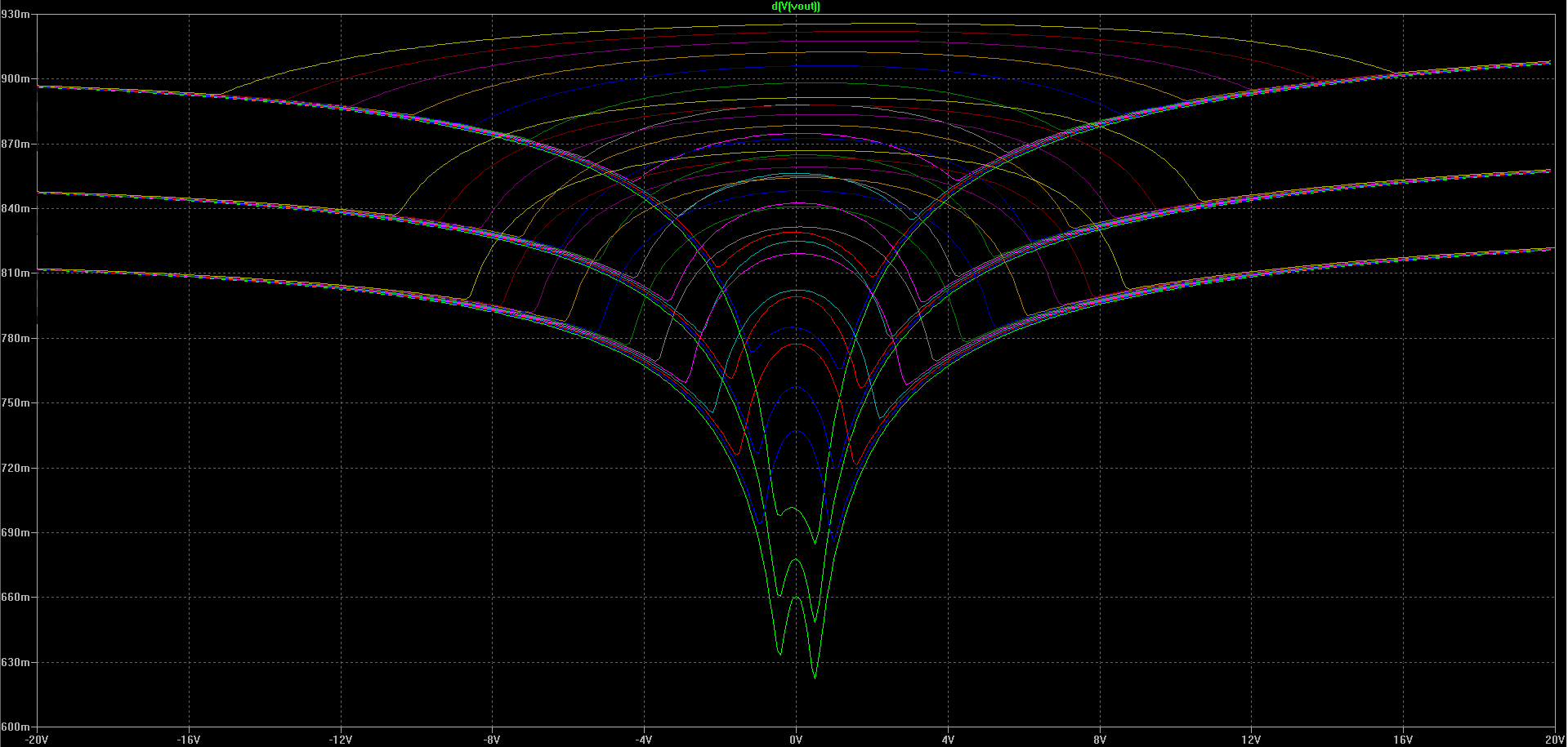

I decided to post here a wingspread of laterals with shifting bias and Rs just to see if it works

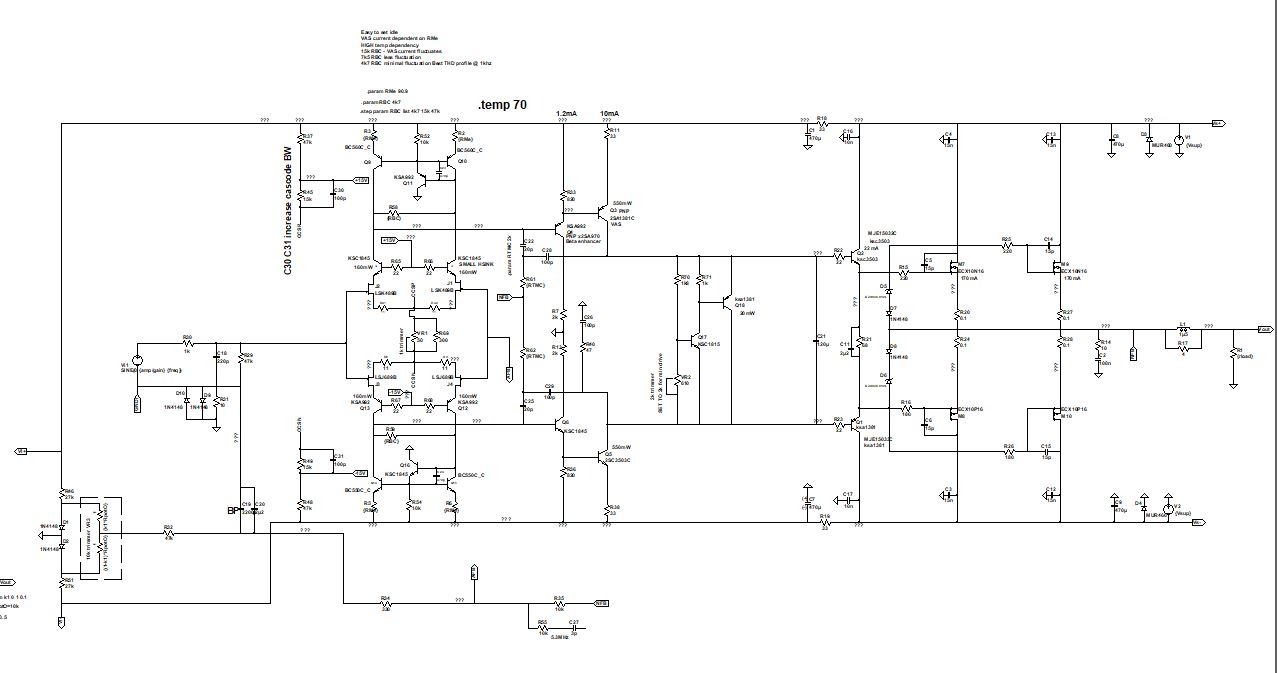

Hello Bob
Just finished building my version of the DH220C using the excellent LSK489B and LSJ689B for the IPS.
IPS current is set by a resistor placed between the emitters of the jfets.
I am not using a servo so there is a DC null cap in the NFB circuit.
VAS current is stabilized by 4k7 resistors shunting the collectors of the positive and negative mirrors.
The amplifier works and all currents and voltages are near simulated values with an average difference of 2%
Current on the IPS jfet emitters is very stable as well as current in the VAS buffers.
Simulated current in each VAS is 12mA but in my build it is never super stable.... It fluctuates between 12,7 and 12mA changing 0.1mA each second.
Increasing the shunt resistors (R58 and R59 in my build), does reduce THD but VAS current is even more unstable.
Is this behaviour normal ?
What should I do to completely stabilize VAS currents ?
