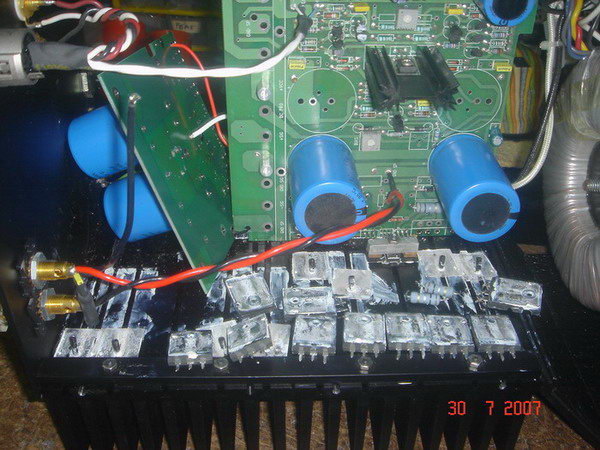

Hi, Mr. Hansen,
How can I overcome this? Now I have 2 idea in mind, putting base stoppers or put output inductor. But what is most effective?
This amp has a bad habit. This is the 3rd time it blows the whole output transistor. I wonder if this relates with the point (c) you mentioned above.
Where the PS intrusion comes from? Is it from 1N4148 cascodes?b) The PSRR won't be very good, so you will need excellent power supplies.
c) The output stage will tend to oscillate with capacitive loads. This is just a fact of life with BJT emitter followers. You have to take preventative measures to keep them from doing so.

lumanauw said:Where the PS intrusion comes from? Is it from 1N4148 cascodes?
The best way to approach the problem is to pretend that the power supply rail is the input port to that stage. Then figure out the gain of that stage, as referenced to that input port. Some topologies are better than others in this regard.
lumanauw said:How can I overcome this? Now I have 2 idea in mind, putting base stoppers or put output inductor. But what is most effective?
99% of all power amps use an output inductor. I'm opposed to this on philosophical grounds. All of the textbooks that talk about this problem say that the answer is to use a base stopper. But in the real world the base stopper would have to be so large that it would significantly impact the output impedance of your amp.
It only took me two months to figure out an answer. Maybe you can figure out a different one sooner.
Have fun.

Hi, Anatech,
Yes, I got scopes. I will look with R load and R//C load.
Hi, Mr. Hansen,
I haven't found out one riddle that AKSA gives me, now another difficult one
Hi, Mr. Hansen,
I guess you have found an answer that is not "output inductor" and not "base stoppers". I cannot figure it out. Do you have more clue?99% of all power amps use an output inductor. I'm opposed to this on philosophical grounds. All of the textbooks that talk about this problem say that the answer is to use a base stopper. But in the real world the base stopper would have to be so large that it would significantly impact the output impedance of your amp.
It looks like it will be too long for me to find outIt only took me two months to figure out an answer
