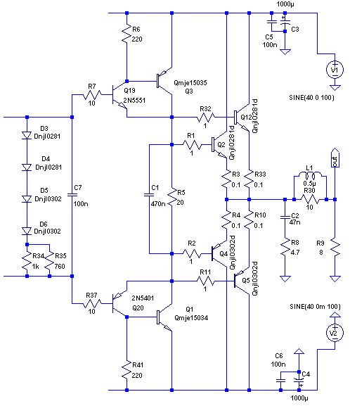

I don't understand what's so appealing with perfect bias stability.
I feel very comfotable with overbias (~160mA/device) at switch-on going to optimum at normal working conditions at moderate listening levels and finaly to underbiasing (60mA/dev or even lower) when the heatsink has a fever (~45deg.C).
I mean with proper design it should not make a big difference wheater bias current is slightly away from optimum point and negative thermal coefficient makes sense as thermal economics is concerned.
I use bjt triples( |<,|<,|<, ), complementary Vbe multiplier and pre-drivers out of main heatsink.

Why not put all 16 Thermal Trak diodes in series, take the voltage across all of them and divide it down to derive a sensor voltage. Or, have two diode strings, one for each sex output, divide, and apply each one to half of a complimentary Vbe.
This way, all outputs are monitored to derive an average. The diode string could be fed from a 25ma constant current source. Also, the voltage division could be varied for less than full diode increments.

The situation isn't always quite that rosy. Depending on the particular ThermalTrak bias scheme used, not all of the ThermalTrak transistors' diodes will play a full role in the Vbe multiplier. For example, let's say you build a big single-ended amplifier with eight ThermalTrak output pairs, 90V rails, and bias each transistor at 150 mA with 0.1 ohm resistors. How are you going to use all of those 16 ThermalTrak diodes, much less in a way such that each diode individually tends to the bias of its associated BJT?
Bob

Again, I have not found this to be a problem in the real world. There are hundreds of thousands (if not millions!) of BJT amplifiers in the world that have paralleled output devices, but by-and-large they are pretty darned reliable. All of these theoretical considerations simply are not borne out in the real world.

"the Locanthi three-stage cascaded complementary symmetry emitter-follower output circuit, hereafter referred to as the T-circuit. (Because of its PNP-NPN symmetry, the configuration has a general appearance of a bridged-T circuit.)"
Locanthi was a true genius, making many contributions to audio, both in the field of electronics and loudspeakers. In addition to the T-circuit (which is still the best output stage extant, IMO) ...
What do you think about this output stage? It has the same input impedance as T circuit but it is more rail efficient because it has only two series BE jonctions and as a plus it is more stable as a result of local feedback on CFP driver.
roender said:What do you think about this output stage? It has the same input impedance as T circuit but it is more rail efficient because it has only two series BE jonctions and as a plus it is more stable as a result of local feedback on CFP driver.
I personally don't like the sound that feedback creates. YMMV.
