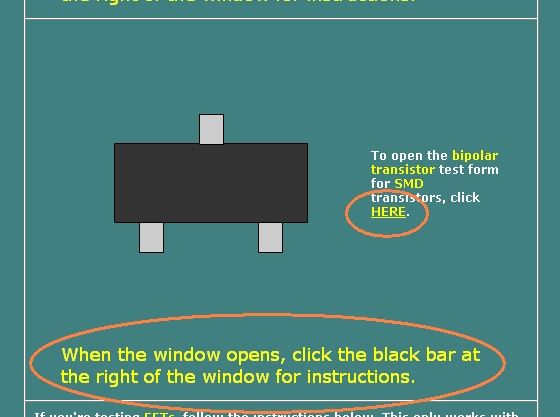

You'd want to confirm that the meter reads OL base to emitter and base to collector with the probes placed one way and several megaohms with the probes reversed. It should read OL no matter the placement on the collector and emitter.
If you're still unsure about the test procedure, go to the following page. Find the section shown in the attached image, read what's circled and follow the instructions. In this instance, it would be better to set your meter to ohms instead of diode-check because the transistors may only be leaking.
Basic Amplifier Repair - Transistor Test Applet Link
