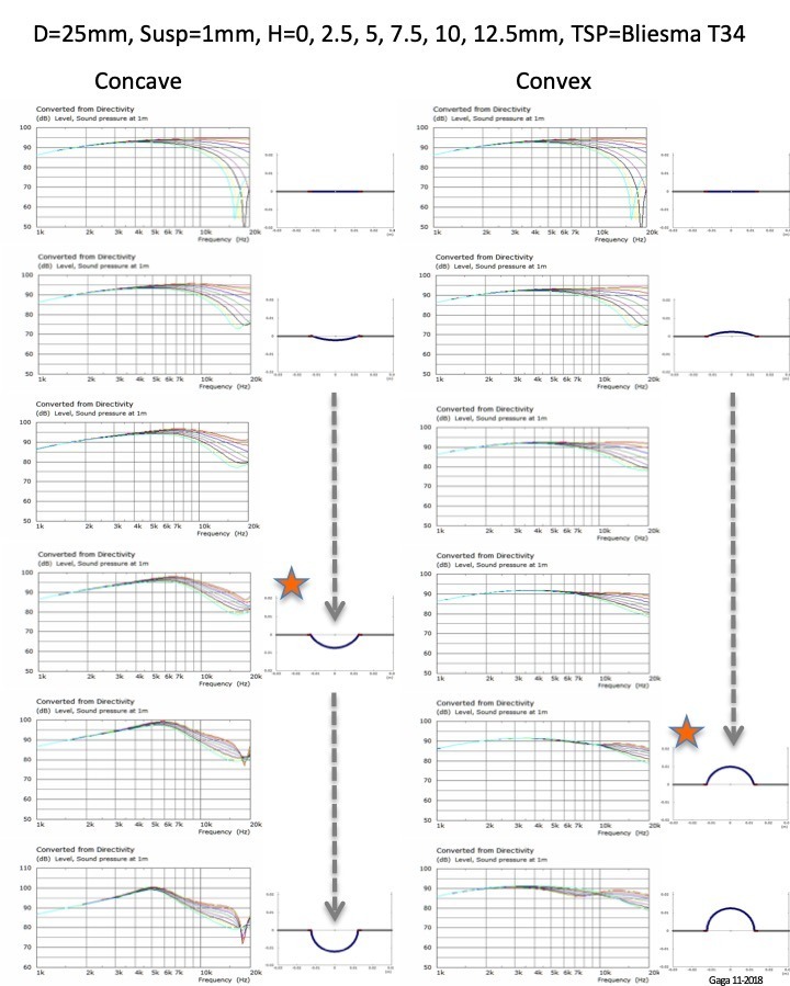

@profiguy The Bliesma A membranes have great off axis radiation and have a very high dome. The flat B's are not as good in that regard but way better for waveguides. This simulation flies around the internet - sorry I don't know the creator.
Reactions: 1 user
Looks like one of Gaga's images, he has made many such simulation comparisons
https://www.diy-hifi-forum.eu/forum...y-wie-geht-das&p=243693&viewfull=1#post243693
The B's are easier and more forgiving in waveguide designs for sure, but they cannot be as wide from 10 to 20K as the A's if that is a design objective.
Unless the speaker is intended to be used in an infinte baffle, those simulations start to lose applicability to wide radiating domes in waveguides, where the entire cabinet in 3D has to be included to have any hope of getting an accurate simulation. I fell into that trap for quite a while myself.

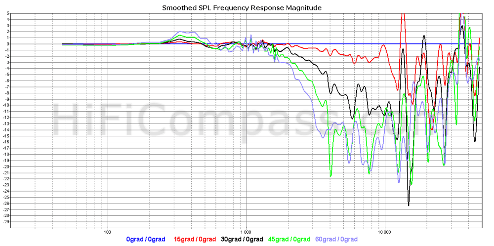

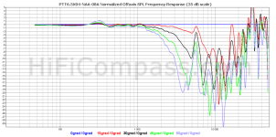

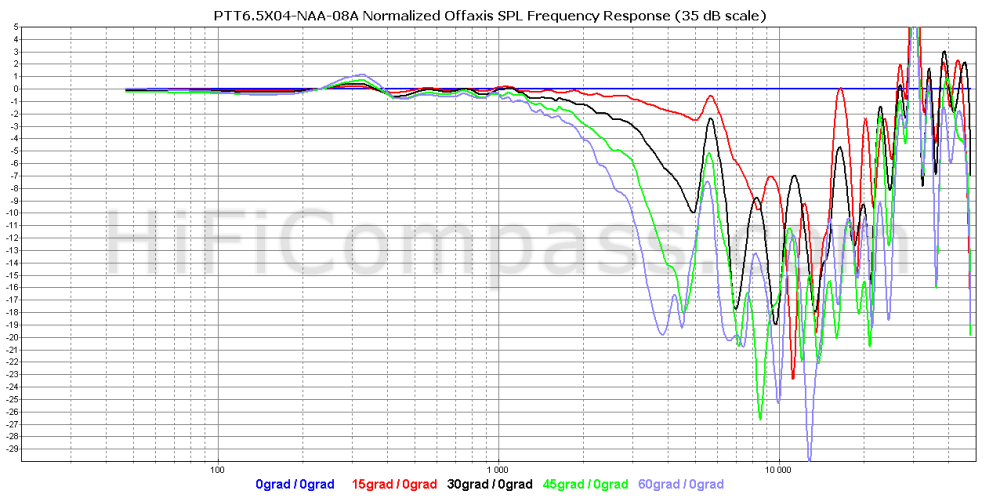

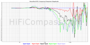

I will have to dig my data out somewhere to illustrate this. But in the meantime, here’s a taster of what I mean.
Courtesy of www.Hificompass.com
Relative to the on axis response (akin to what would happen if you could massage the on-axis frequency response to perfectly flat +/- 0.0 dB), this is what a few of the off axis responses would look like at 15, 30, 45 and 60 degrees, for the PTT6.5X fibre cone.
and aluminium cone PTT 6.5X:
You can see that in just 4 different angles, there are differences in the typical pass band eg. 40Hz to 2-3KHz; as well as the stop band (beyond 2-3KHz)
Thanks for the source! Woha - these guys do great stuff!
Therefore I use the B's in waveguide (front) and A's for wide radiation (rear/ceiling) in my next project. Looking forward to it!

Thanks for your nice words. Yes, these images were made by me and are taken from the thread on 'How to do a waveguide and achieve constant directivity' here.
At that time, I simply tried to understand what are the best concave and convex membrane forms for optimal (i.e. wide directivity up to the high frequency range) directivity. Starting from there, I learned that a tiny 'step' around a convex tweeter membrane (as we usually use) significantly improves directivity behaviour.
With respect to different shapes of convex domes I learned, that Blisma was spot on for optimal directivity ( I assume they exactly knew what they did here). I was simply surprised about the nice characteristics of the Blisma tweeters and wanted to learn, how they achived this.
