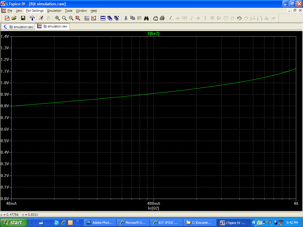

IIRC, Hfe linearity improves with higher Vce, and there is also Early affect. This parameter would be Vaf in the model.
- keantoken
keantoken
you say linearity improves, but, would the Hfe increase with higher Vce?

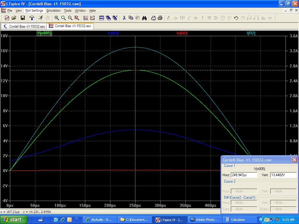

keantoken,
hey, if you don't try, you don't learn... just thinking about these things helps;
Bob Cordell gave an answer in the Spice Simulation thread
http://www.diyaudio.com/forums/software-tools/101810-spice-simulation-new-post.html
Ken
Ken

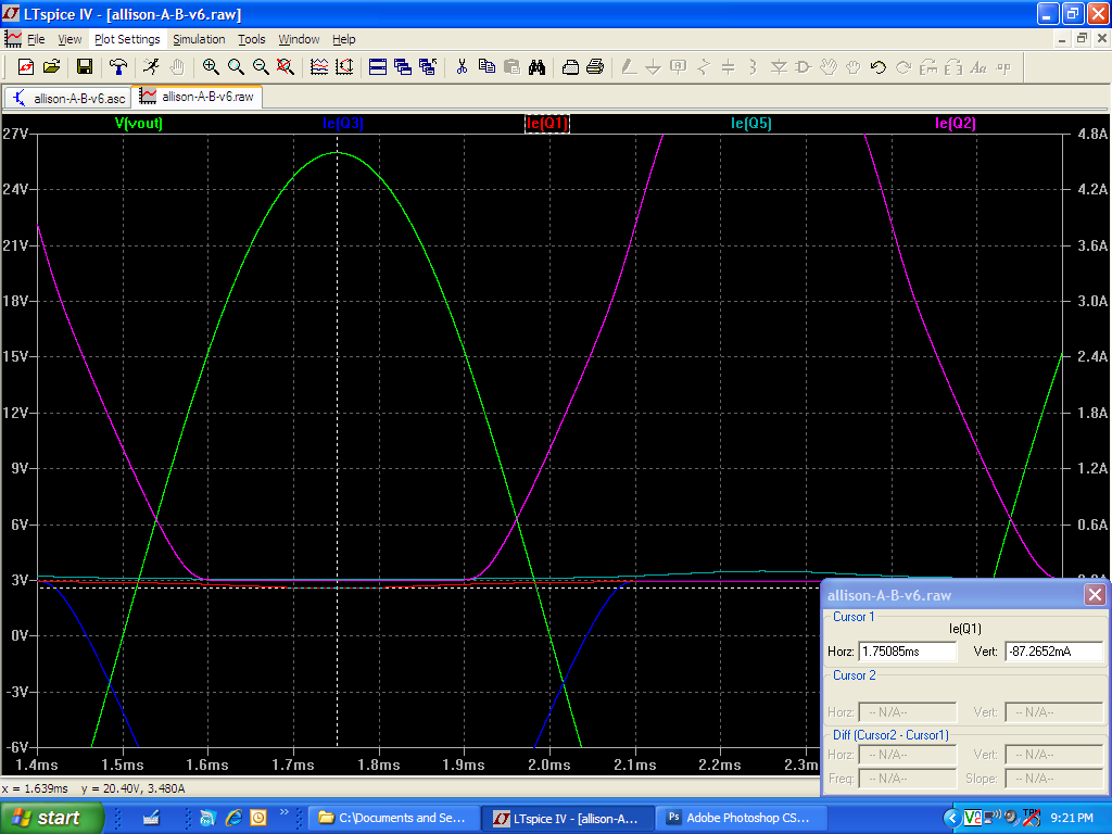

I'm sort of understand what you're saying... I would interpret it as the hFe of the output transistor puts a demand on the driver transistor. A low hFe transistor will draw more current through the driver to satisfy the load requirement... yes?
So, I ran the Allison V6 sim at 26v in 4r0 load. Each output transistor produced a the same 6.499A pk, but the pnp driver had to produce approx 97ma current vs the npn at 87ma pk. Plots attached.
Interesting...
Probably not over taxing the driver, but, I'll have at what happens when I turn up the wick.
Ken
Interesting...
Ken

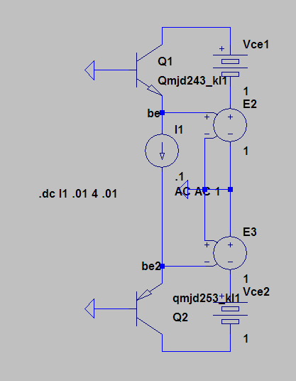

For the pnp tranistor, sorry, I renamed it Q2 with the npn being Q1. Schematic attached
Have a look at the prior plot, at the bottom, it is Ie(Q2) not Ic(Q2).
Version 2.1!
Changes:
1: G for tranconductors was decreased.
2: Node names modified to be less redundant.
3: .op simulation command added with instructions for the use thereof.
4: PNP transconductor reversed, so that Ib2 plots correctly as a negative value.
Bugfixes:
1: Certain transistors would cause it to malfunction, this was fixed by decreasing the G's. If any errors result, this value should be decreased to see if that fixes the issue.
I think a Vce sweep for viewing Vaf is possible as it is, but I think it could be modified to be made more intuitive.
