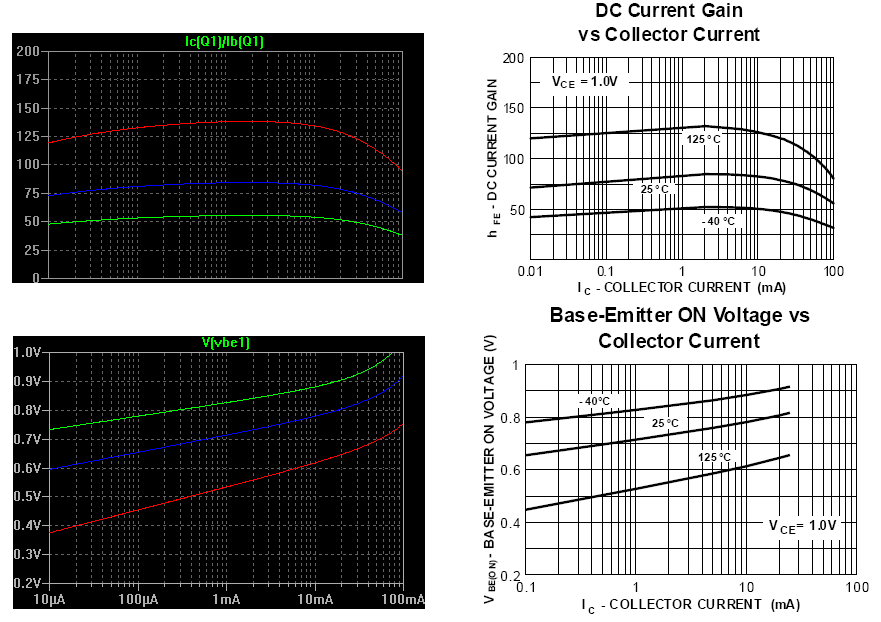

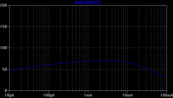

First, let me address your 2N5769 model. Reducing Ikf reduces the value of Ic where the (high) current gain rolls off, and Ikf of 50m makes this too low. You can see this effect by plotting Ic/Ib vs. log(Ic). I think the original model is better in this respect. According to the data sheet you referenced, Ic is nearly constant from 1 to 10 mA.
Regarding typical values on the data sheet. When I was a young engineer, my boss and I were discussing a circuit I designed. I don't remember any of the circuit details, but he wasn't too happy about some of the values I chose. I said "I used typical data sheet values in my calculations." He said typical means they saw one like it once, but they may never see another one - in other words, typical is meaningless. It's not really that bad, but you should never depend on having typical values to make your circuit meet specifications.
Yes, negative feedback is a way to make circuits less sensitive to device parameter variations. As I have pointed out previously, the Allison circuits have a high open loop gain and a feedback factor of 1.
I'm not worried about the Allison circuit, and it is not the specific reason I chose to look at the 57xx models (although I probably gave that impression). I am more interested in their application as a VAS. If they can be expected to operate no better than the datasheet specifies, then I save myself the trouble of getting optimistic simulations.
I am looking at the models again, but even with the current value of IKF they still look a lot like the datasheet. (Hfe is very low, actually, but the curve is amazingly similar)

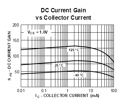

I am not sure what you mean when you say Ic is nearly constant from 1-10mA. Hfe crests at 2mA, and though it is quite flat until 10mA, by going past 2mA we've already started injecting strange harmonics (which gets worse since the Hfe of these is very small).
Maybe I'm nitpicking?

Okay, I realized a large error with the models, which is the rather low Hfe (much lower then typical values). That should be rather obvious from my last post (eep!). :cubehead:
I'm working on correcting this. I keep making that mistake by reading the original graph wrong. Out of boredom I've begun to look at temperature-related effects.
Please understand that this is a learning experience for me, and even if it doesn't make sense to make better models for these devices, I'm gonna do it anyways.

Okay, here it is (FINALLY).
By pure trial and error (and great patience), I have deduced that:
Adjust Is first, to get Vbe right. Then adjust Eg to get tempco right.
Then move to Ikf.
There are three components I use concerning the Hfe curve:
1: Hfe at top of crest.
2: Ic where Hfe crests.
3: Point between crest and max. Ic where Hfe falls closest to an integer.
4: Slope of Hfe from beginning to crest of graph.
From I deduced that:
1: Crest of Hfe was 85.
2: Ic crests at 2mA.
3: At 30mA Hfe is 70
4: Hfe changes by 15 from 10uA to 2mA.
During my journey I noticed that:
1: A low value of Ikf will make your actual gain much lower that Bf.
2: It is best to choose a good value for Ikf first and then use Ise and Ne to adjust the curve.
3: The difficult part is getting the slop right as well has the Ic crest. To do this you have to change the ration of Ikf to Bf.
I think we call this the Babylonian Method...
Anyways, here it is. I've attached a comparison between the datasheet and SPICE.

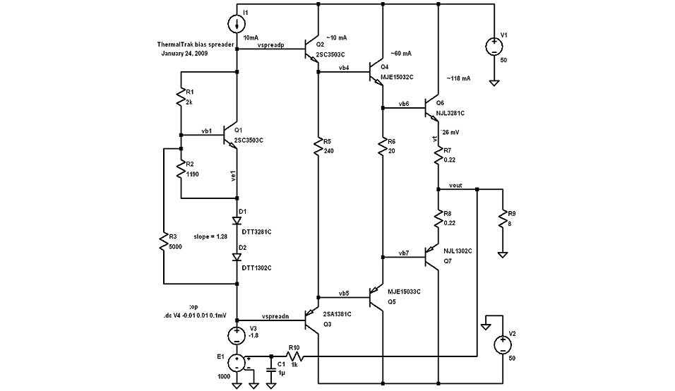

So, I know this is off topic, but, was wondering if you could help. I'm using a LME49811 for the front end of my amp - first and second stage - and was looking for a simple way to simulate the third stage including the bais scheme. I found this image from Bob Cordell, but don't know how to get it to work. I've also attached a zip of my model. Any thoughts? I would like to model the bais along with the output stage. I've been able to get the bais model to work by its self and the third stage as well...
Ken

That was interesting. In the VAS, you are applying positive feedback instead of negative feedback (your image is wrong it seems). Try this.
I used different models, so you'll have to change them back.
- keantoken
