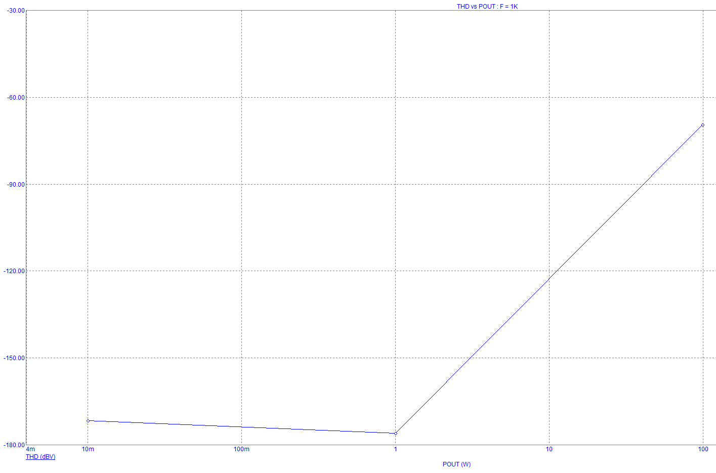

Simulation of my bridge amp in Microcap12
Nice, did you publish a schematic, or build it?
I hope the day will come when I can show that schematic.
We all know simulation is one thing, reality is another
Yes, built already and still has some issues.
