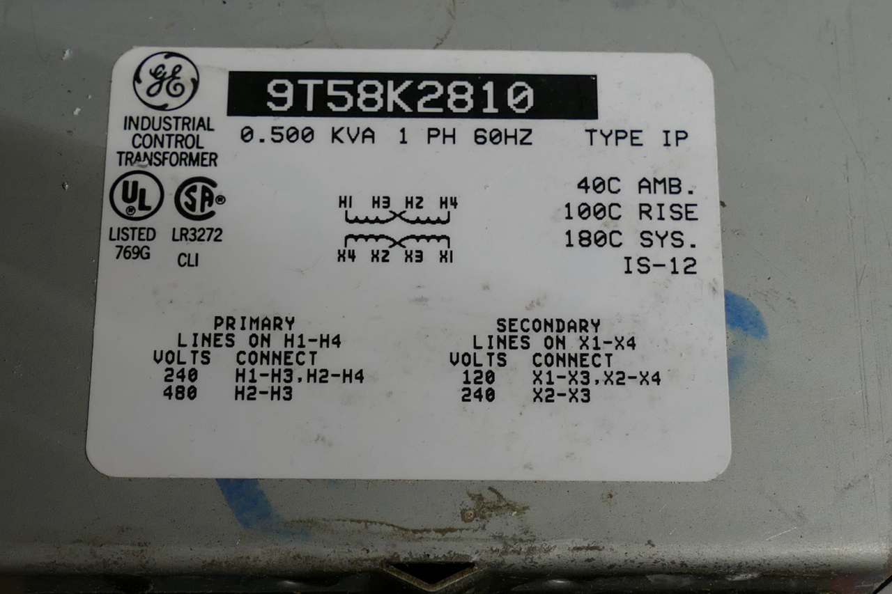

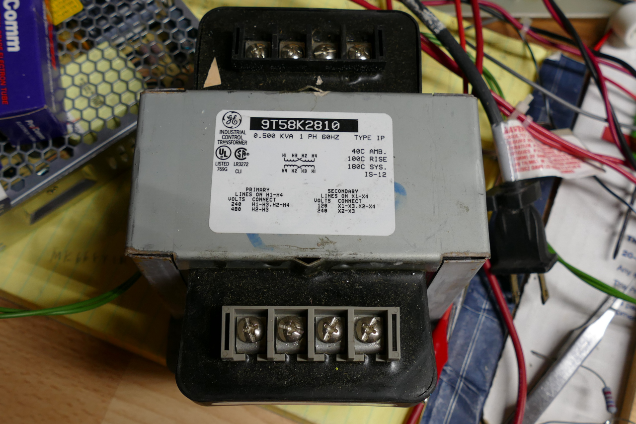

Most of the industrial control transformers I have seen have a pair of 120 volt windings on one side and a pair of 240 volt windings on the other side. Feed the low voltage side with either 120 volts (windings in parallel) or 240 volts (windings in series). The secondary is a pair of isolated 240 volt windings, which can be used independently (think circlotron) or wired in series or parallel.
I got several of these on Ebay years ago along with some 1KVA versions. The shipping costs more than the transformer. Find a seller that will stuff them into a USPS flat rate box.....your letter carrier will HATE you, but I got the transformers and the shipping for under $40 each.

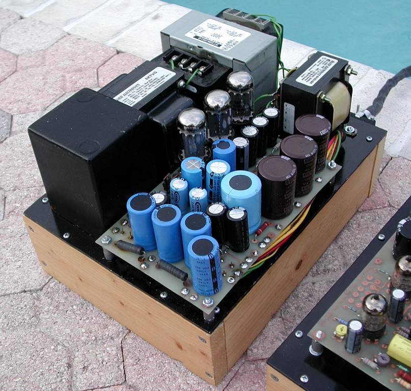

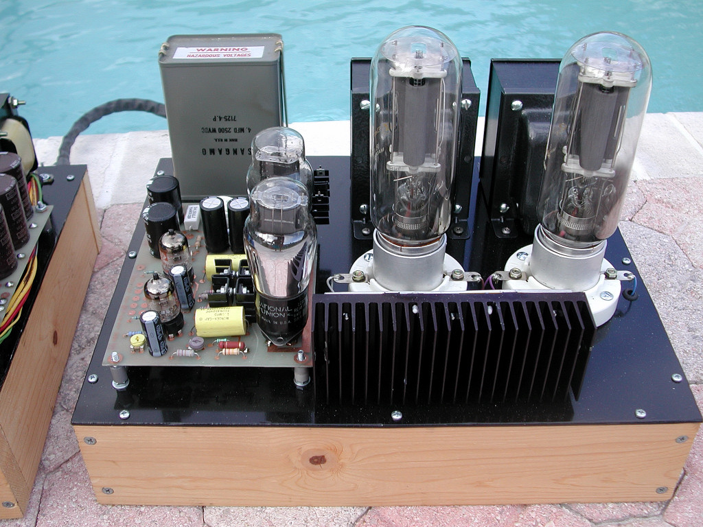

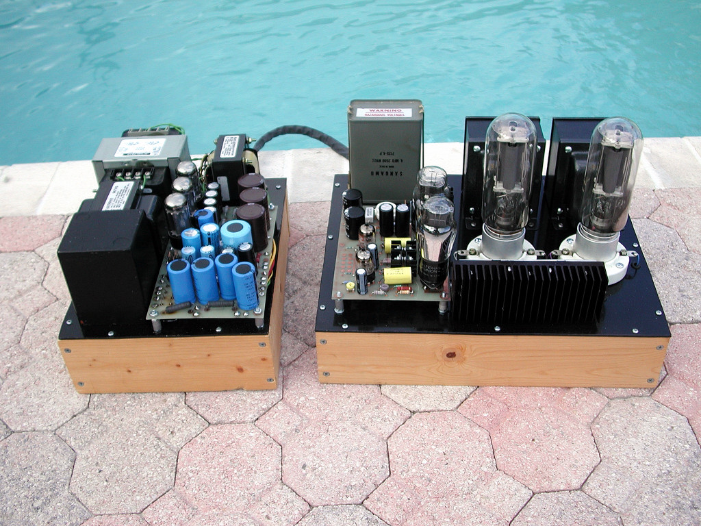

One of these runs the plate supply in my 845 SE DHT amp. It uses a voltage doubler made with 5AR4's on a 480 volt wired secondary that generates 1050 volts at 150 to 200 mA.

The ones I can get cheap (surplus) only have a single 120v winding as far as I can tell. If I get some that have dual, or they turn out to have it then I'll be fine. However, 1440v is assuming I stick with a halfbreed choke/capacitor input filter. Wouldn't that be quite hard on the 866As and their peak current rating? If I make a true choke input filter, wouldn't I need all 1920v? I read that a choke input filter gives an output of approximately .9 of input. In addition the 15v tube drop.
