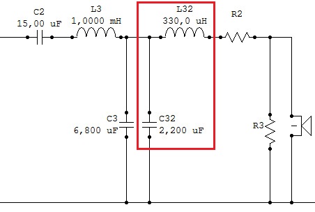

Vifa phase optimisation
Mount the SLS315 on a 1m tall baffle improves a little the bass response.
Having a little more time to think. It could be a next step of optimisation of the speaker with the vifa mid. The vifa is a smaller driver than the SDS and has a better response in the treble.
I don't know if the result will be very audible. For those who want to listen (a tweak for less than 10$)
The idea is to transform second order to third order low pass crossover on the vifa mid.
See schema below. The spl response is not changed at all, but the phase is different. The treble should have better transient and attack.
That's all.

Post #63 - is L32 and C32 added into the circuitry or do they replace L3 and C3?

Post #63 It is an addition, they don't replace L3 and C3, they only improves phase tracking.
