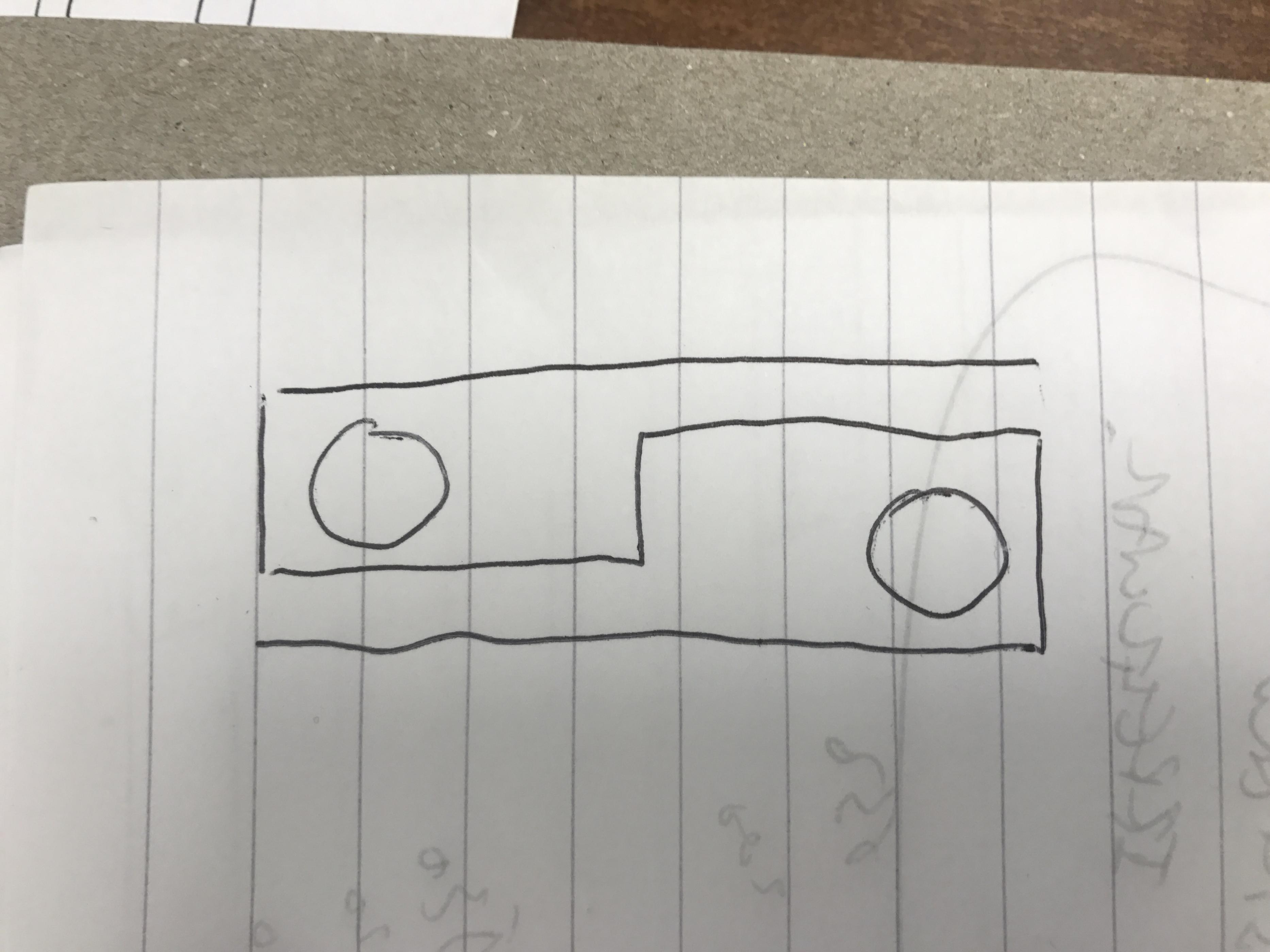

However your last drawing is basically two subs with double volume? Or am I missing something here..
I am still learning modeling software and so far it only pre-calculates tke length or diameter of the vent, so I have to learn to specify both parameters and see what I get. Is there another way to do that by changing box parameters?
Also, I understand that a standard port inverts a phase of sound wave, so in result you get a half-period delayed wave summed with actual wave, so the sound should be not as "accurate". But you probably don't need "accurate" at 30Hz.
What a very large vent does I have no idea. Probably same thing as adding insane weights on to passive radiator, which lowers overall Fs? Reading continues...

I haven't done it before, but in theory, I'd go with these ideas combined:
...assuming you can hang the speaker directly behind the listening position.
Each halving of distance is ~6dB of gain, so a sub that is 25cm from your head rather than 100cm from your head will subjectively have about 12dB of 'boost'. That's a big deal. It will also be 12dB less loud for your neighbors.
A ~12 dB proximity boost is much larger than the boost you'll get from choosing one (small) enclosure over another.
My two 6.5s are in sealed 0.5 QTC boxes and with room gain get fairly low.
