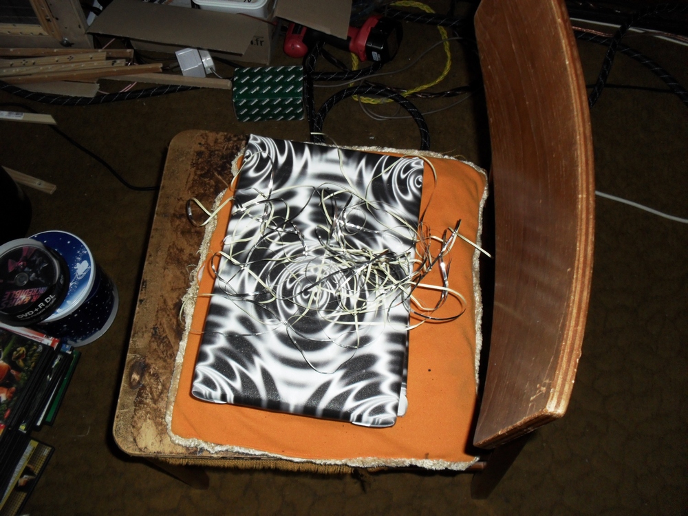

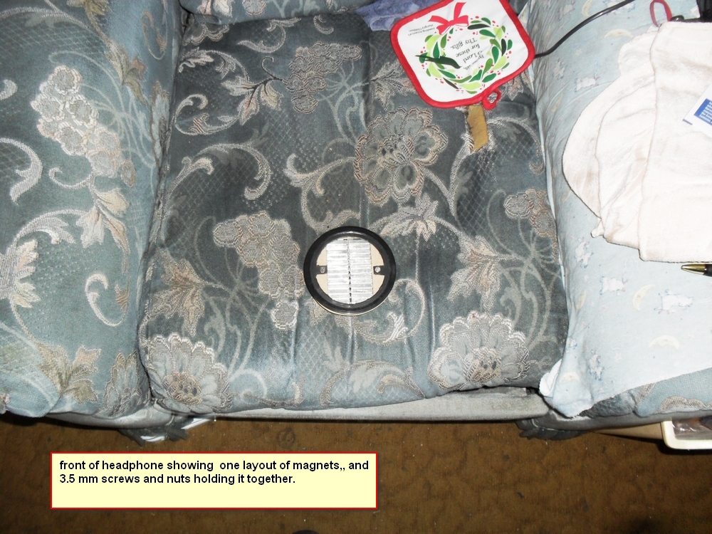

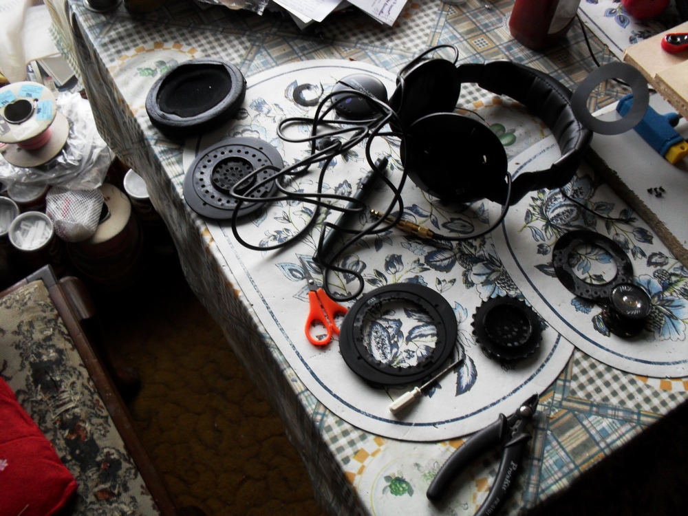

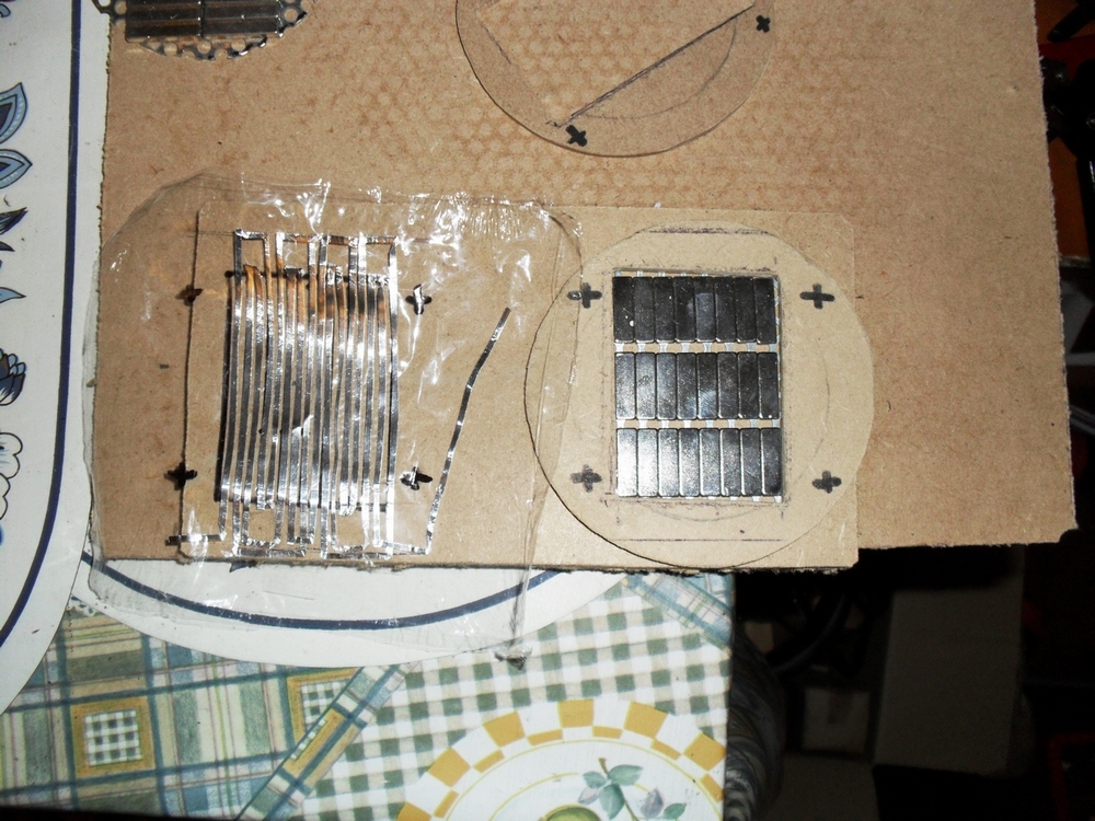

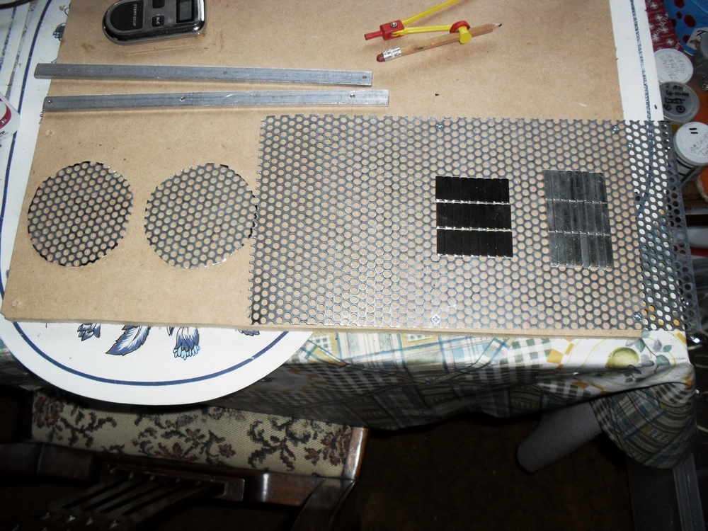

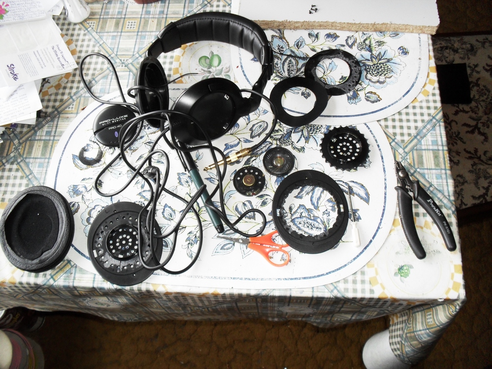

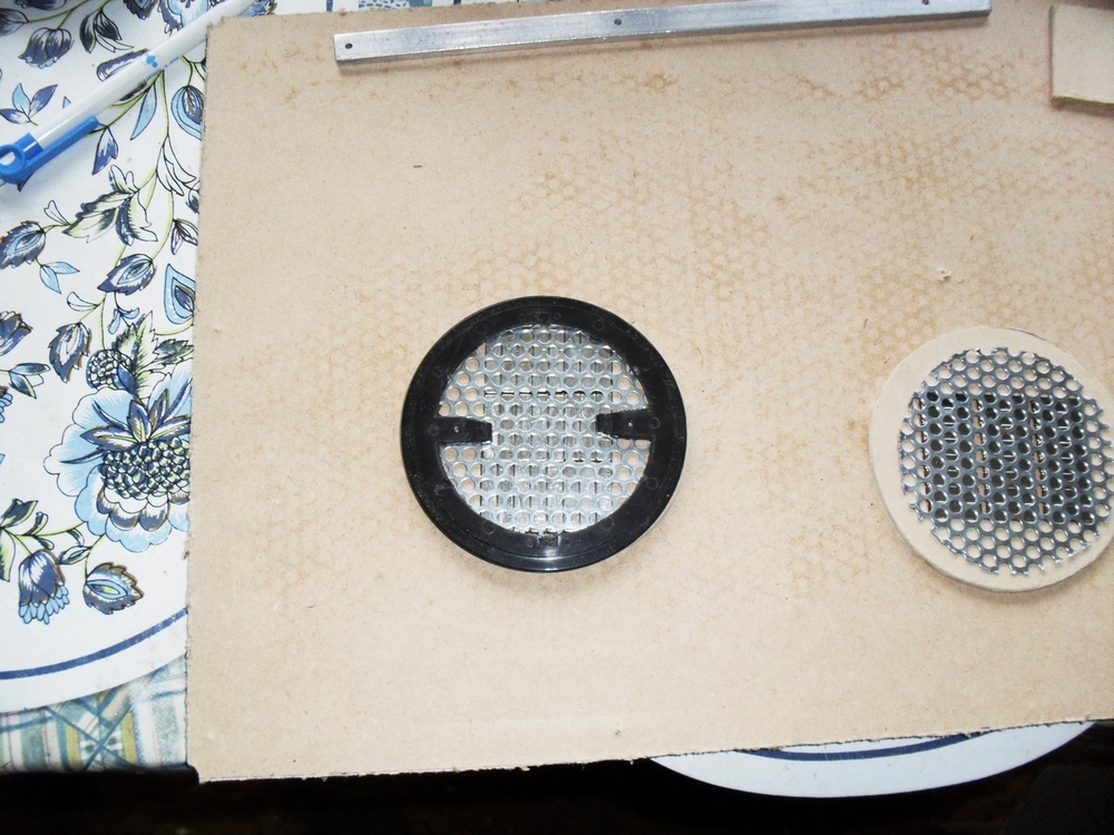

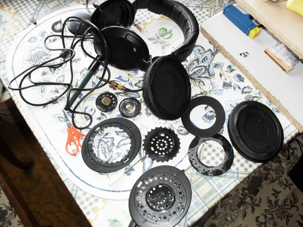

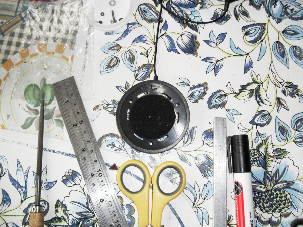

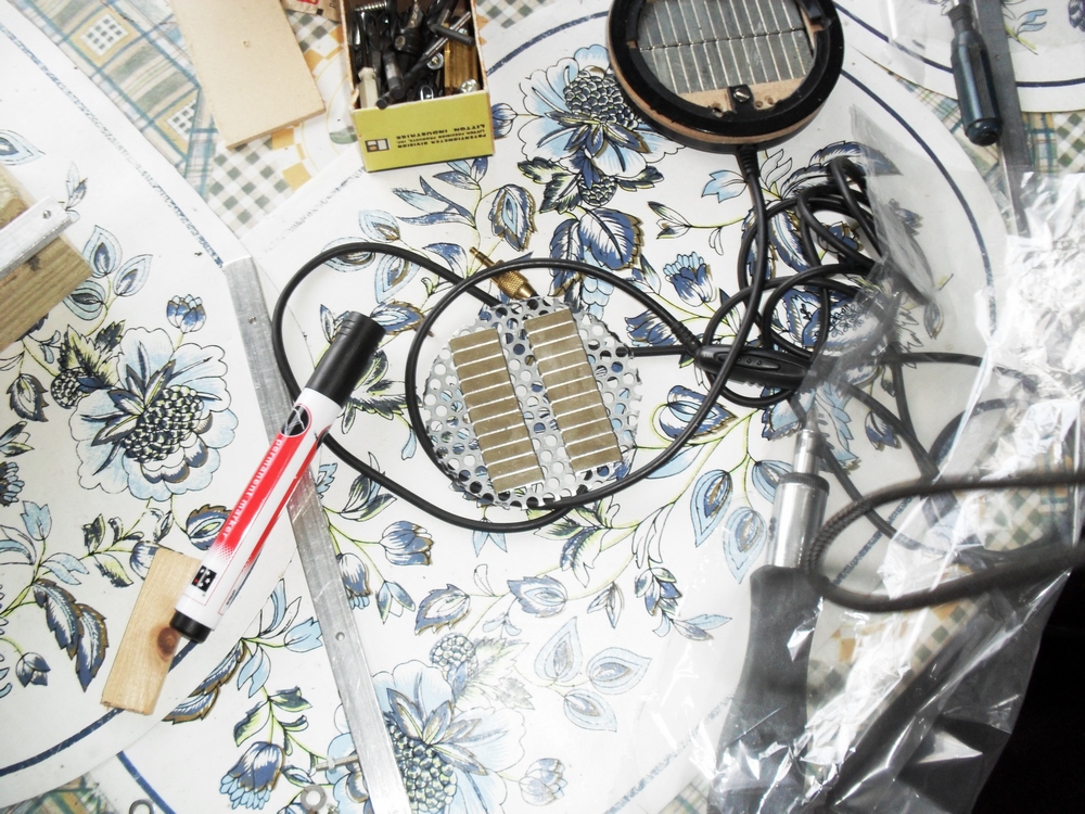

Why don't you do what I did, buy 2 cheap large headphones , strip them and build small diaphragm, and use small neos, and 2.25 mm wide aluminium foil, fix it all together total weight 405 grams. They sound wonderful. Can listen to music all day, and watch tele with them on. No problem. Everything sounds so natural it is unbelievable. Am buying more cheap headphones to convert.!!
James: I'm very interested in what you did there. What is the aluminum foil for exactly? Would you be able to post pictures?

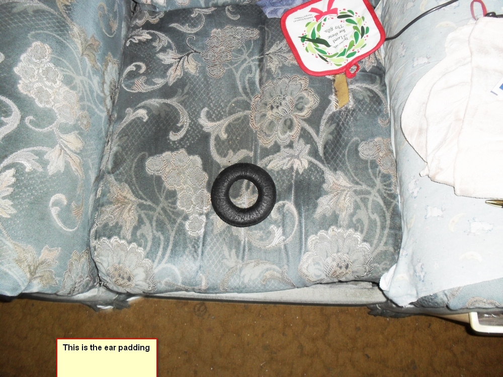

Rem: I've been experimenting with cup designs-- fitting the neos to my ears at the perfect angle-- by building up this stuff I bought at my hardware store called "sponge rubber weatherstrip." I've found with this stuff, (unlike the leather pads that came with the monoprice cans) that a certain balance can be achieved between placement and band extension which makes them acceptably wearable, even bordering on comfortable, despite their weight. When using the leather pads, I would often find sharp pains on the top of my head in the exact location the headband was resting... hmm...
Edit: Sponge rubber weatherstripping is identical to what some people use to seal speakers in boxes as apposed to that grey glue stuff. I bought some from PE. From what I can tell it is 100% identical, but can be had for less at a local hardware store.

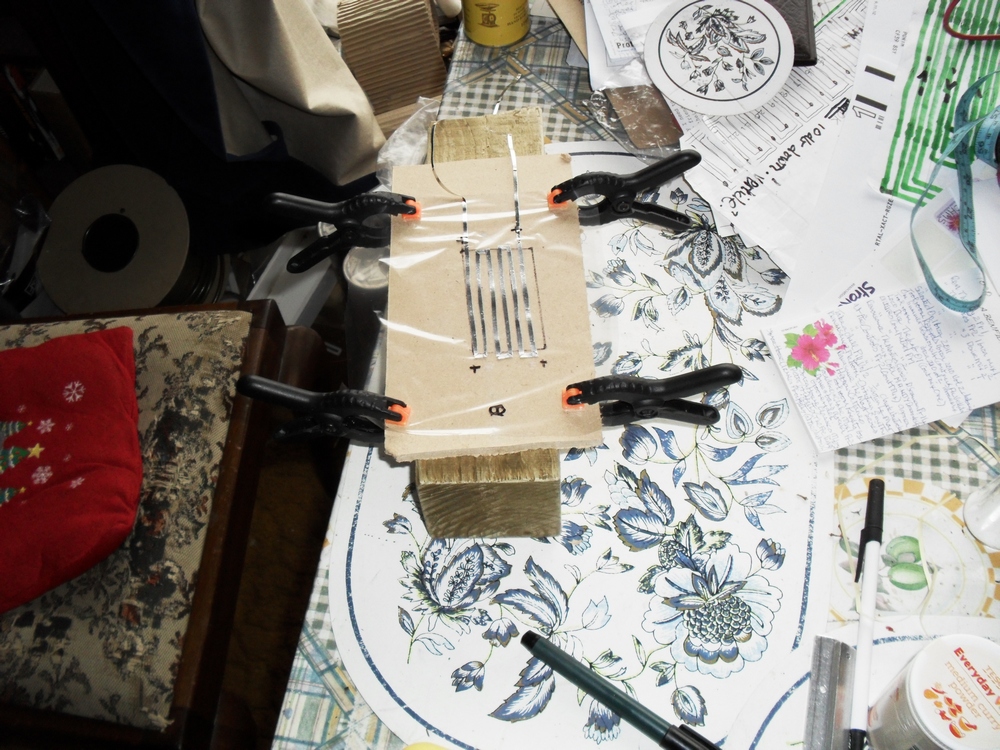

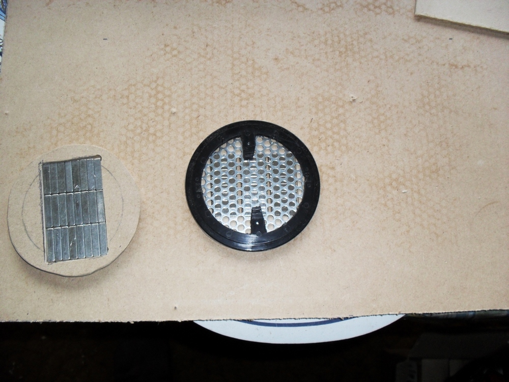

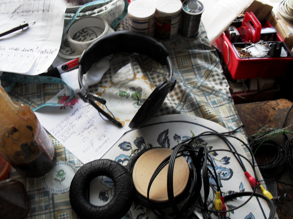

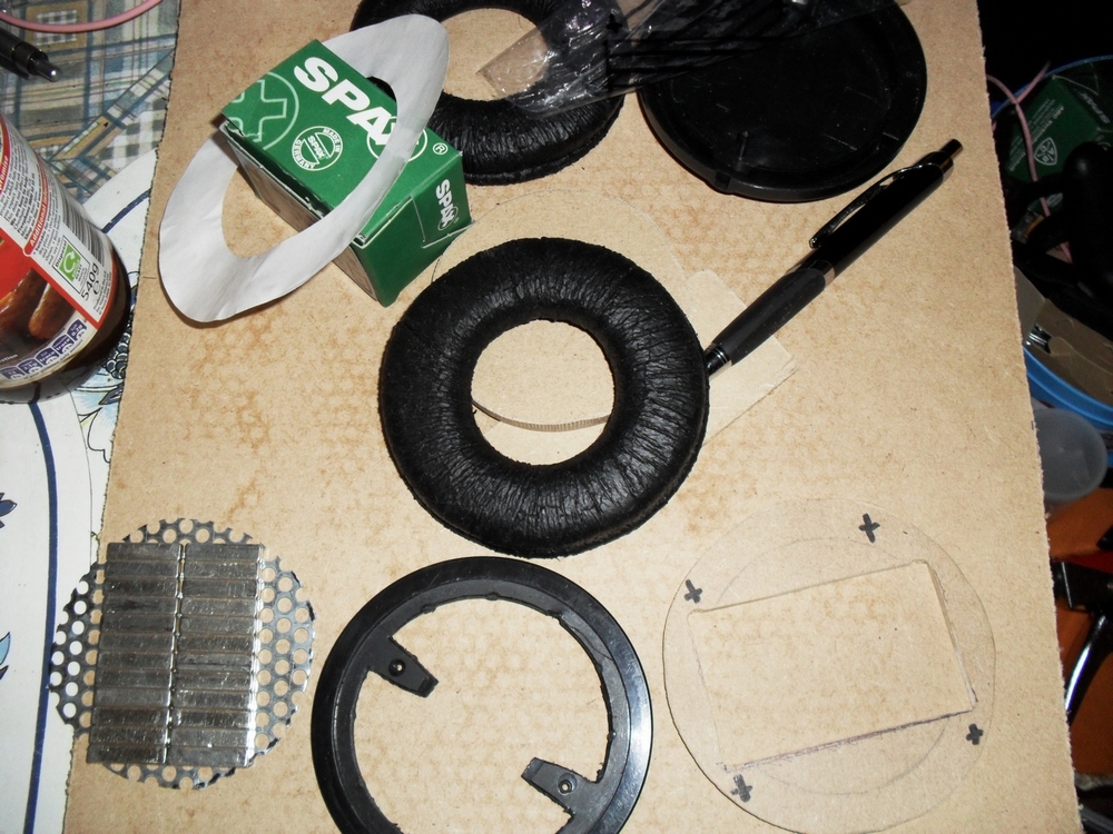

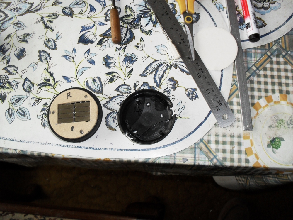

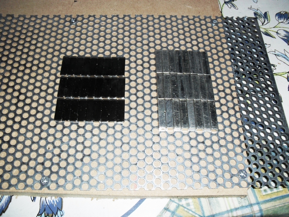

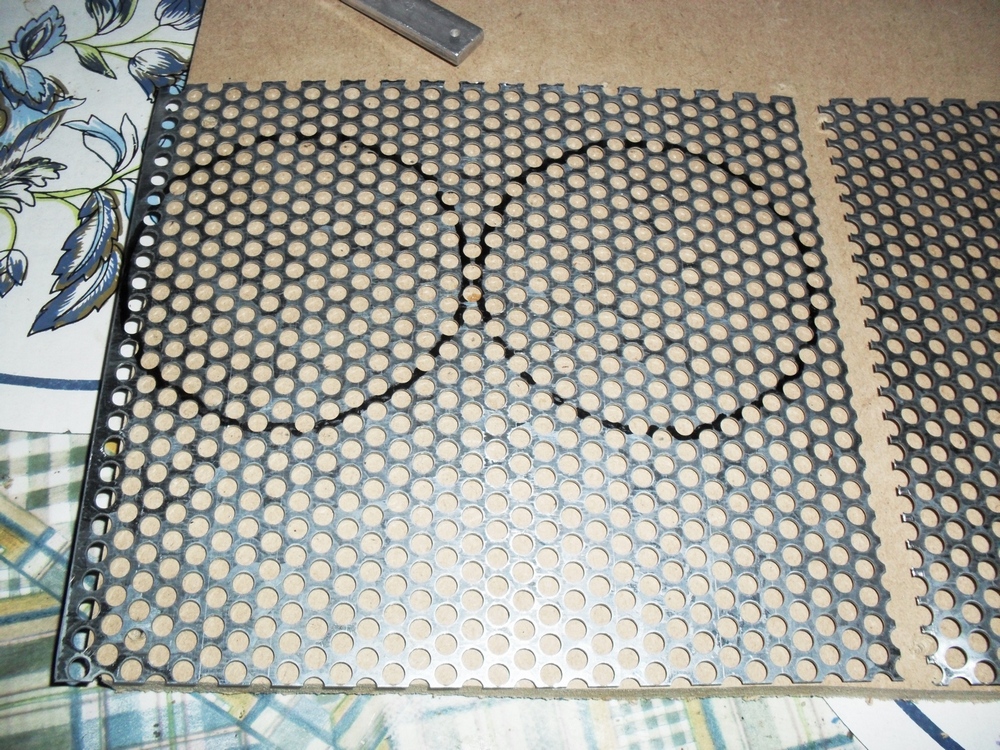

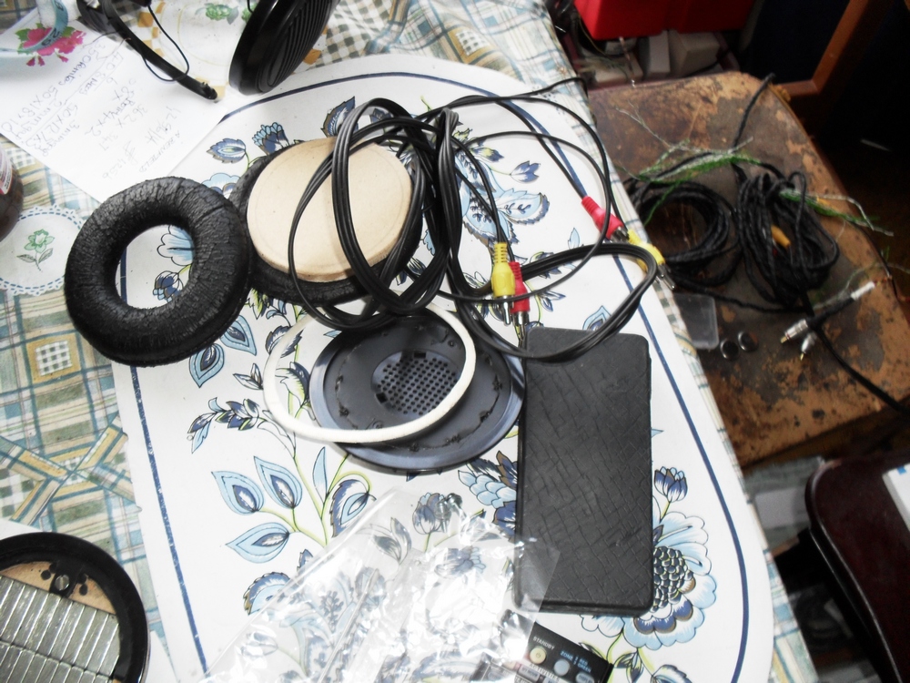

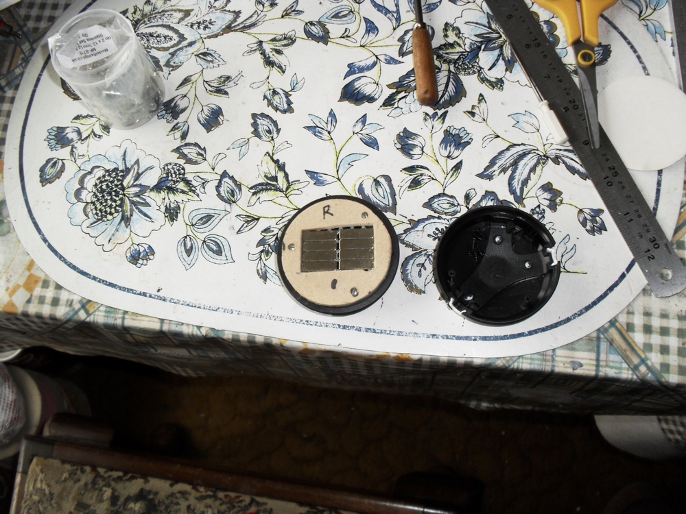

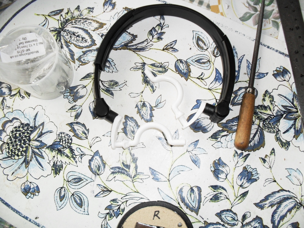

pictures of my headphone rebuilds.
some pics of my headphone rebuilds using perforated sheet, foil ,mdf, and ingenuity. Great sound well worth the effort.

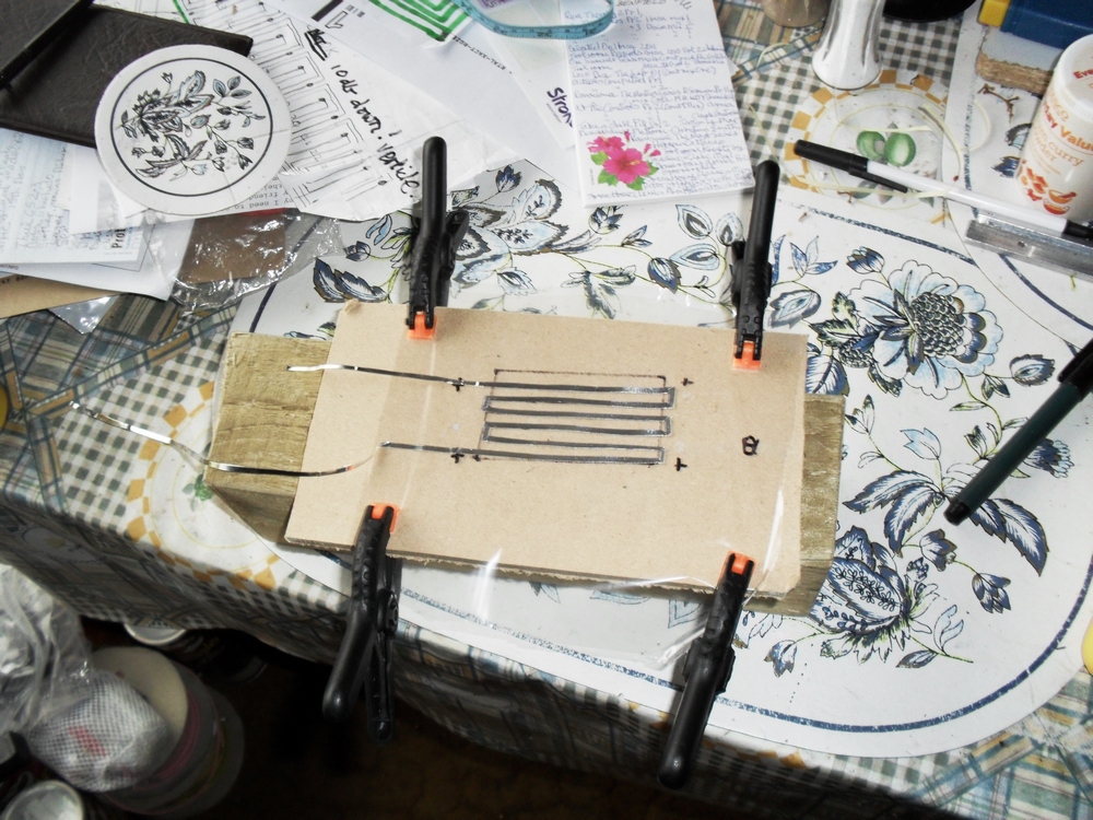

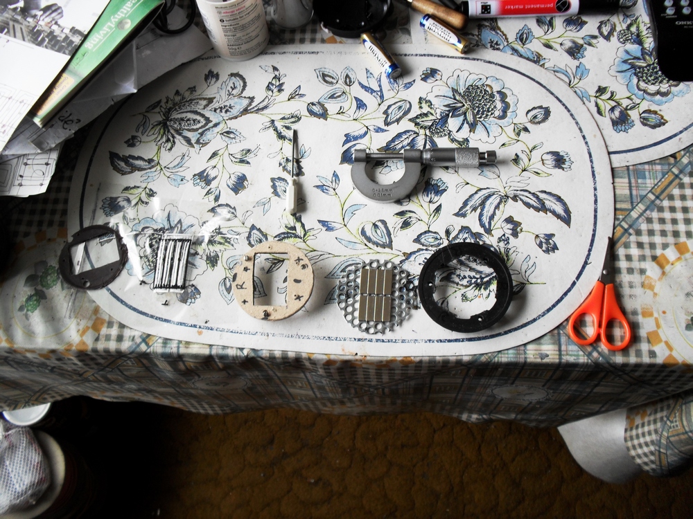

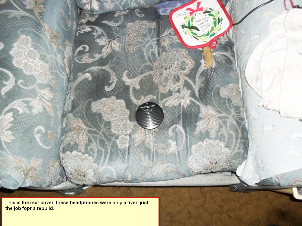

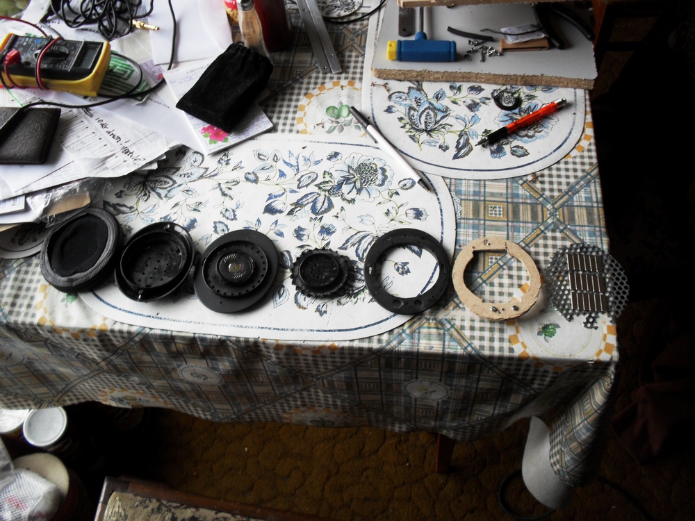

some more pics
Showing the evolving headphone, thro' it's various stages.

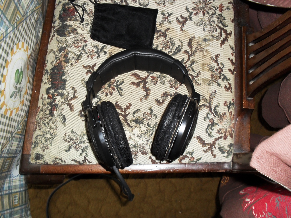

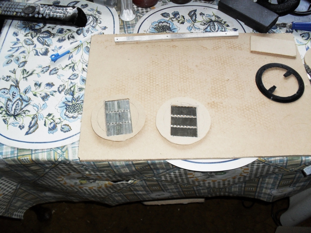

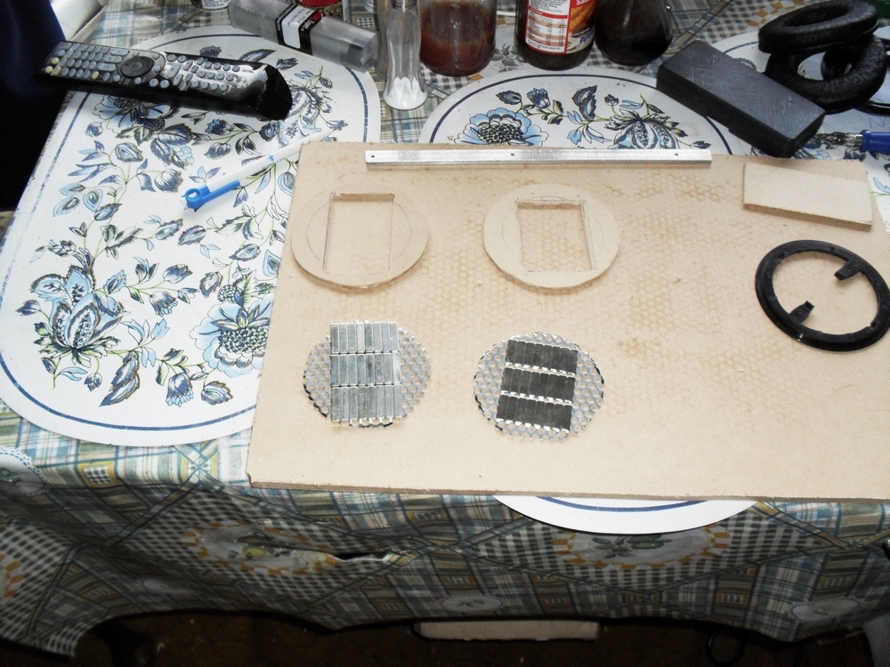

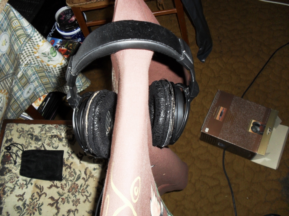

more pics
A continuation of the process of the top of my head, depending on mistakes etc.

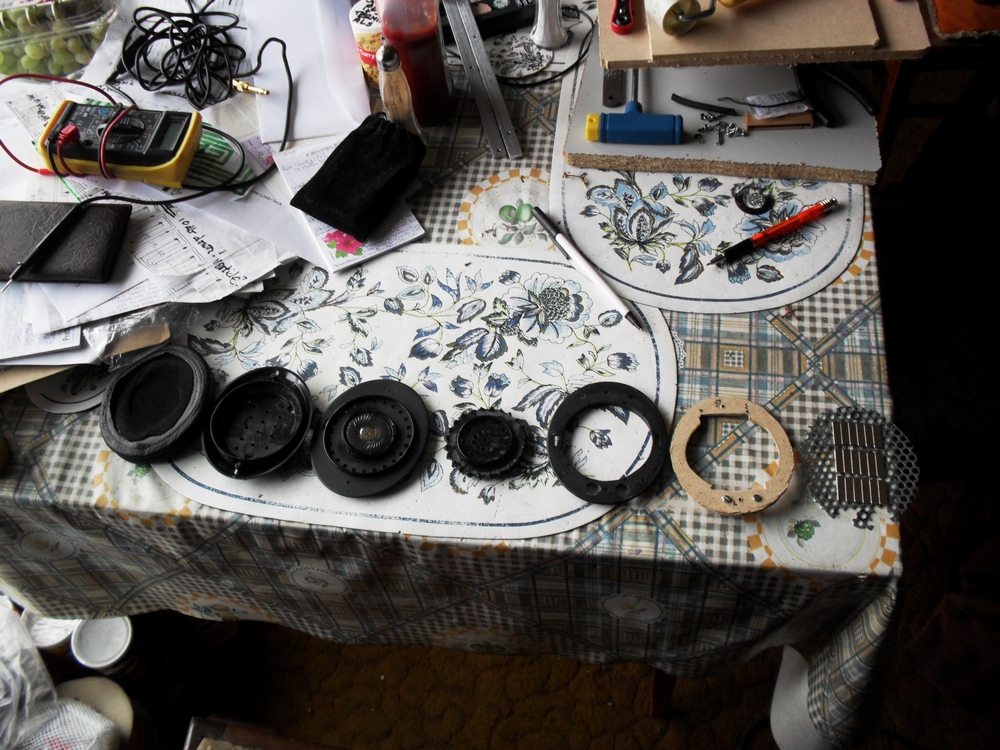

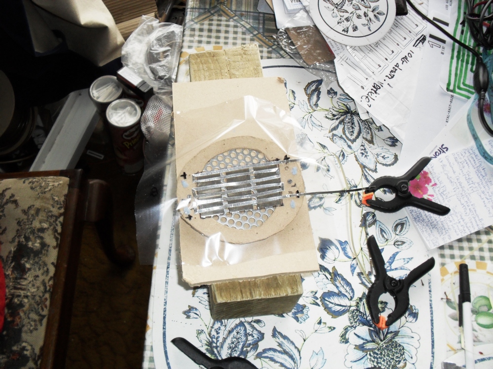

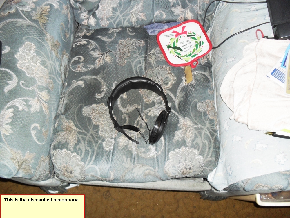

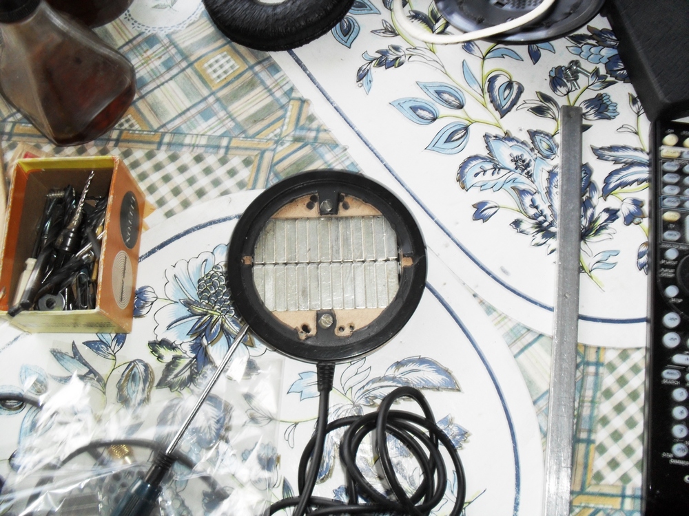

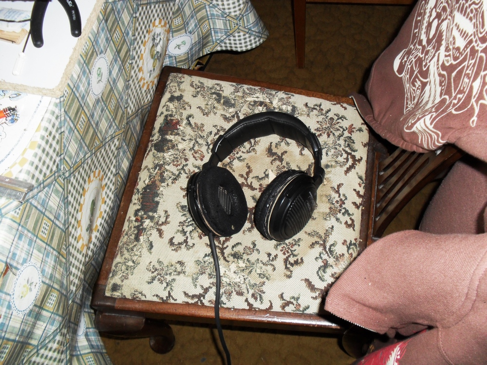

last few pics
Have other cheap headphones on the way for more rebuilds, keep the old brain ticking over.

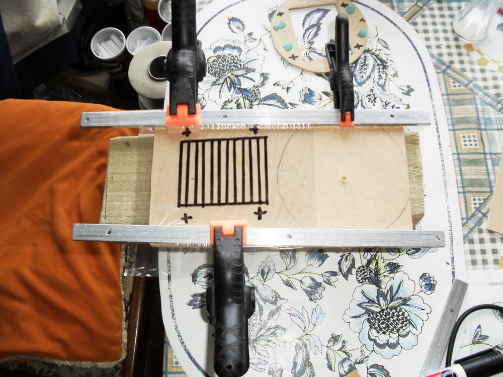

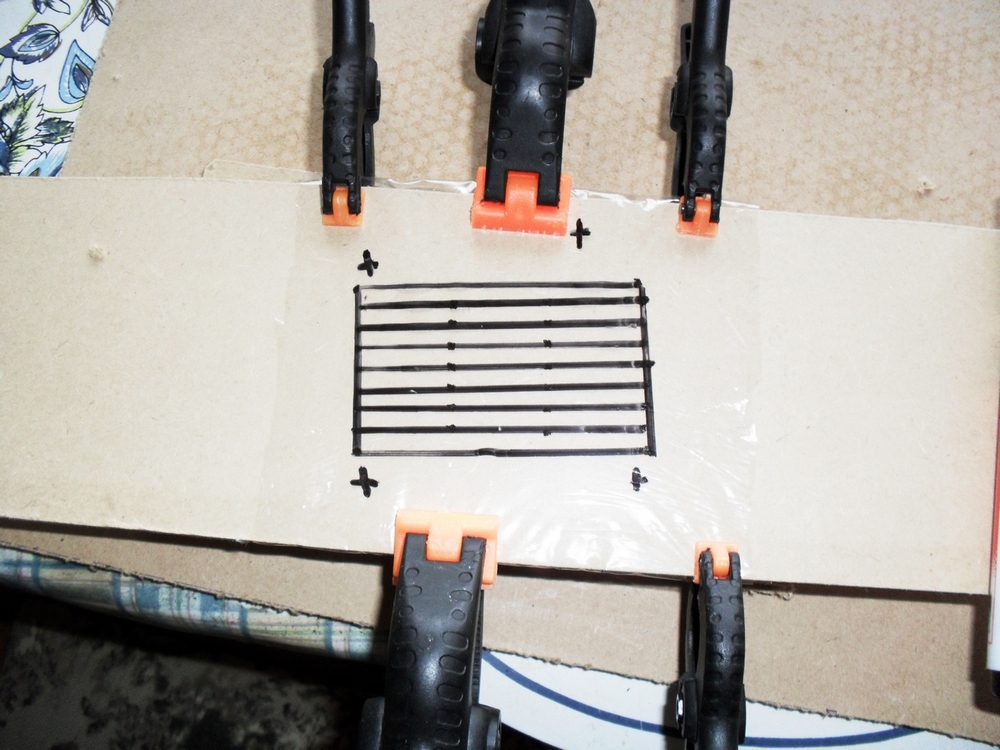

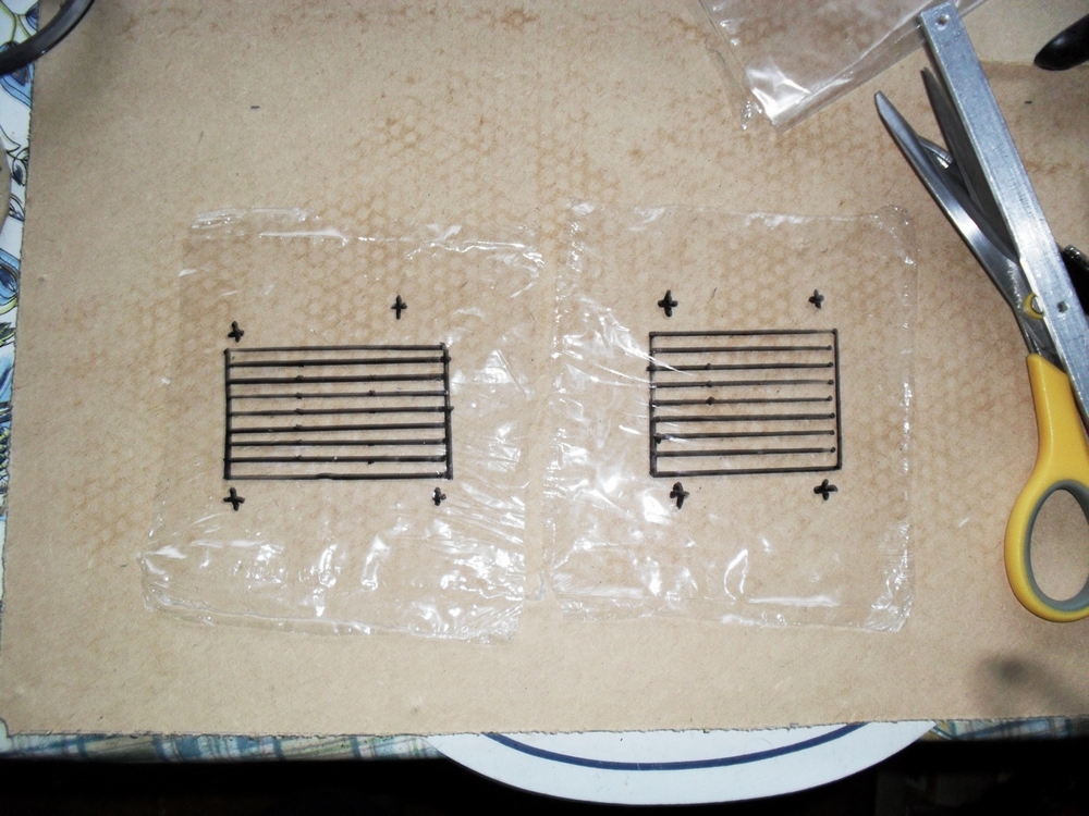

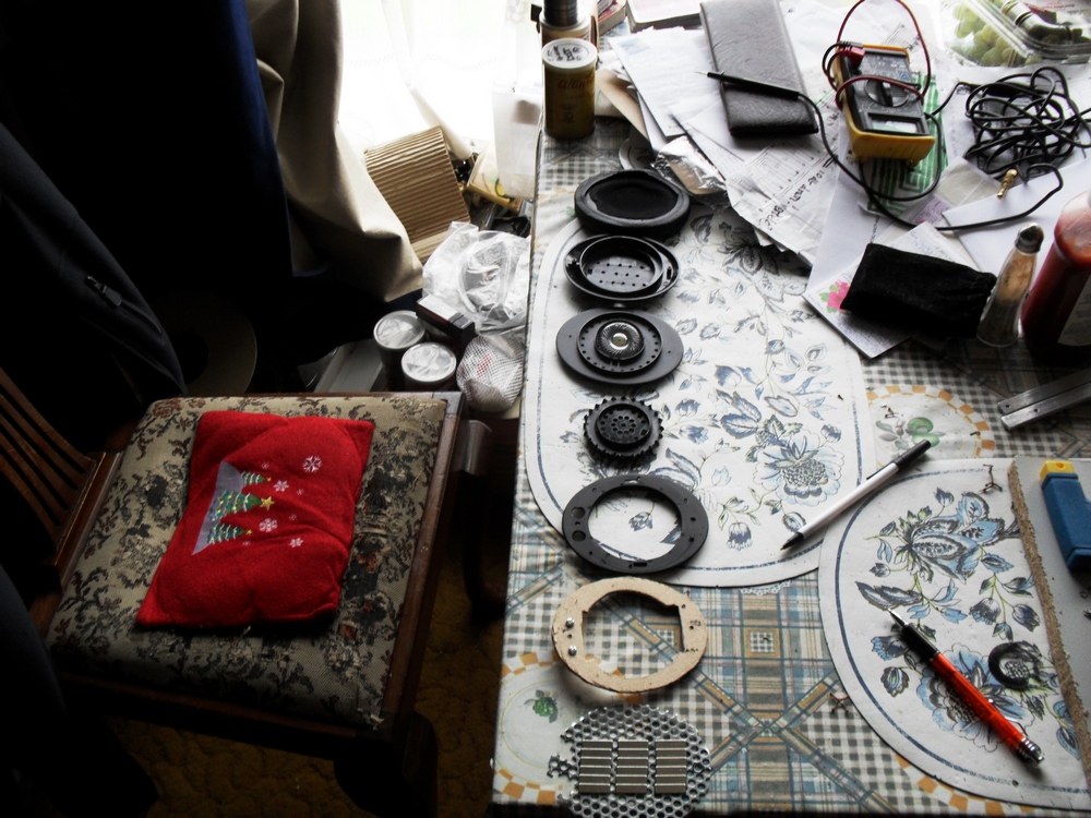

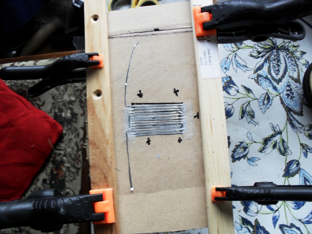

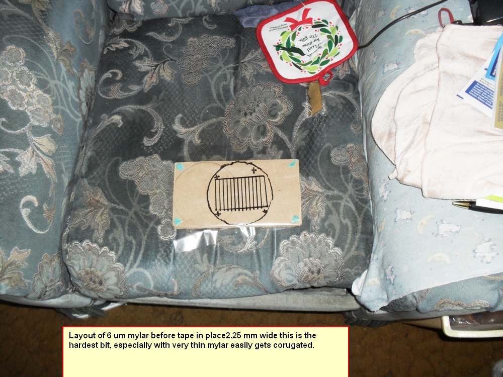

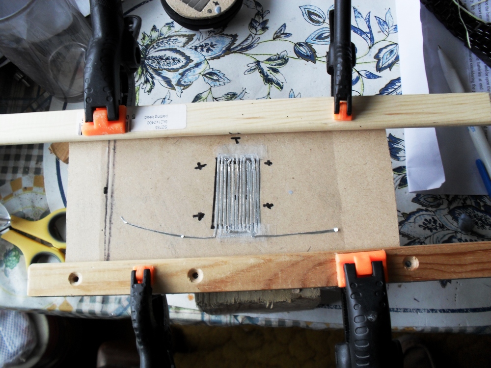

Have started on next rebuild smaller than these, so maybe too difficult to finish we shall see he said more in hope than anger.! I think I have bigger ones coming we shall see, today or tomorrow? I don't do a double diaphragm at the moment, a single one is hard enough as the ease of the layout depends on what you receive in your cheap headphone carcass! I suppose I am very lucky in the amount of time I have being retired, still one must use ones time left!!

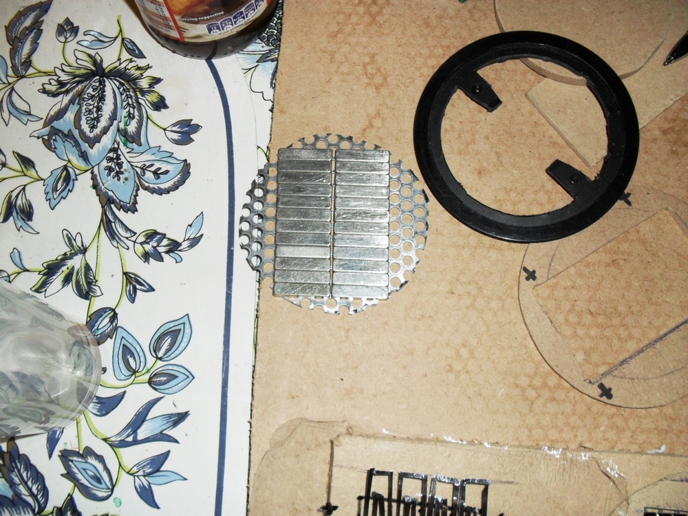

the 2.2 mm was cut by my hand, right down from 9 mm, it is self adhesive and is in one continuous piece. Not a good idea in separate strips!! To get more sensitivity I may cut the 3 mm tape in half and use that in the epsilon type layout. This increases the impedance and the sensitivity, killing 2 birds with one stone.
Impressive job James! I like your work. If I'm not mistaken, you are creating your own planer driver. What type of frequency response are you getting? At first look I thought you may had taken the Neo 3s apart. Lol. I was shocked. But building your own is even grander.

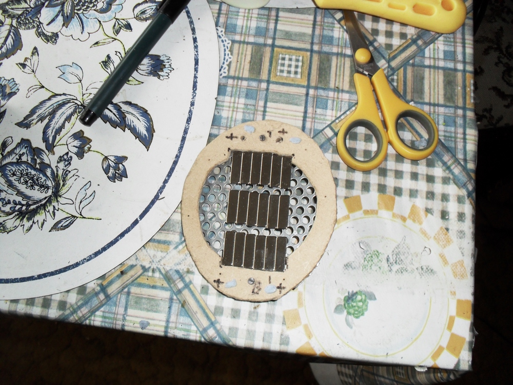

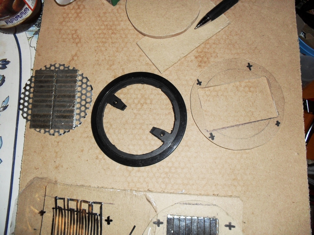

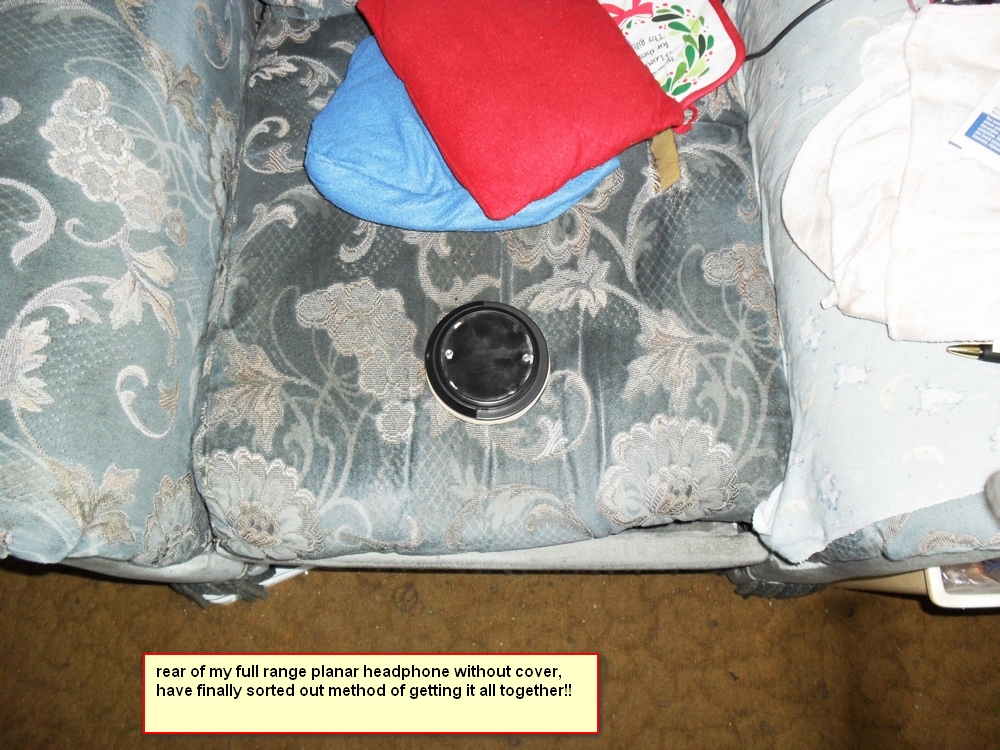

Thank you, I do design all my own diaphragms, I am rebuilding a smaller headphone carcass at the moment, not much room in this one for all the bits. May have to cut 3 mm tape in half and use my version of the epsilon layout, to get enough sensitivity and impedance. We shall see, fingers crossed. I have quite a bit of practice at cutting tape in half but not down to 1.5 mm, yet anyway. Should be alright, don't need much anyway, just a few inches. Will have to find a new way of fixing the diaphragm in position because of the extra bits inside the headphone. I didn't know this before I bought them. Have several rebuilds. Only hope they are easier.
GOT THIS FAR
Have fixed the diaphragm holder in position, this is the easy bit. Got to make diaphragm and fit it , will use 1.5 mm alu tape cut by hand. Wish me luck, I'll need it.
