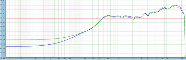

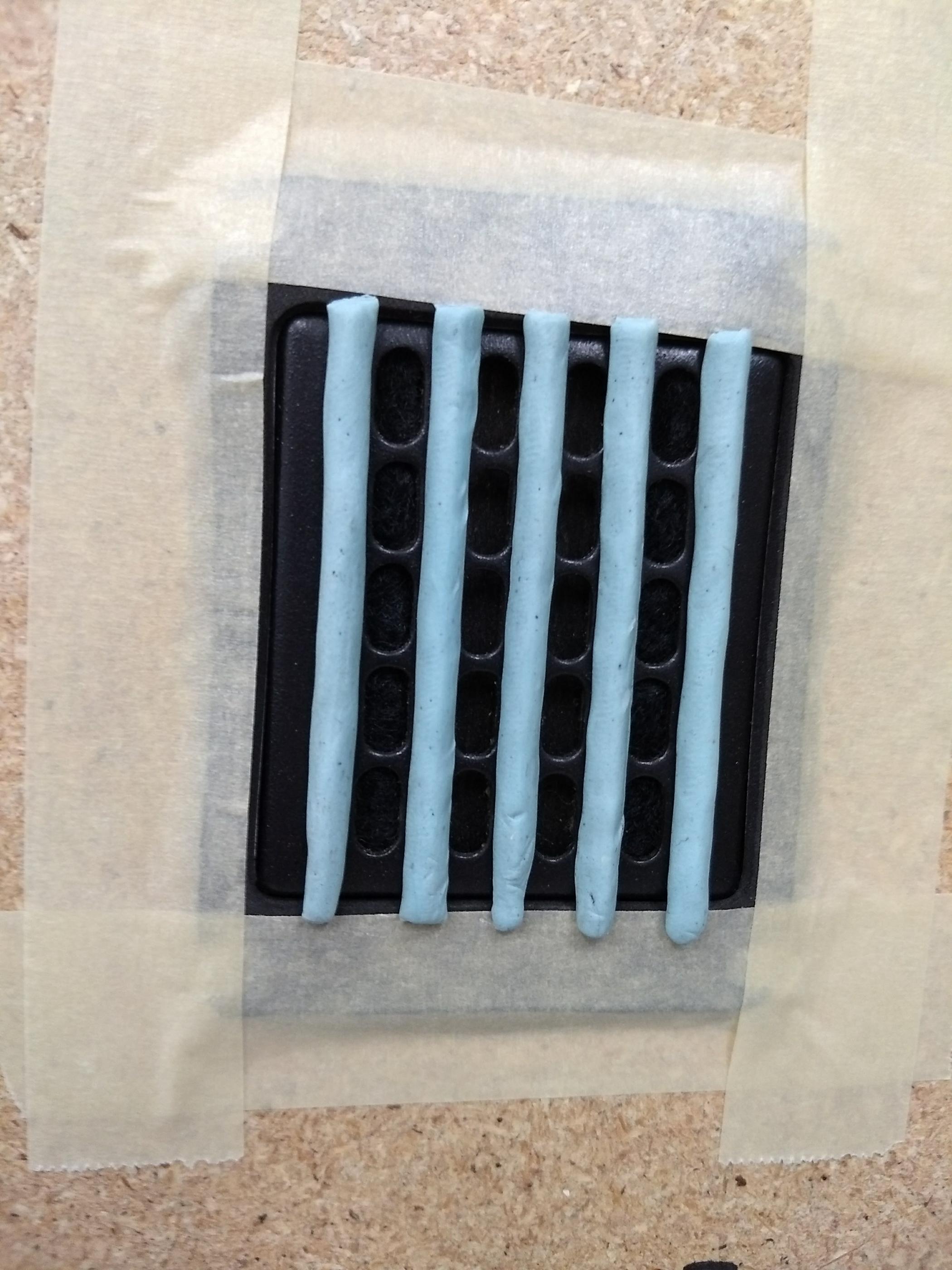

I was excited by the improved frequency response measurements for the BG3 posted here. I do not have a 3D printer available but I devised a way to roll mounting putty into a precise 5mm tube and applied it to the BG3. Though not as perfect as a 3D printer it may confirm a proof of concept. Unfortunately my measurements do not show a significant improvement in frequency response. The green curve is with the putty treatment as pictured.

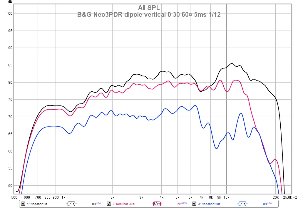

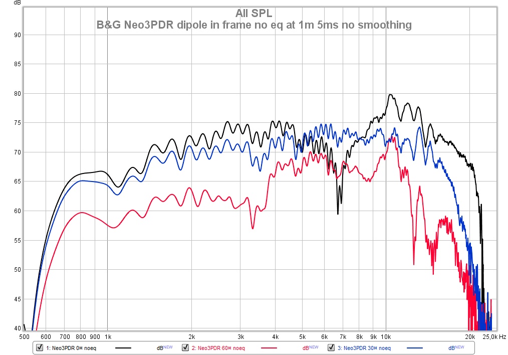

How was that taken - distance, IR gating, smoothing?
Looks like too smoothed or too near to show ripples caused by interferences...
I would like to see 5ms gated, unsmoothed response at 0-60¤ angles horizontally. Distance 0.6-1m (2-3') or at various distances. You can measure the whole speaker with xo, but then we need to know where and what type xo is
Ok here are my measurements of it at 1m in a narrow dipole frame, 5ms no smoothing and with 1/12 smoothing. Horizontal angles 0, 30 and 60¤
Obviously the minimal frame around the driver is making most of ripples, general shape is more standard. I have not measured it at all in a baffle!
In my AINOgradients the Neo3 is sideways, then horizontal directivity matches the general dipole pattern better. Notice the directivity is constant below3,5kHz which means true dipoel pattern. I cross it with Neo8 around 4kHz

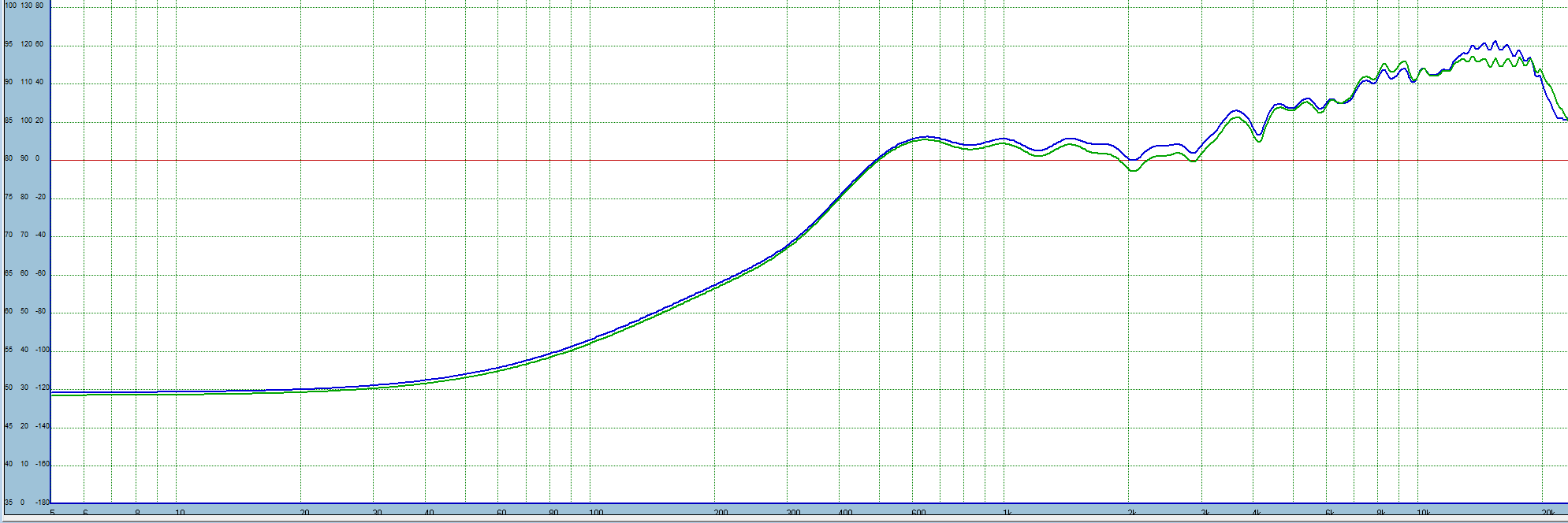

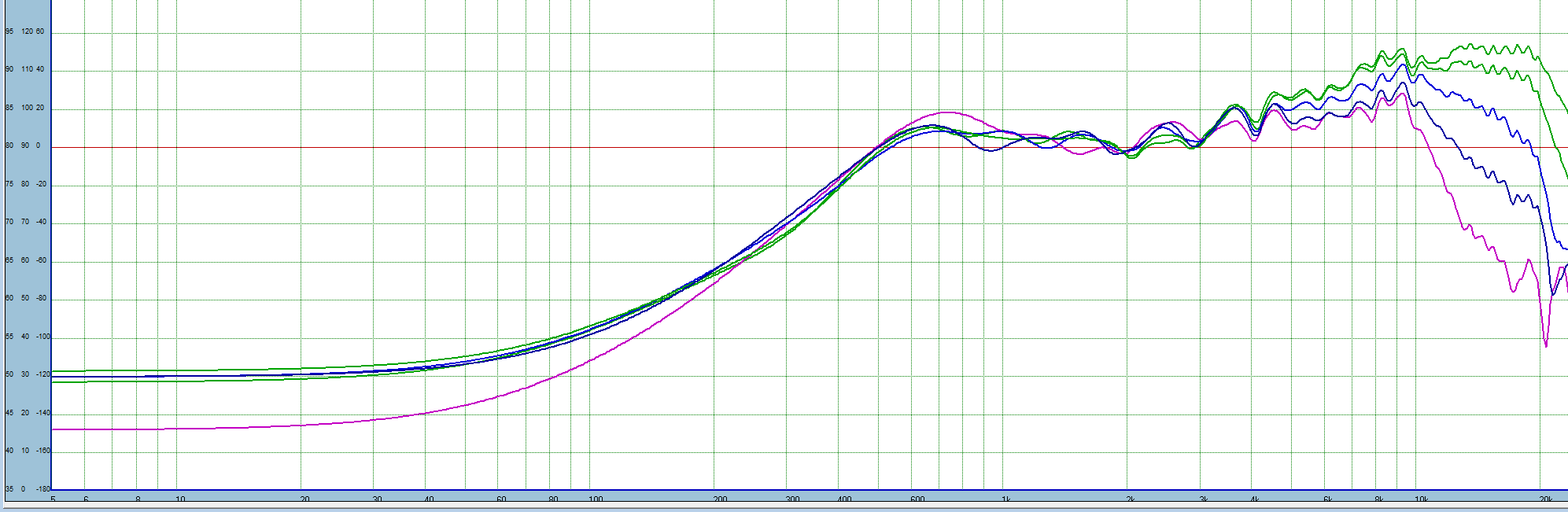

Here is a comparison of the BG3_PDR with and without the putty phase plugs. Green curve is with the treatment. I don't see this as an improvement. Perhaps a 3D printed version would improve things but I wouldn't get my hopes up. I wish the OP would comment. His measurement seems too good to be true.
Measured at 1 meter, on axis on a 4 foot square flat baffle, open back with the treatment on the back as well. Measurement is gated 5ms with no smoothing.
Second image is with treatment off axis 0,15,30,45, and 60 degrees.

... I don't see this as an improvement....Measured at 1 meter
You might try near field measurement with mic placed ~1cm from the front plate.
I'm pretty sure the OP measurements were near field(dipole with no baffle) and it is possible the improvement shown had more to do with mic placement than the modification. The disappearance of the large notch at 3kHz seems unlikely to have come from the modification considering the dimensions involved.
Looking at Figure 8 in the patent mentioned in Post#22 it only really shows changes >7kHz...much like you.
Then again, the patent was intended for use in headphone drivers, so maybe larger differences are seen/heard near field.
Quite a notch at 7K! Is that due to the narrow baffle?
Sorry but I don't remember exactly in what kind of frame the driver was mounted, or was is free. That looks similar to AINOgradient which has 8mm thick plywood baffle, driver mounted on the backside. The frontside opening has chamfered edges but it makes some interferences. It is propably the dipole null, but with frame thickness adding some interferences.

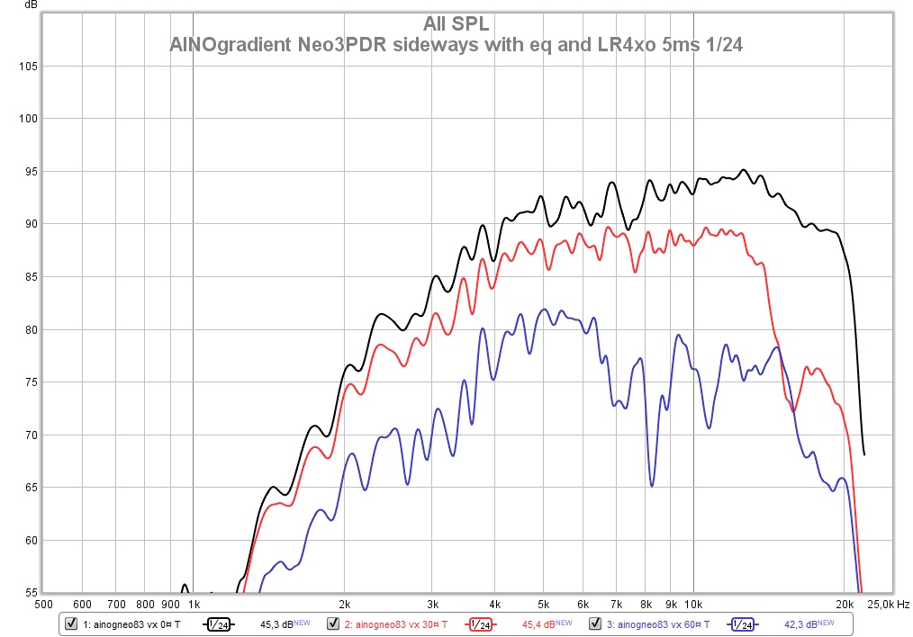

This is almost two meters distance, in AINO baffle outdoors, 5ms 1/24 smoothing on-axis. Neo3PDR sideways in the frame. It can be seen in some of my other measurements in the baffle and I use some eq because it affects room response (long gating) too!
It always takes some time and several different measurements to find out what is causing the deviations that we see! The lower the frequency, the more difficult it is to measure! And with high frequency, very small changes can make a difference!
