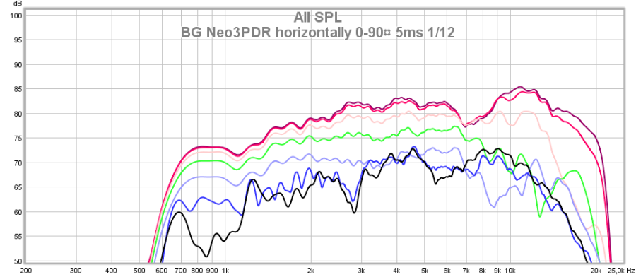

BG NEO 3 FR optimization
I just noticed this thread - I must try that trick too! I don't have access to 3D printing, so i takes some time to realize...
These measurements were at 1,5 meters and driver open back, turned 90¤ sideways (vertical directivity)

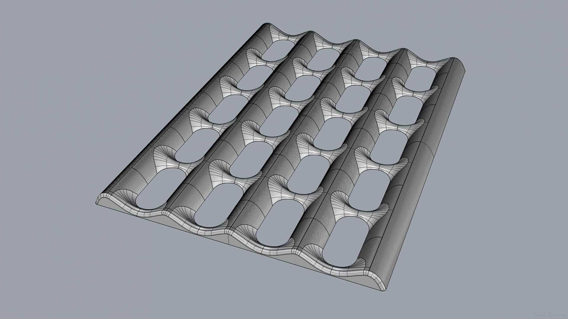

If simple half-rounds help that much I wonder what full waveguides at each individual opening would do? Like this:
attachment.php
attachment.php
All the curves are catenary in this 3D model. Should be easy enough to get 3D printed somewhere. I did the layout work from an image, but I have a pair of older Neo3-PDR tweeters in storage that I could get accurate measurements from using calipers.
attachment.php
653502d1514543510-bg-neo-3-fr-optimization-catenary_waveguide_01-rh-jpg

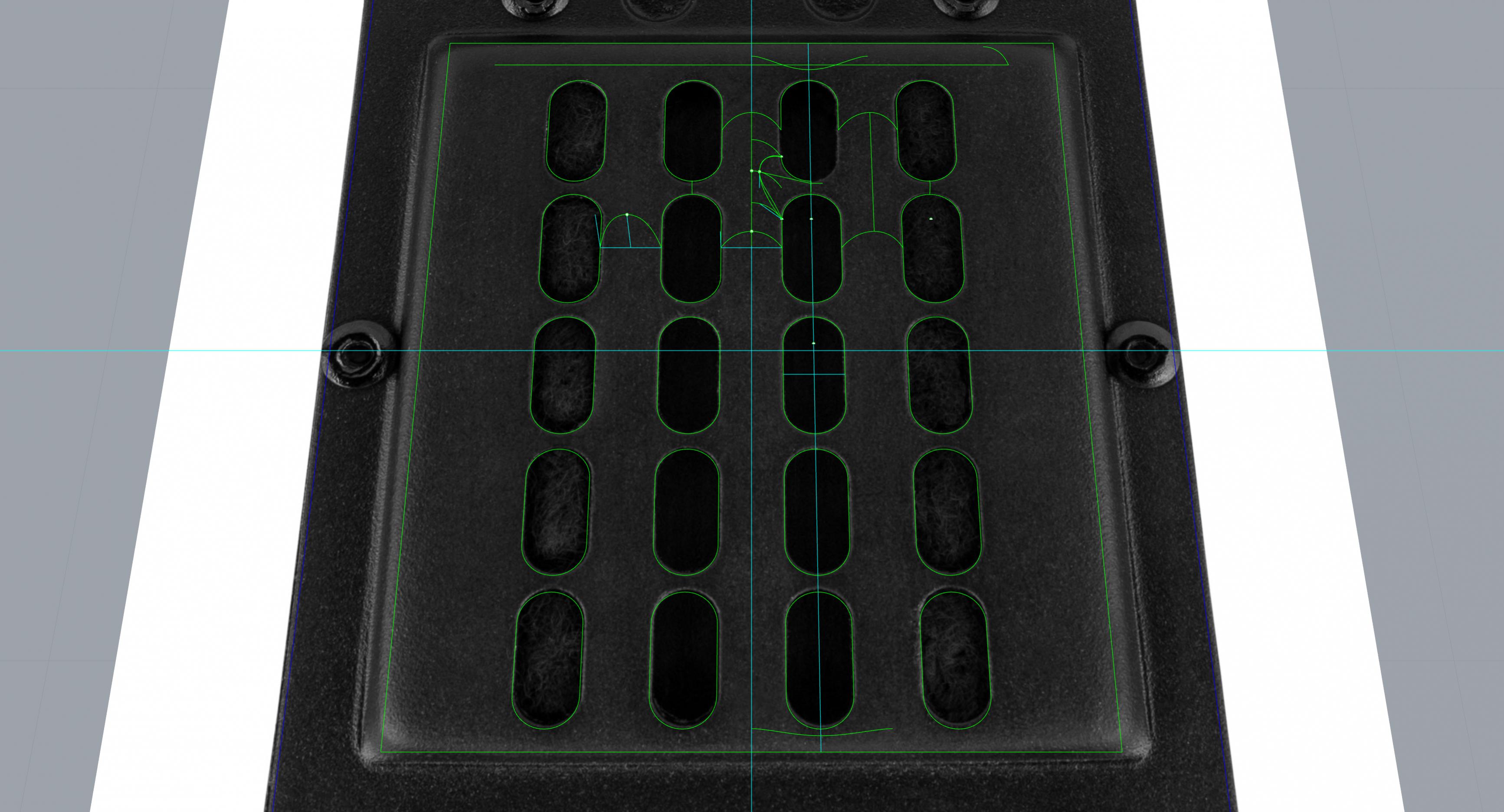

However, my current model is not accurate enough to 3D print since I merely worked on top of a picture I found:
attachment.php
I can pretty much guarantee that it won't line up with a real Neo3. So I'm going to head over to storage today and look for my tweeters. Then I can measure them properly with calipers and make a new model. When it's done I'll post it on my GrabCAD profile so that anyone can download it. :)

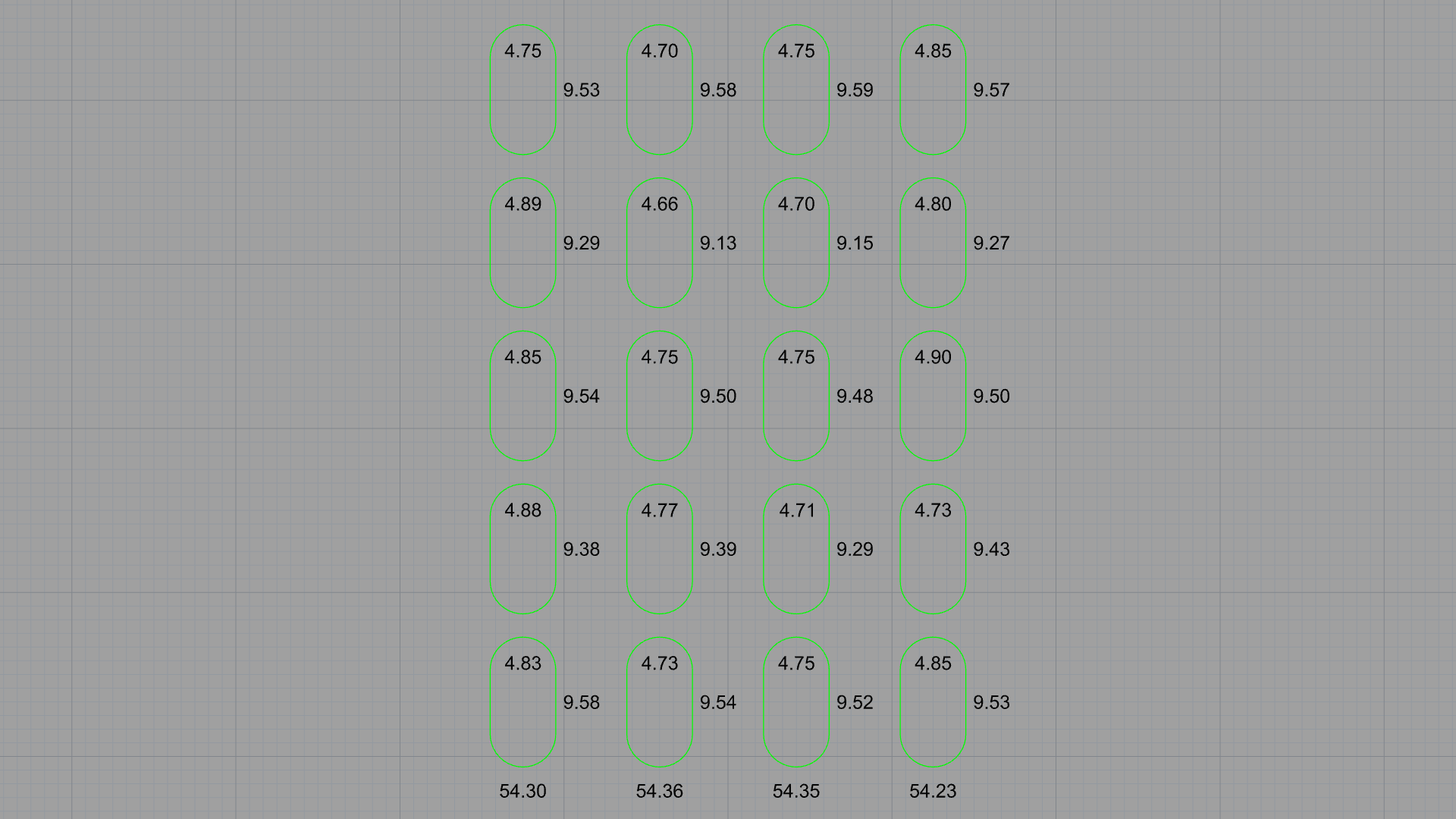

Doing the actual modeling ain't too bad at all. It's the taking careful measurements of every single detail that takes time. So yeah, if you provided measurements for the Neo8 I could make a model for it as well pretty quickly.

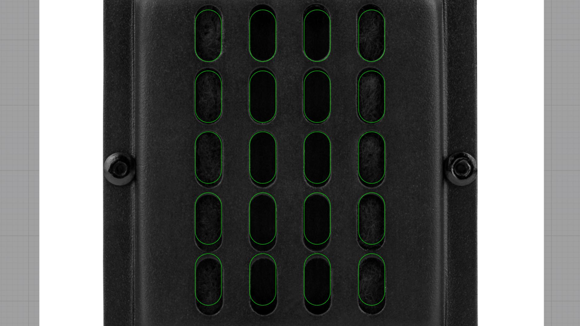

Speaking of which I finally got my Neo3 tweeters and calipers from storage today. Had to deal with automotive trouble the past few days. :/
Worse yet, the windows are not in a neat grid either. They deviate substantially from where they should be centered, which is a much bigger issue. So the perfectly spaced waveguide model will never match up with the real world tweeters due to the terrible punching tolerances.
Further, when I scaled the image from Parts Express to the measured width of my tweeter I get this:
attachment.php
So I'm not sure if the newer tweeters have the same height for the windows? I ordered my Neo3 pair back in 2004.
