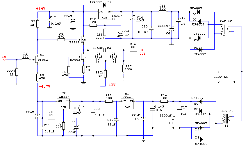

1. Do we need the single BF862 in gain stage to be matching with the one in the other channel of the stereo preamp?
2. For getting 4 matched BF862 for the buffer stage, approx how many BF862s we need to procure and do test matching?
3. Why are we using asymmetric power supply here ie positive and negative rails of different voltages, unlike more commonly used +/-10v or +/-12v (where both +ive and -ive rails have same voltage with opposite polarity)?
1. Yes
2. In 500 pcs. of BF862 I have bought at Mouser almost all have the Idss in range of 13-14mA so matches were abundant in that quantity (all JFETs delivered to me were on the same production stripe). Others have different experiences.
3. Already explained - please read the thread from the beginning. Actually, you can do it without negative rail - see post #346. The price to be payed is introduction of input coupling cap.

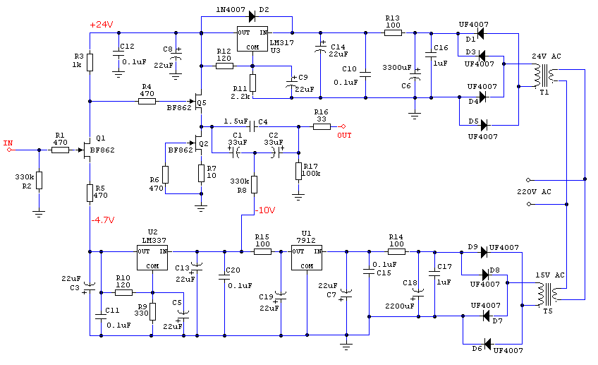

sismik,
there is an easier way to make this pre (see attached schematic).
That way we don't need the negative PS anymore and the gain is easily adjusted by changing only the value of R3 (in reasonable range: from 100R for 17dB gain to 470R for 6dB gain).
Of course, this demands the use of an input cap (C1) but since it's of small value (47-100 nF) it's easy to fit the good one (WIMA MKP10 or whatever one likes).
Can we increase the gain to around 28-30db to use with unity gain current buffers like pass F4 or Mofu? Do we need to increase the supply voltage to higher level and cascode the gain BF862 FET to keep safe from higher supply voltage?

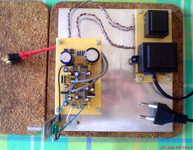

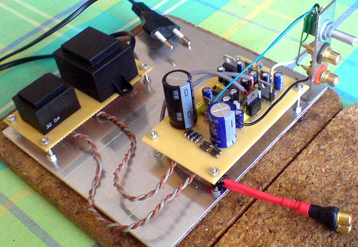

when BF862 was discontinued we had a big group bye. What to do with >150 BF862 in stock leads me to Juma's 862 Pre
Some years ago I made these PCBs
To lazy to match all the bf862 delayed the project until last week
Fed by a Jung Didden SperReg. First listening are very promising.
Thanks for sharing this design Juma. If you are still located in Berlin, feel free to come by.
