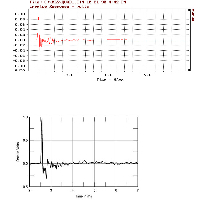

Two Measurements, Two Results
Here's my MLSSA Quad ESL57 measurement and the one posted upstream. This probably shows the value of the ultralow diffraction Spurlock Stand - much cleaner decay performance. I think this demonstrates the difference that measurement protocol can make - absence of ringing in the lowpass filtering (analog or digital, software or hardware), absence of peaking in the measurement microphone, and a low-diffraction stand. If you can't see it in the measurement system, what chance do you have of fixing it in the loudspeaker?
Then again, if the other measurement is a Quad ESL63, that's a sad comment on how much it went downhill. But I suspect measurement artifacts instead.
Don't know if it has hardware issues, its from Stereophile. Its ESL63 for sure. Ii just saw that it went visually negative also. ESL63 is widely regarded as time coherent and fast. I posted it to help stimulate commenting on the impulse questions.

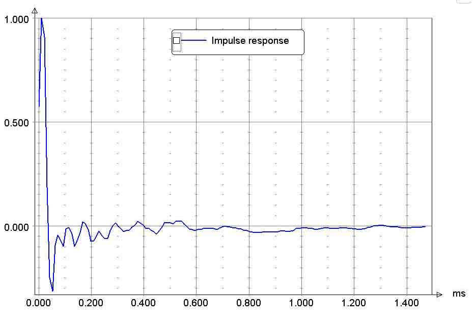

mige0 said:
Hi
Very clean impulse response for three speakers working together in the plot of post #1898 .
Could we have a x-axes scale please?
Greetings
Michael
That plot, as I recall, was the first 3 msec of the impulse. Nothing much to see after that. Here is the reproduction of a 2k Hz square wave by that speaker.

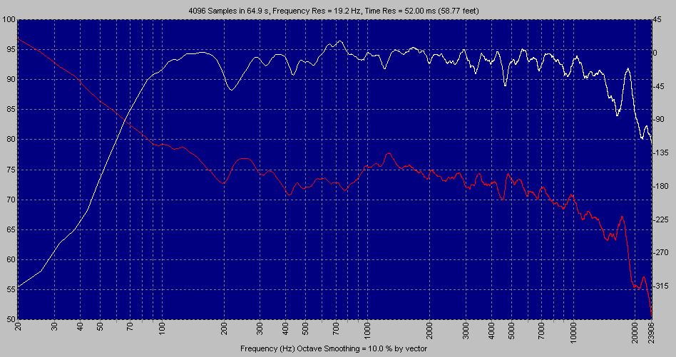

“If either Dr. Geddes or Tom have more recent impulse data, many of the readers (including me) would love to see it. Impulse data for horns and waveguides seems very hard to come by - you sure don't see it on the prosound sites, that's for sure - all those guys do are those 1/3 octave smoothed "happy graphs".”
Well, some measurements of a one I’m working on now are as “up to date” as I can come up with. It is a larger speaker than the SH-50 with 9 drivers but is along the same line as the SH-50 where all the drivers combine coherently and radiate as one source in time and space.
I would comment that the impulse response, while conceptually appealing, is probably not that informative so far as having some clue as to what you need to fix to make it better.
Actually, the magnitude and phase is better and also describes the impulse response.
Lets start with the speaker’s magnitude and acoustic phase, the speaker I’m working on is shown in the first response.
Unlike the SH-50 which has a passive crossover, It is an active (self amplified) speaker which has DSP based linear phase crossovers and has a 80Hz high pass included.
As it has been raining here, I have been doing the preliminary alignment and “learning the processor”, measuring in my living room so this is not the final setup, that has to be outdoors. These were taken about a foot and half from the mouth to reduce room contamination, in real life, this is done on a tower at two meters. One-tenth octave smoothing applied to magnitude & phase display, 20Hz bandwidth as I recall.
So, if one takes the magnitude and phase and does an Inverse FFT operation on that measurement, one gets the curve below which is the Energy vs Time Curve.
This shows the radiated energy in log mag scale (like the amplitude curve) vs Time, with the concept that all the energy is sent at one time but it is delayed reaching the microphone and spread out by the speaker.
Anyway, if you remove the Log scale and use linear, one has the Magnitude vs Time curve.
The energy is in an “envelope” vs time, that energy has a frequency dependant phase shift and so, can be described in 3 dimensions, Time on one axis, the Real or “in phase” energy AND the imaginary part which is the reactive plane 90 degrees away.
A better picture than my display and better explanation than mine of the Heyser Spiral is here around page 40.
http://www.aes.org/sections/pnw/reference/tef_man.pdf
Anyway, the Real or resistive phase portion of the energy in linear scale is the “Impulse Response” and the reactive part is the Doublet response. Both describe a valid view of the “elephant” but are 90 degrees apart.

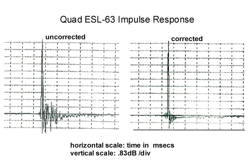

I'm a little puzzled by the conversion process of the TEF system. Is it incapable of making a true impulse response, and has to rely on a computation from the frequency and phase domain instead? Does this imply assumptions about minimum phase that may not occur in real loudspeakers? Not clear on the concept here, or what benefits TEF has over MLS measurements, at least for time-related measurements.
The impulse response we've seen of the ESL63 are frankly kind of bad - there are plenty of direct-radiators that are better than this, and original ESL57 is quite obviously better. I guess that explains the continuing popularity of the original, despite its many faults - low SPL capability, quite narrow lateral beaming, and somewhat tempermental room positioning requirements.
As we are seeing, loudspeaker systems that quiet down 35-40 dB in less than 500 microseconds are not that common. I have big reservations about electronic gizmos that purport to offer inverse compensation of time errors, since these same errors are typically are extremely fine-grained spatially - move the microphone (or listener) a few inches, and the time error can be radically different. Not necessarily any larger or longer, but a completely different fine-grained structure in the time domain.
This is a dead giveaway of diffraction or reflection, and a sign that electronic correction will makes things worse, not better, since the exact correction only works for a very small position in space, and makes things worse everwhere else. Errors like this cannot be corrected in either the time or frequency domain (well, you can, but it makes it worse), but have to be removed at the source.
To remove these errors at the source - the real, existing, physical world - you have to measure the precise distances and work out the likely location of the bad actor. Could be an internal cabinet reflection, could be a reflection off something on the front panel, could be a sharp edge somewhere, could be an unhappy driver resonance, you have to look, correct, and re-measure. Over and over again. If there are so many reflections (or resonances) all you see is a lot of random-looking clutter, well, then you know you have a basic design error - not only that, one that cannot be compensated for in the time or frequency domain.
This is kind of an old-school approach, and enters into discussions of whether or not XYZ fault is, or is not, audible, but I just don't like defects like this on principle. Now the arguments about audibility of phase distortion and crossover topology are a different thing entirely - that's the first part of the impulse, NOT the decay portion, which interferes with spatial and harmonic-decay impressions. In a feedback amplifier circuit, if you find even a miniscule tendency to ring at HF or approach oscillation under dynamic conditions, you don't debate audibility - you remove the defect and re-design as necessary. In the analog electronics world, that's just considered good design practice.
