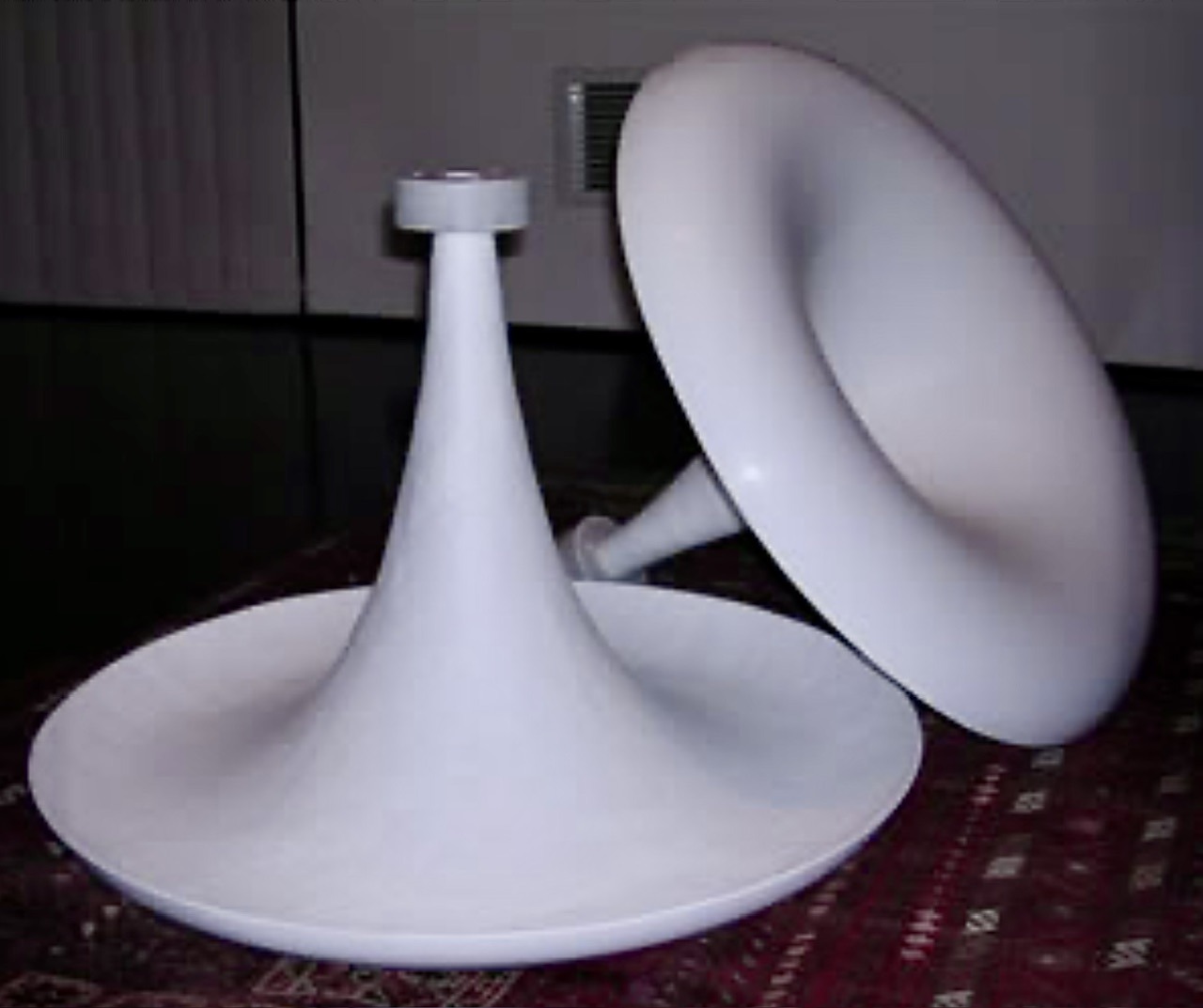

The LeCleac'h family of expansions have a very smooth Fc transition region, compared to other profiles (data based on Bjorn Kolbrek's doctoral dissertation). There seems to be a tradeoff between constant directivity vs smooth cutoff behavior, with conical on one extreme, LeCleac'h on the other, and other horns in the middle.
The LeCleac'h horns are part of a larger family of low diffraction horns, some with some pretty wild shapes.

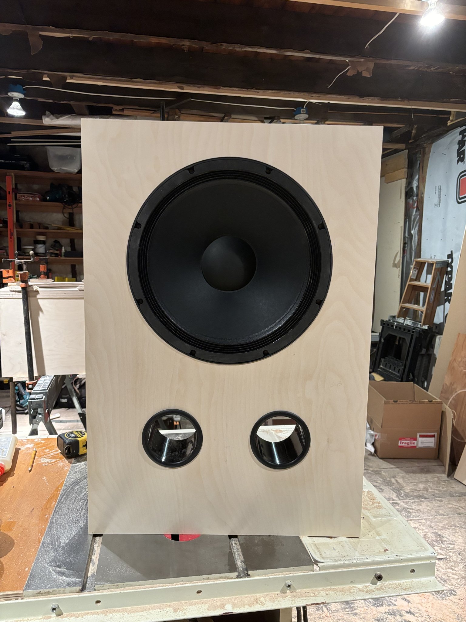

Since I'm building a similar type speaker, I've been scouring the weeds for a 15" driver to suit my needs too. GPA is out of the question due to cost, so I looked at and modeled (WinISD) drivers from Acoustic Elegance, Beyma, including the 15Mi100, 15P80Fen, and one other. B&C, Radian too. The FaitalPro 15PR400 stood out at least in the modeling, and a lot of people have really liked it over the years, so that's what I chose. F3 of 43Hz in a 135L vented box, and all the other measurements look great. A couple of those others looked super promising but hardly any of them will get below 50Hz. Crossing it with the Rosso 65CDN-T and considering using Troy Crowe's rear covers to get it to cross a bit lower, which should, I hope, help them integrate really well at the xover, hoping it will look good at 700Hz. I'd love to go lower, but The AH425 (shipped today!) really wants to cross closer to 800 according to Martin. I know this doesn't answer the IMD question, but just thought I'd weigh in on some of what I've found.

That's going to be a nice build. If you plan to cross at 600, ask Troy about his rear covers for the Rosso. I was interested and still am, but I can't cross that low because I'm using Martin Seddon's AH425, and he tells me 800Hz is a good spot for them. When I asked Troy, this is what his response was, I hope he doesn't mind me pasting it in here:
"Hi Bryan, the rear cover lowers the FS from 470Hz to 290Hz which affects the phase response an octane above FS. So it cleans up the sound near the crossover point if going down to 600Hz.
There is an audible difference where the driver takes on a more relaxed sound."

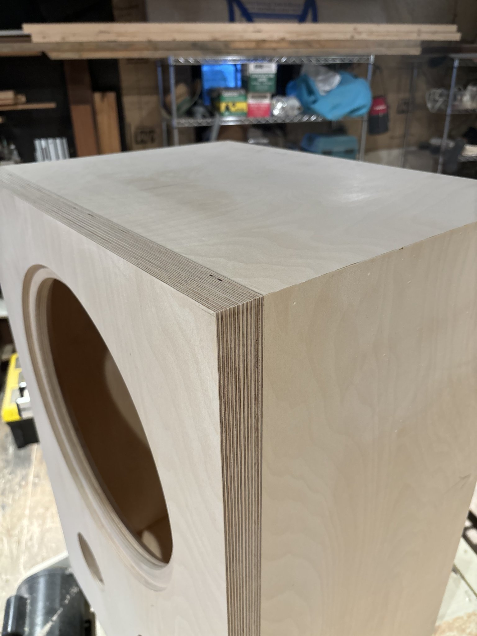

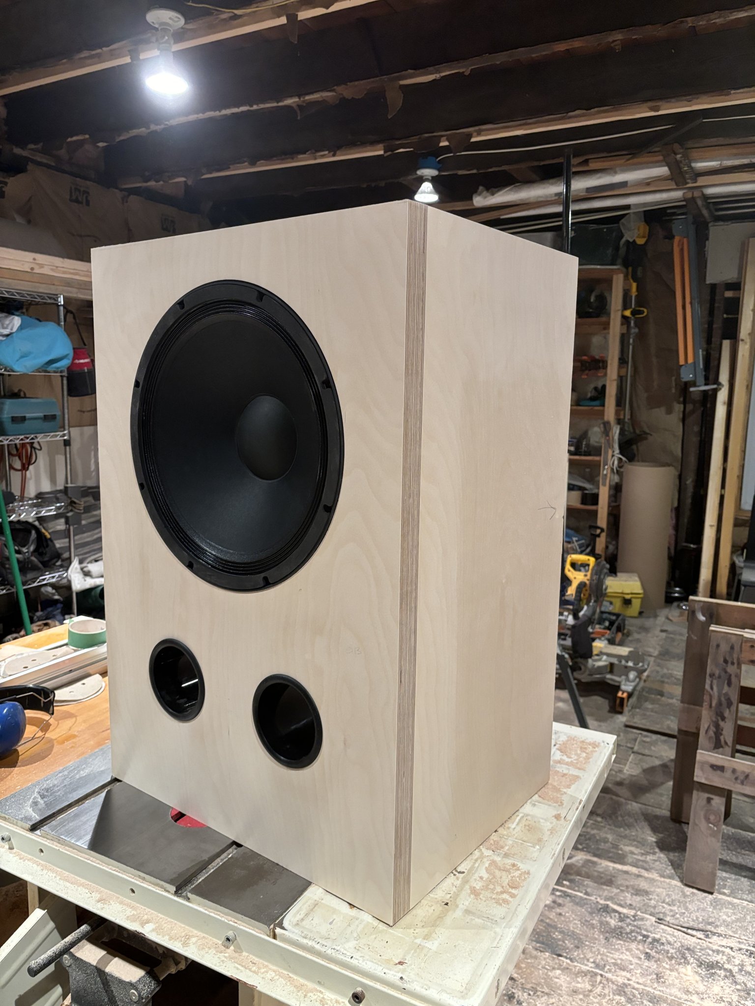

OK so I have a question regarding baffle edge diffraction and large radii at the edges. I was able to knock out the cabs for my 15PR400/Rosso65CDN-T/AH425 build, and had planned to put a 38mm radius on the left and right edges, but the way they look with the 36mm of Baltic birch edge showing, I'm smitten and don't want to grind into it. I know Lynn has made a good point for large radii but I'm not ever going to do 3-4" as he did, and from what understand, lower midrange and bass frequencies really aren't that affected enough to even measure let alone hear. This probably explains why so many big drivers are surface mounted as well. What I'd like to do is spray everything satin black but leave the edge grain with a clear finish, make it a feature. Any good science on this from anyone? Thank you, here's a couple of shots:
