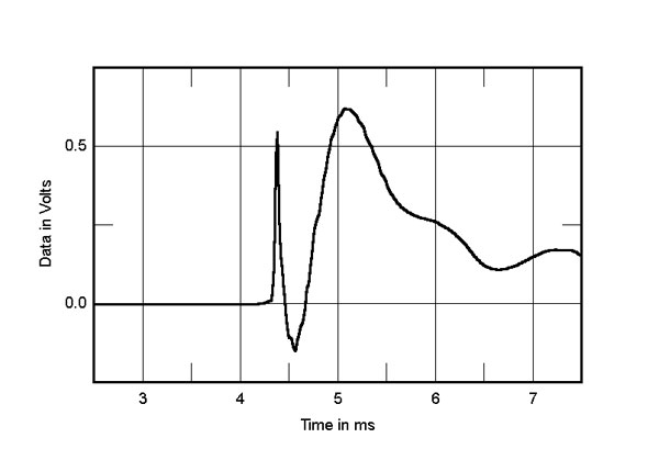

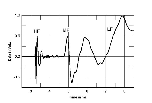

Hello Mark 100
It's much easier doing that with a hybrid approach as to all horn loaded. Look at a JBL 4367 vs Klipsch La Scala measurements thanks to Stereophile. I have never heard either one but looking at the measurements there is quite the difference.

Those plots just show time alignment being wrong assuming that's acoustic pressure. Probably pretty typical for old school all horn systems that weren't physically aligned and didn't have the advantage of digital delay. Acoustic centers I took to mean vertical spacing. Horn 2 ways still have pretty bad vertical spacing unless you go to something like a unity / synergy design but that's not usually going to be a 2 way either. Personally I haven't found the large vertical spacing between an upper-mid driver and a super tweeter to be too problematic. You can definitely see it in the vertical polars, but I guess the spatial comb filter is dense enough that I don't notice it even when moving through it.

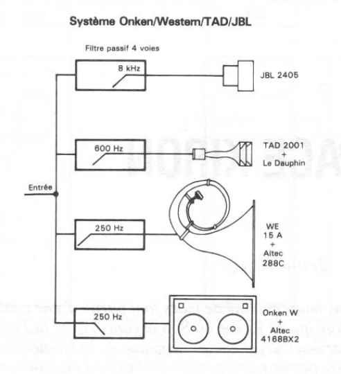

All of the truly great high-efficiency systems I've heard were 2-way. Without exception.
A well executed two-way speaker is a thing of beauty and can bring a lot of listening pleasure into the home.
But the best speaker system I ever heard, far and away the best - was 4-way. Direct radiating woofers, 3-way horn on top of that. Of course I'm talking about the big system we did in my theater in Paris. I have spoken of it on (too) many occasions.
Onken W double 15" woofer cabinets, W.E. 15A horn with 1940s Westrex 2080 driver, sand filled wooden horn with TAD 2001 driver, JBL 2405 tweeter. All 2nd order passive crossover at 200Hz, 1kHz, 8kHz. The diagram shown below is for a setup of the same system six years later, the crossover points are different. I had really hoped for a sophisticated active crossover on the system (at the time I was in love with active crossovers) but it didn't happen. Well this system and one Altec system completely changed my mind on crossovers. If passive crossovers can sound this good, then no need to worry about anything else.
Having that giant 15A horn playing between 200Hz and 1kHz must have been a large part of what made the system so darn good. The super clean Onken W bass cabinets helped too. The system just got things right, voices and instruments, tonal balances and tone colors. But other systems can do that. The most remarkable part, the part that set the system so far above any other I've heard, was space. It could do 3D space like nothing else. The system could convince you that there was a string quartet on stage, or that you were in a smokey jazz club, at in a huge concert hall with an orchestra in front and the choir behind or in a giant cave underground. Every recording was remarkably different You could point right to where everything was in the recording. Even height! You could clearly hear three rows of choir. I still don't know how that's possible, how that even exists in a recording. I've never heard (but almost) another system that could do that. And I've searched and searched for decades without finding it.
This isn't the sort of system that you are going to put in your living room, but it did prove a lot a important things to me.

The giant WE 15A horns must be quite an experience, as well as the double 416's in the Onken cabinet, supporting it all below 250 Hz (below any cabinet modes).
That's why I briefly jumped in the Hybrid thread next door, where the poster combined a vented box 12" with an identical 12" in an open baffle directly above it, both sharing a common series crossover around 100 Hz. It cleverly bypassed box modes while retaining the power-handling of the 12" driver. Obviously, this could be scaled to two, three, or four 416's, as desired.
But the scale of what you described above must have been other-worldly.
