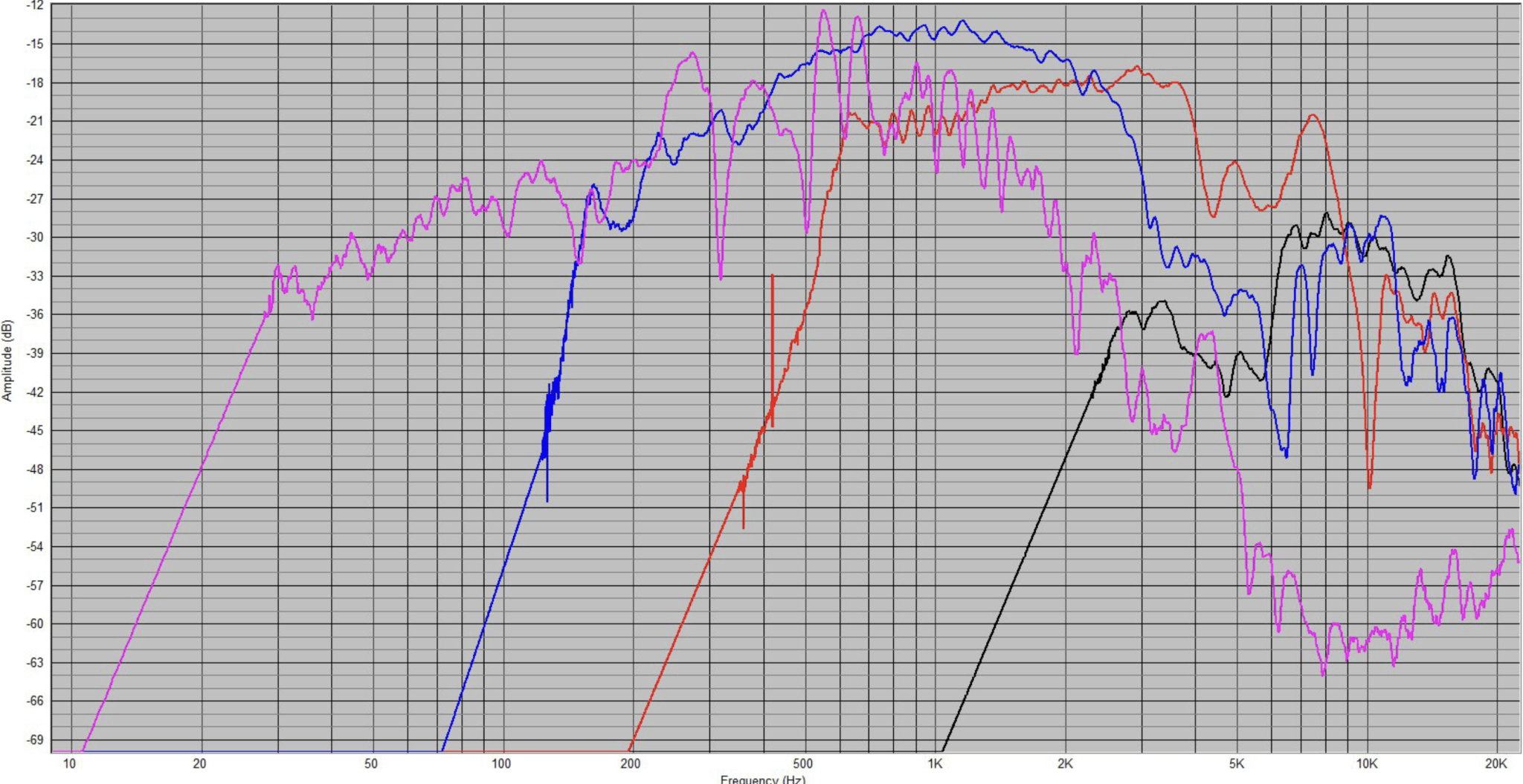

Here are some unfiltered Goto response curves I took a long time ago. These are measured outdoors. Drivers were on the Goto horns (except the woofer - that was in a back loaded horn). The compression drivers are all pretty limited bandwidth devices. I think the low mid and upper mid drivers have simple phase plugs which limit the high end compared to multi slot designs. This was the SG38WNS, SG570, SG370DX, and SG160.
And to Pano's point (probably - depending on what he heard), if you go with the recommended Goto simple crossover designs, the response is atrocious. It's like +15-18dB between 200Hz and 4kHz relative to the highs and lows.

Yes, thanks for the measurements, John Sheerin
I've wondered about the GOTO's unusually limited bandwidth per their specs, if they were just specifying perfectionist caution (and selling more drivers Lol)
But your measurements show the bandwidth limitations are quite real.
Pano, damn shame the xovers were so bad, when you got to hear them.
Funny, how it's possible to get some speaker elements so right, and others so blatantly wrong.
