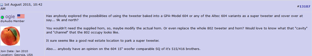

Has anybody explored the possibilities of using the tweeter baked into a GPA-Model 604 or any of the Altec 604 variants as a super tweeter and xover over at say... 9k and north?
You wouldn't need the supplied horn, so, maybe modify the actual horn. Or even replace the whole 802 tweeter and horn? Would love to know what that "cavity" and "channel" that the 802 occupy looks like.
It sure seems like a good real estate location to park a super tweeter.
Also... anybody have an opinion on the 604 15" woofer comparable SQ of it's 515/416 brothers.

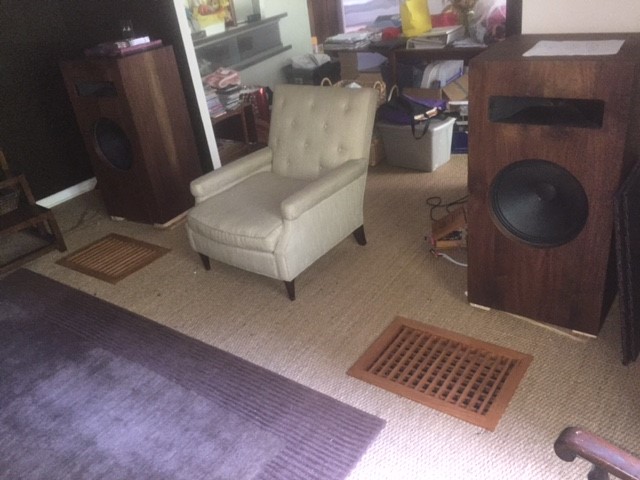

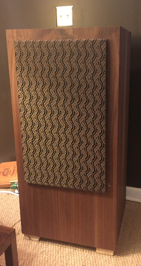

To further prove your theory Lynn, I'm sure Panos "rough" speakers are sophisticates compared to my prom queens.
Mine sound rough but look good enough for the living room.
6.2cu ft cabs, 802B Altec drivers/ 32B Horns (metal) w Jensen P15LL woofers. Crossed over at 2kHz. Pretty ragged response and rolled off on both ends... still working on the crossover.
The grates in front of the cabinets are infinite baffle subs w 2 15" woofers per side.
file:///C:/Users/doug/Documents/Audio/My%20Speakers/IB%20Subs.jpg
file:///C:/Users/doug/Documents/Audio/My%20Speakers/mY%20DIY%20Speaker.jpg

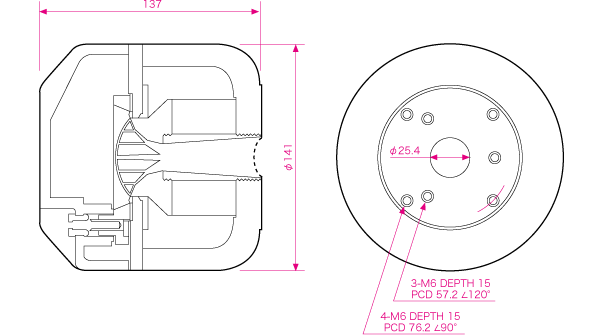

For a truly superb top end addition the only driver I've found that can really supplement a larger compression driver is the TAD ET703, a true small format compression driver/diffraction lens combination.
I'm sure the ET703 must sound fantastic. However, they also have a rather uneven frequency response (see attachment, from the official data sheet).
I have personally found the larger Fostex ring radiators (like the T925A units I use) to sound very clear and clean too, provided they are high-passed properly (i.e., at least 2nd order) and using good quality MKP caps (e.g., I use Jantzen Superior Z-caps).
ps. The only issue with the TAD 2001, simply a JBL clone really, is that the compression drivers throat is to long which creates a very narrow exit angle. Besides that they are really nice sounding drivers with the Be diaphragms.
The long and narrow internal throat is indeed a liability if one intends to use the TD-2001 as a super-tweeter. However, it also contributes (together with its "slow flare" phase plug design) to the driver's good acoustic loading down to ~400Hz. So it basically trades off some top-octave dispersion for some bottom-octave loading. Pick your poison...
(P.S. the TD-2002 has a similar internal throat, but also a different, completely redesigned phase plug that is supposed to be better at keeping the output phase coherent to beyond 20kHz - see second attachment)

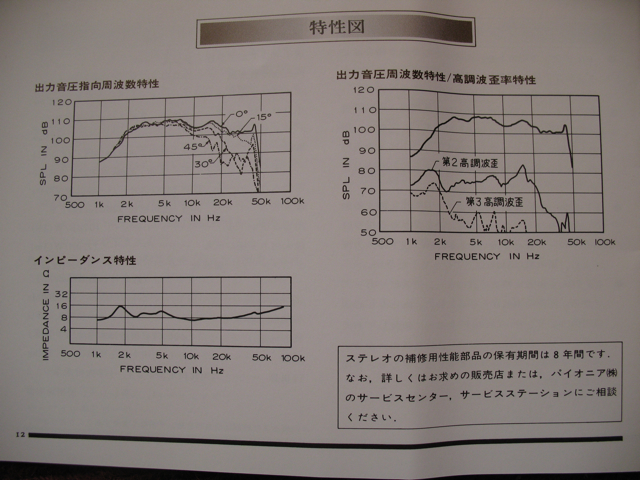

ps. I only used the TAD ET driver upwards from 10Khz, any wiggles in the response that high I'm not convinced are audible as long as they are not diaphragm breakup modes. A simple spike or hole that high in the program material will be imperceptible to the average person.
Agreed that it won't be an issue at all above 10kHz. But if used down to 5-7kHz, then it might pose a bit of a problem to the crossover.

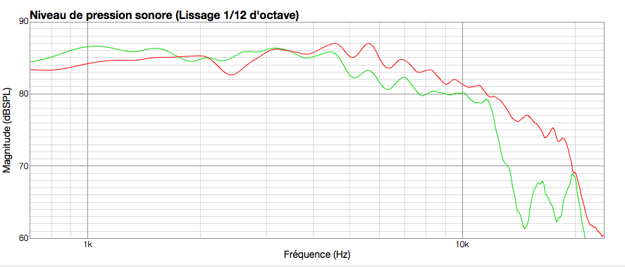

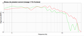

It was a tough choice but one of the drivers had to go. The factors were top frequency extension and availability of diaphragm - everything else being more or less equal.
By the way John Meyer used the Yamaha JA6681A in the Meyer Sound UPA1A loudspeaker and in the 833 studio monitor. They changed it because the frequency response of the Yamaha driver tops out at 14KHz, and they needed a driver that went to 18KHz.
I found an old measurement of the two drivers in similar conditions. The green curve is the Yamaha and the red curve the unequalized Radian Be. The latter’s curve is not as smooth but it does extend well into the top end.
Subjectively with a supertweeter I had a slight preference for the sound of the Radian, but I couldn't measure nor reason why.

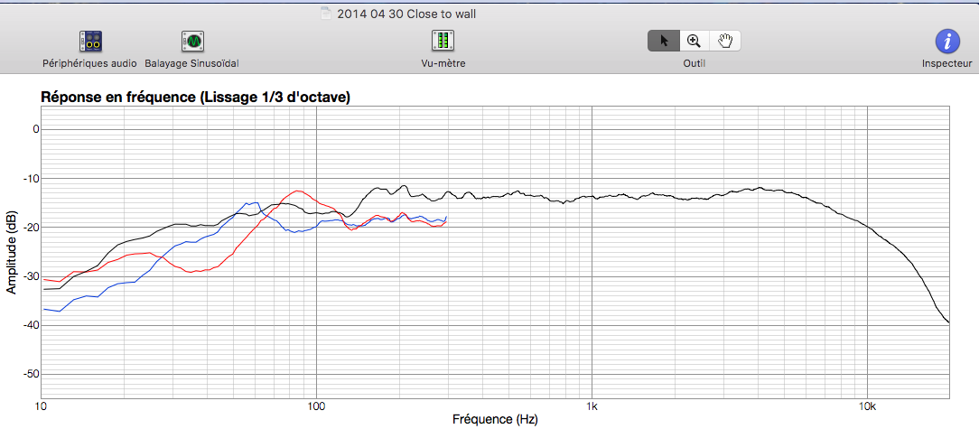

Baffle step compensation
In post #14539 Lynn gave a comprehensive overview of the various effects to be considered when applying baffle-step compensation. This was as clear a description as I have read.
In practice there is a lot of trial and error needed for getting this compensation to sound right. And no quick way to shortcut this process other than messy room measurements and listening. For what it’s worth, here’s my finding.
For my medium sized room, the near field response shown below was subjectively satisfactory for a paper cone that is 12.25 inches across mounted in a sealed box having a 20 inches wide baffle. The response using a solid-state push pull amplifier (high damping factor) is shown in red, and a single ended tube amplifier (low damping factor) in green. We’re looking here at a gradual 3 dB between 100 and 200 Hz, and another 1 dB between 200 and 400 Hz. This is a bit more than I thought would be needed. As Lynn and others pointed out, a second driver comes in handy to achieve this additively.
Personal taste and the room are big factors of course, so your mileage may vary.

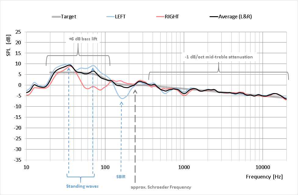

With my system & room (single 15" woofer in 60cm-wide box, placed right up against the front wall), and without any baffle step compensation at all in the passive crossover, by averaging the Left and Right speaker responses (*) I get a relatively smooth 6dB "shelf" lift below ~100Hz, which sounds just about right with most recordings (cf. Olive et al., "Listener Preferences for In-Room Loudspeaker and Headphone Target Responses").
(*) The reason for the rather different L vs R responses is due to the asymmetric positioning w.r.t. the side walls. Unfortunately, this couldn't be avoided. However, luckily, below 100Hz or so the bass frequencies in most recordings are fundamentally centred (i.e., mono), so the L+R average is all that matters.

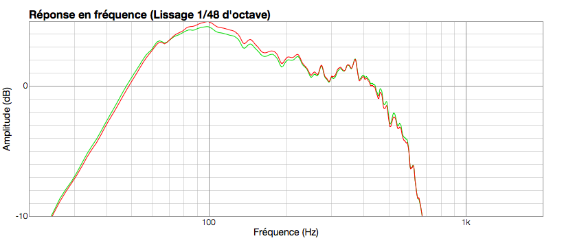

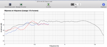

Your plot prompted me to search my archives and guess what... I found some measurements of early prototypes that I temporarily placed close to the wall before adding baffle step compensation. I thought it would be fun to compare.
In the plot below, left is blue, right is red, and black is the combined response at the listening position of both speakers playing at the same time.
Caveats: This is not where the speakers are normally positioned. And this not the filter I now use and shared above. I think these must be the Yamaha drivers by judging the high end roll off. See how even their response is in the midrange.
A bit like in your room Marco, the dips introduced by my room are at different frequencies for the left and right speakers. I like to think that this is a positive.
In any case the low end did not sound as bad as it looked. But there simply wasn’t enough of it for me.
