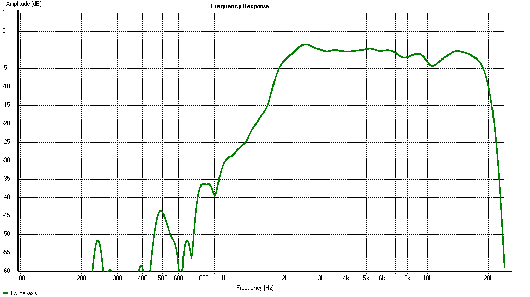

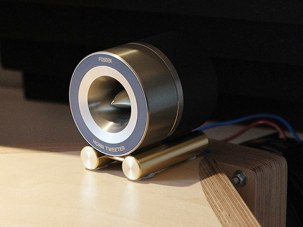

The Fostex T925A (see pic below) is what I use, crossed over to my Be-equipped large-format compression driver at 6kHz.
It is very efficient (108dB/W(m)), with a rather flat FR (see my own gated measurement below, on axis), and with an approximately 90º dispersion angle up to beyond 10kHz.
Given the "right" recordings, it gives a very realistic sense of "air" to the UHFs, without imparting any harshness.
Marco

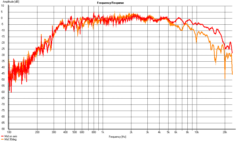

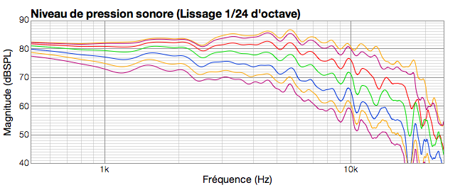

Found some of my old measurements taken in room, from zero to 60 degrees off axis, of the Radian 745NeoBPB-16 Beryllium driver on the LeCleac'h profile Azura 425 horn. The driver is not equalized on these. As Lynn pointed out, there is no cutoff angle to speak of. Note the well-behaved (gradual and smooth) roll off.

Interesting, thanks for posting.
I see already -6dB 30º off axis at ~5kHz, compared to essentially 0dB for my horns up to the same frequency. But then, as you say, mine "nose dive", while the Azura just keeps narrowing its pattern gradually. Pick your poison ;-)
