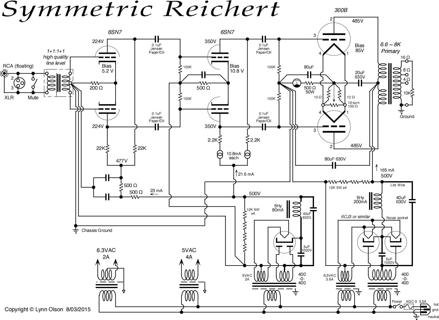

Updated schematics for the Karna Kay and Symmetric Reichert amplifiers. Voltages and currents are based on measurements of the Thom Mackris Reichert SE 300B and the existing Karna amplifiers.
For the symmetric Reichert, what is the value of the 2 capacitors connected to the 500 ohm resistor that is tied to the plates of the 1st 6SN7?
