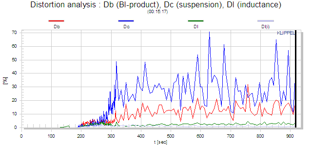

That sounds right, so I must be reading the Klippel measurements wrong..
I think it's the break-down of distortion products that I'm having problems with.

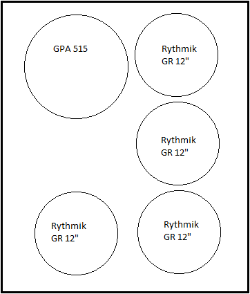

Hi Lynn
How about these:
GR Custom Install - 12" Direct Servo subwoofer featuring GR Research drivers
My choice would fall on the 'Dual drivers for sealed enclosures' option. They can cross as high as 120Hz (I have heard it is possible to stretch that to 150Hz). They are not cheap, but I think it will probably be the some of the best bass possible. Personally I would take 2 pairs per side, but that's just me. If you take 2 pairs, they can be mounted in an L-formation around the GPA/Altec 515 Alnico. I did a quick sketch in MS Paint to illustrate- see attachment (I only have Paint available, so excuse it for being basic). I know two pairs per side is getting on the expensive side, but to keep up with the quality of the other components, this is necessary IMHO. And the sound... Just what a bass freak like me wants.
Enjoy,
Deon
PS. OK, I'll confess, if it was up to me, I'd take 3 pairs per side. Three drivers in the front, three in the back, all in the same L-formation (just delete the top driver in the sketch and move the GPA 515 down), with force-cancelling rods in between. A real bass nut's dream. Then again, that's just me, and I'm crazy.

I don't really understand that plot (% THD vs. time?) so I can't comment. I am not saying that compliance can't be the highest distortion component, it depends on the signal and the situation. Was the speaker in free air, or in a small enclosure? Was there significant signal content at and below resonance?
A speaker with no air compliance operating with LFs below resonance will distort like crazy from the compliance, but its not a realistic test.
I have long argued with Klippel that his testing is only accurate where it doesn't matter. I was consulting for a company and they were using Klippel data. I asked them how stable was the data, particularly for the higher orders that matter. They didn't know. They did a "gauge capability study" and found that all orders above the third were basically random data. To quote the boss "Throw that thing out!"
