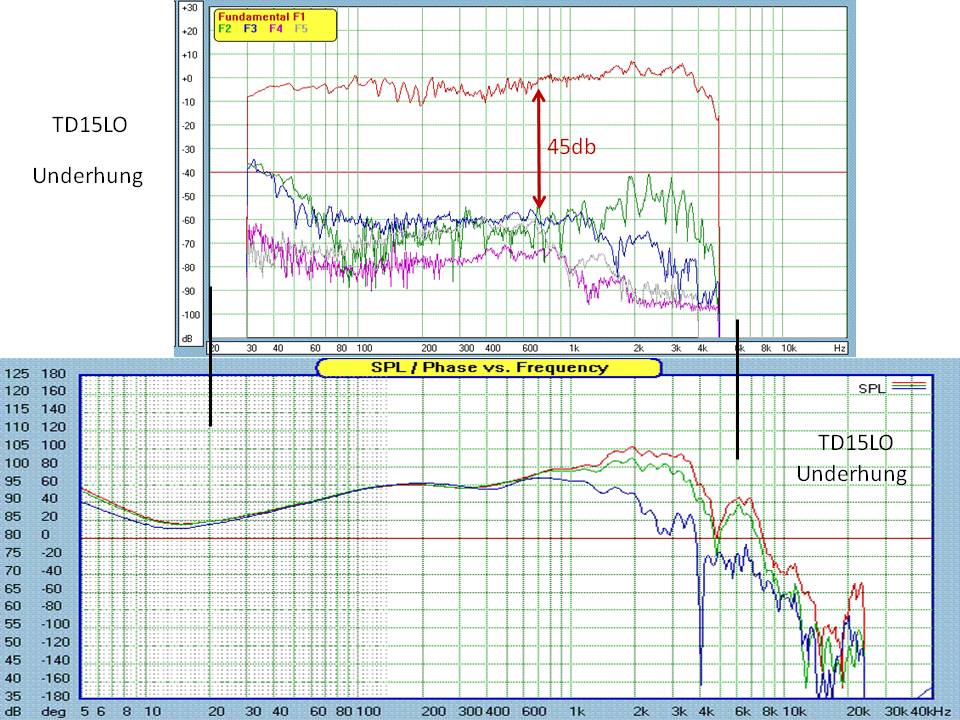

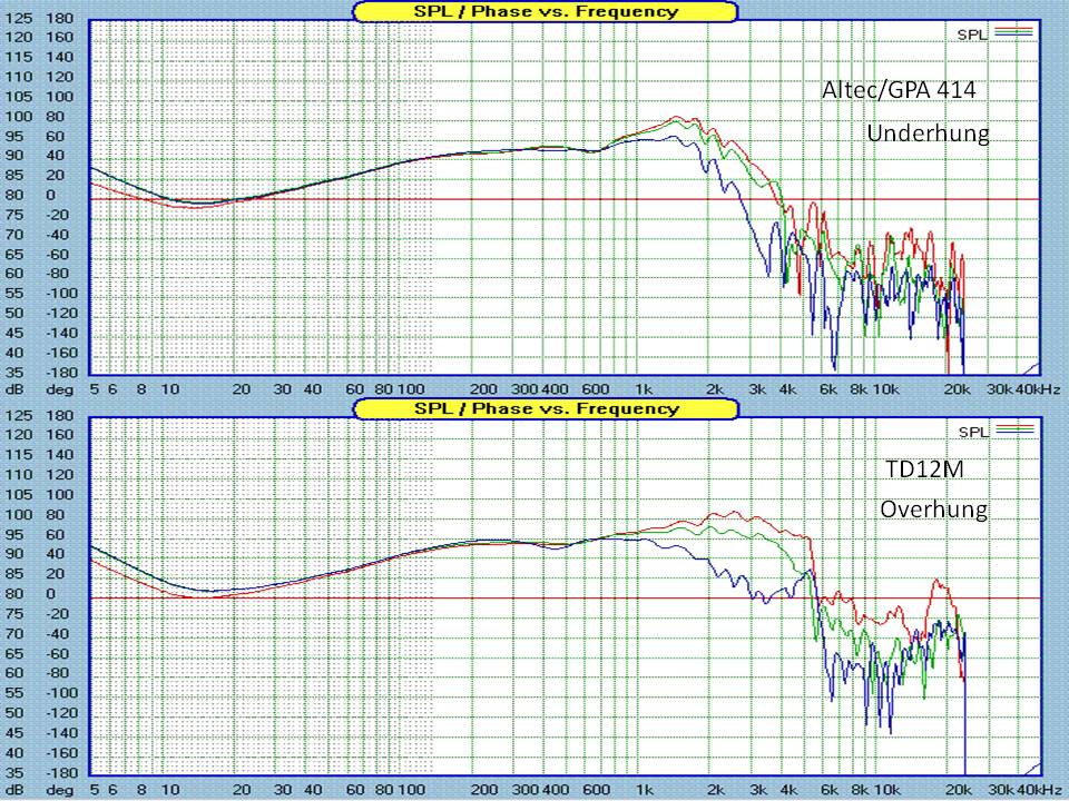

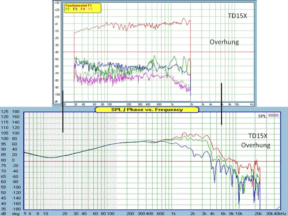

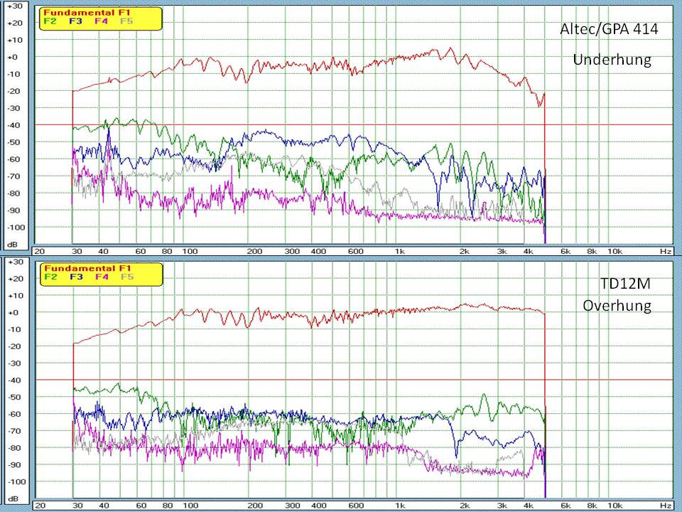

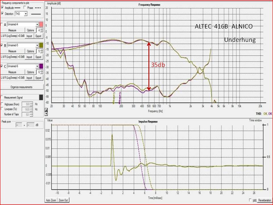

I attached the common reference data for underhung/overhung speakers to help the discussion. I own Lambda drivers.
LineSource,
You can't even compare one GPA driver to another from what I have seen in Lynn's comments. How are we to compare two completely different drivers like that? I would want to see two identical drivers with only the voicecoil and motor assembly changed. One problem with calling a driver underhung is that the amount of differential between the coil length and gap length has to be looked at. All underhung motor designs are not comparable.
