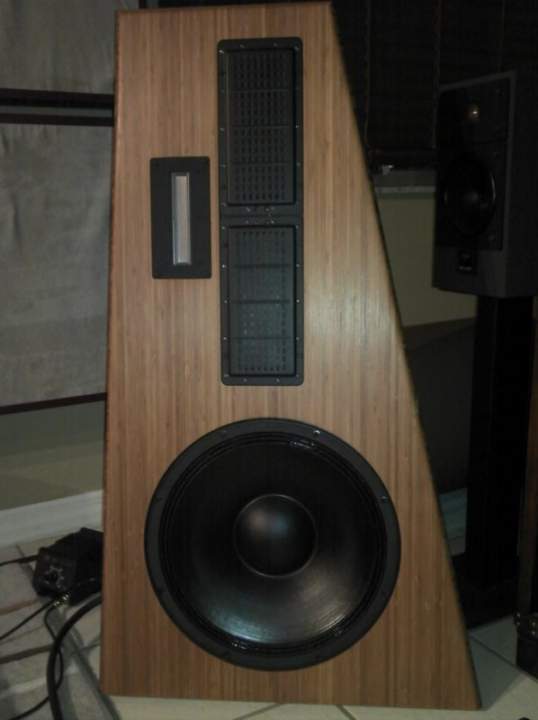

I'm experimenting with waveguide + cardioid woofer at the moment (ER18DXT and the 27TBCD-DXT tweeter). Even though I'm in a different category from Lynn's efficiency figures and design preferences there is something to be said about the nature of the sound in this configuration. The difference from conventional speaker boxes is striking and the sound is very immediate, unobstructed.
Working with open baffle is very challenging though, I underestimated the challenge.

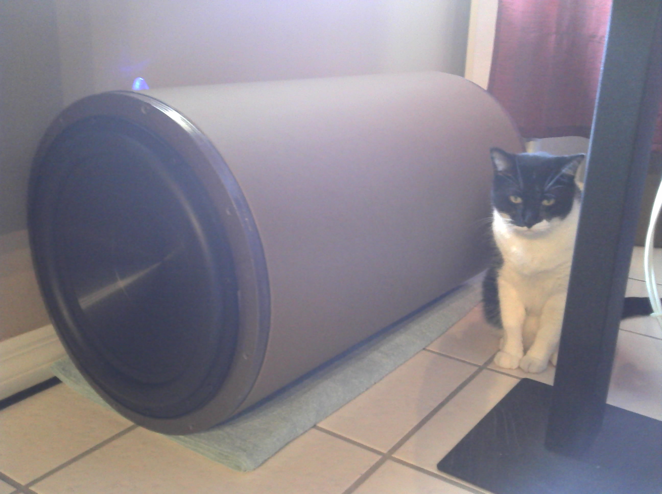

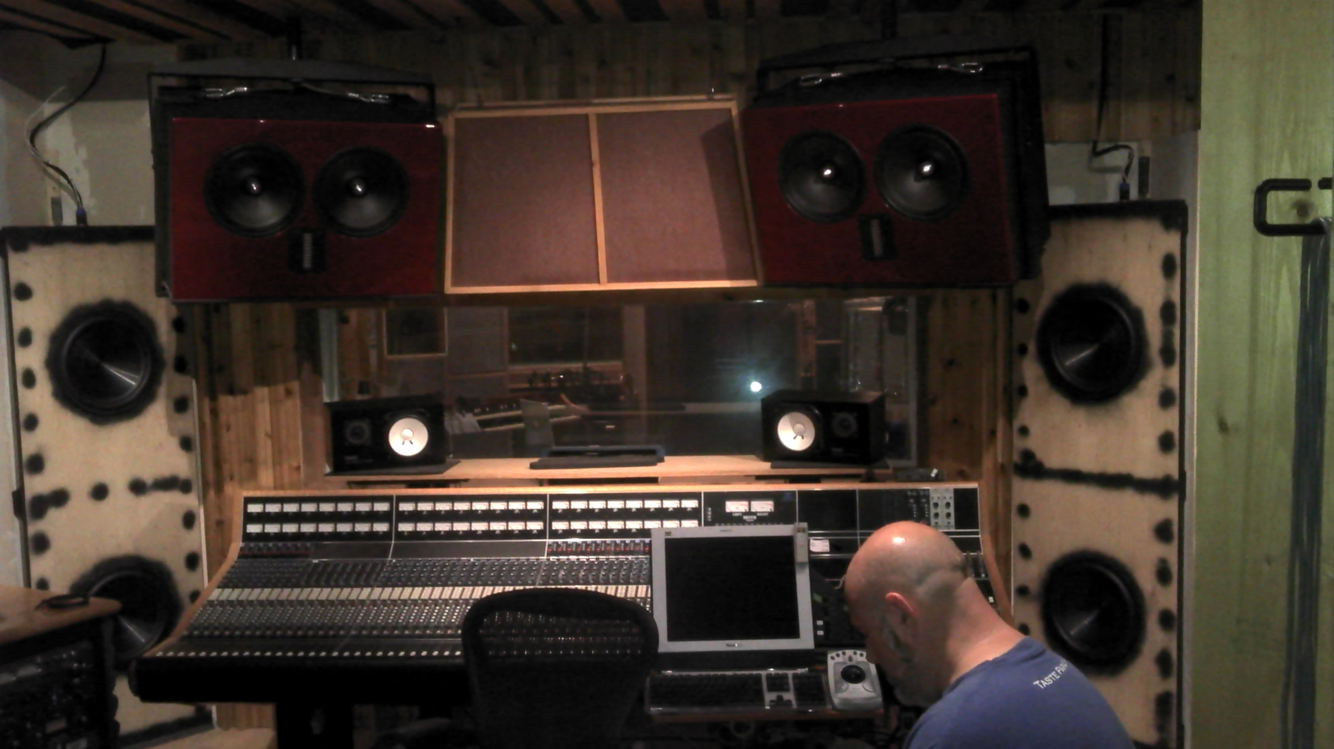

I could not agree more. We are running a pair of Rythmik 15" per side crossed around 60Hz at the studio and I am also running a stereo pair of 15" at home with my open baffles. We tried higher crossover points in both places and 70-80Hz was too high IMHO. I did not intend to runs subs at home and started out with Lambda Dipole 15s in the baffles, but they could not give me what I was looking for, so I swapped those out for some low Q B&C woofers and added the Rythmik subs in PVC plumbing tubes directly behind the baffles.

As far as the subs go, there is no need to develop your own amps. The Rhythmic Audio subwoofer solution comes with their own amps, which have the servo-feedback circuitry built in. The amps have built-in adjustments for 'Delay/Phase', 'Crossover (frequency)', and 'Level'. It has a further switchable parametric equalizer with adjustments for 'Gain', 'Bandwith', and 'Frequency'. I am not affliated, just a fan.
As far as the main speakers are concerned, I was thinking that the depth of the mid-bass box can be reduced to reduce the volume and so reduce the low bass output. The front dimensions must be kept the same so not to affect the XO. An different alternative would be an open baffle or a lossy cardoid box that will limit low bass output. Just my thoughts.

Well, we've ended up with pretty much the same settings at my home and the studio. Max extension(14Hz), highest damping setting(this switch has a tremendous effect and can take the subs from typical floppy sounding to super controlled and tight) and about 60hz crossover. I should note though, that at the studio we are using the BSS Omnidrove that controls the mains(Lambda and Beyma TPL-150) for crossover and EQ functions for the subs. At my home, I use the built-in crossover and parametric EQ on the Rythmik plate amps.
I've also heard others claim that the Rythmik stuff is just average or not that good. Well, it's all up to integration, isn't it. If you don't get them adjusted and mated with the speakers very well, of course the resulting outcome might not sound that good. Properly implemented, these subs are excellent.
Also of tremendous sound and quality would be Dannys take on open baffle servo subs over at GR Research. He is partnered with Brian at Rythmik on these. I've heard them several times and they are superb and dig really deep. He uses them successfully with his open baffle, high efficiency models with no problem, so in practice, low efficiency open baffle drivers are working just fine with nearly 100db/spl sensitivity speakers.
I also have to note that Bob Katz of Chesky Records and masterng fame has heard the subs and is impressed as well. Once he hard the mains, he thought they might be the best large monitors he's ever heard in a studio setting. Now they we added the subs, we are possibly surpassing the sound of his own mastering studio. I used to be an assistant for him many years ago and he is local in town here in Orlando.
