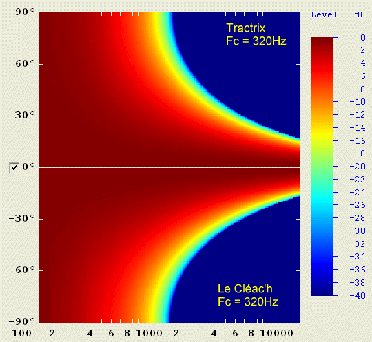

I think that there is some mistake in your idea that a tractrix could possess a better dispersion than a Le Cleach horn. For the same cut-off frequency both of them have nearly the same polar patterns.
See the attached graph which presents the comparison between simulation performed with Hornresp of the polar maps of
a tractrix (upper half of the diagram) and a Le Cléac'h horn (bottom half of the diagram).
An advantage of the Le Cleac'h horn upon the tractrix being smaller diffraction effects at the mouth (in some case that diffraction can give a fake impression of better dispersion though). But I fully agree with Lynn that diffraction is the firts thing to avoid in horns and this is one of the main goals of the Le Cleac'h horn

I pretty much memorized the Newell and Holland book. Of all the horns out there, the only one I could find that met all of the N&H criteria was the LeCleac'h. The custom BEM software written by Bjorn Kolbrek further underlined this, since we looked at other profiles, and most of them had quite noticeable throat diffraction, as well as edge effects at the horn-mouth. The diffraction propagated through the horn and became worse as the wavefront expanded, resulting in narrow spikes in the polar pattern, as well as reflections in the time domain.

Thanks for your clarification, Jean-Michel. It seems I was indeed mistaken.
