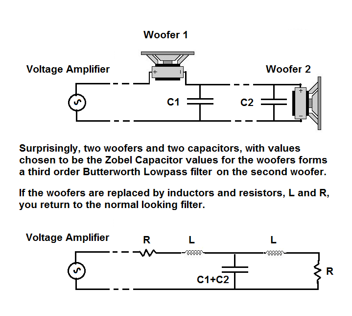

I was thinking about your near second order Linkwitz-Riley filters on the Ariel II:
The Ariel, Part II
You mention you prefer the filters in phase for matching reasons, but as we know that will (tend to) give you a notch in the frequency response. But just look at your red impedance matching circuit: isn't that crying out for the 10 ohm resistor to be replaced by a filler midrange driver, a la Bang & Olufsen? That corrects the impedance and fills the notch. :cool:

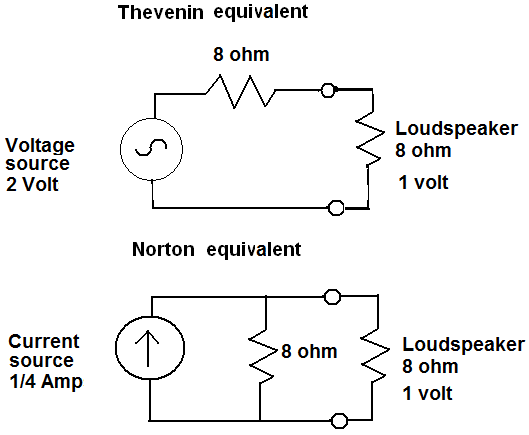

My own "epiphany" on amplifiers came with looking at the Thevenin and Norton equivalents, which suggest that it's really all about the topology and not the devices, and that the old-fashioned idea of matching source and load is really correct. Another came more recently, when that striking 3rd order Butterworth observation suggested a very deep relationship between source and load. After all, wouldn't it be all a lot easier if the amplifier actually knew what sort of load it faces before it tries to drive it? Or looking at it another way, the filter incorporates a model of the driver.

The Ariel is acoustically a 4th-order system, close to a LR4. Electrically it is a low-Q 2nd-order, but the drivers add their own characteristics, increasing it to 4th-order. In the normal-phase connection, the mids and tweeter are within 5 degrees degrees of each other, which is a key design feature.
The huge downside of B&O filler-driver technique is the drivers are in phase quadrature from each other - that is, there is a 90-degree phase angle between the woofer and filler, another 90-degree phase angle between the filler and tweeter, and the woofer and tweeter are 180 degrees apart. That creates a very strange polar pattern, with audible nulls as you move up and down. True, some folks might want to try a WFTFW layout, but I suspect it would have a symmetric but also very complex polar pattern. There would be a lot of widely-spaced drivers that would be completely out of phase with each other, and I can't see how that would sound good.

The amplifier's task, as I see it, is to ignore the load. Loudspeakers have many, many resonances, not just the obvious lumps in the impedance curve. You want a surprise, do a waterfall/CSD on the current flow of a loudspeaker (measure across a 0.1 ohm resistor in series with the loudspeaker system). You'll see all kinds of ugly-looking high-Q resonances in the time domain. This debris appears on the plates of the power tubes, or the emitters of the power transistors. If the amplifier has feedback, it gets echoed back to the input devices, and possibly cross-modulated with the amplifier's own distortion signature. There are no distortionless amplifiers, and there are no loudspeakers free of resonances. Marketers would like us to think otherwise, but it ain't so.
To that end, it is desirable the instantaneous output impedance of the amplifier is free of switching artifacts (Class AB, I'm looking at you). The ideal amplifier simulates a small but constant resistance across the whole duty cycle, and is not affected by the back-EMF products from the loudspeaker, which are highly resonant and distorted. Global feedback can decrease and linearize the output impedance, but it does not completely remove the Class AB switching transition.
To make the momentary shift in output impedance go away completely, it would take an infinite amount of feedback, a carefully zero-balanced feedforward technique, or accept the greatly reduced power output and stay in Class A over the entire duty cycle. Since infinite feedback is not available, and feedforward techniques that are stable under dynamic and overload conditions not trivial to design, I prefer Class A operation as the best interface between resonant, distorted loudspeakers and an amplifier with a nonzero output impedance.
