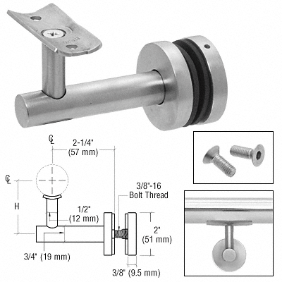

Me: If I wanted to go deep into CLD, I'd avoid a rigid fastener, cos the stiffness of staples / nails would partially cancel the CLD effect. Instead, I'd make use of some sort of rubbery brace to hold the lead in place.
e.g.
1) whatever those things are called that are for bracing glass panels (pictured).
2) KEF style CLD bracing (I think this means: the brace is stiff but has rubbery edges)
3) Geddes style (I think this means: each cross brace is made from two partial braces that overlap in the middle. These don't directly touch, but are joined by a rubbery layer)
Or, the easy way out: hold the lead down with something like roofing screws (that have the rubbery washer).
