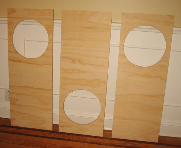

The sub and beta 12lt cabinets will be the same widths and but will differ in height and depth to get the right volumes. Sub on the bottom and 12lt on top of that then tweeter on that. Several layers of ply laminated together (but not as wide as the rest) will form the FT17h hosing on top.

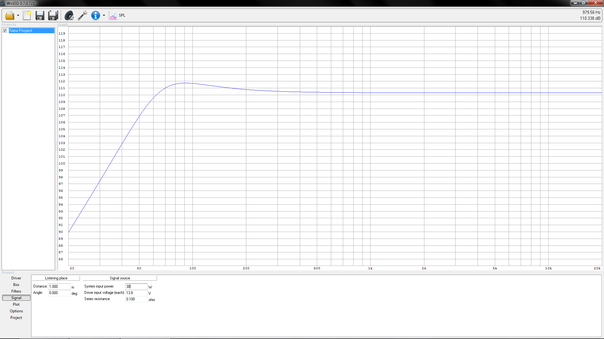

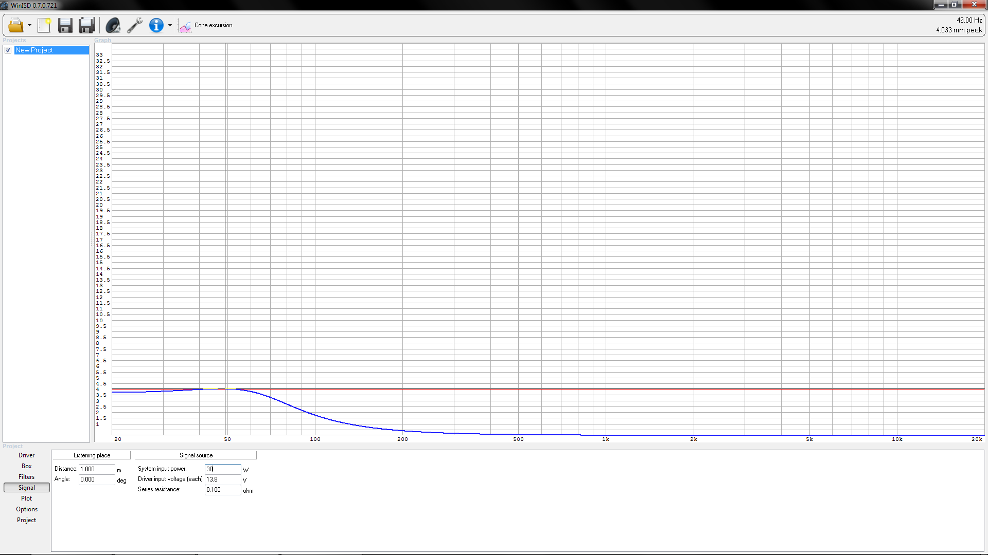

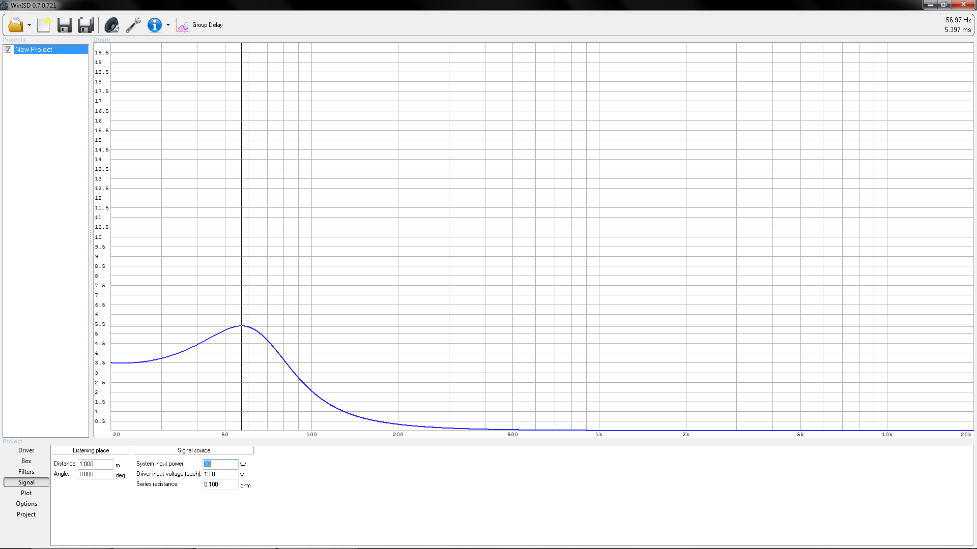

Could you run the spec on a Beta 15 http://www.eminence.com/pdf/beta-15a.pdf in a 5 c ft sealed enclosure pls?
I cant run winisd on a mac......
5 cubes sealed = 1.03 Qtc (under damped) -3dB @ 51 Hz.Could you run the spec on a Beta 15 http://www.eminence.com/pdf/beta-15a.pdf in a 5 c ft sealed enclosure pls?
Xmax @ 50 Hz with about 30w = max SPL around 110-112dB.
See PDF for more measurements on the Beta 15.

Shame about the woodwork. I'm gonna use a mix of MDF and Ply and then spray it up with a living room friendly colour of my better half's choice.

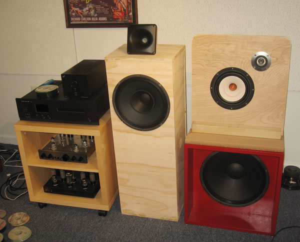

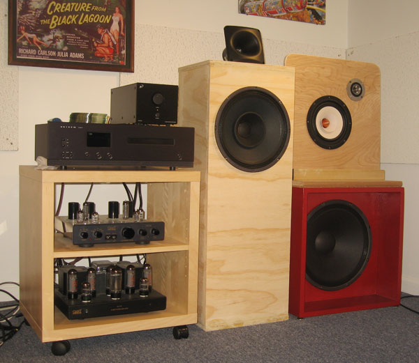

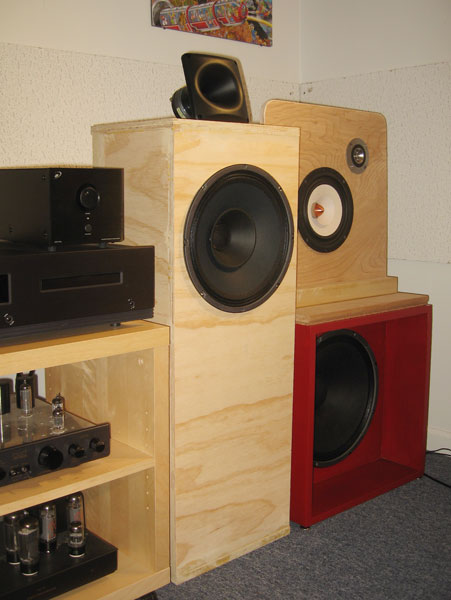

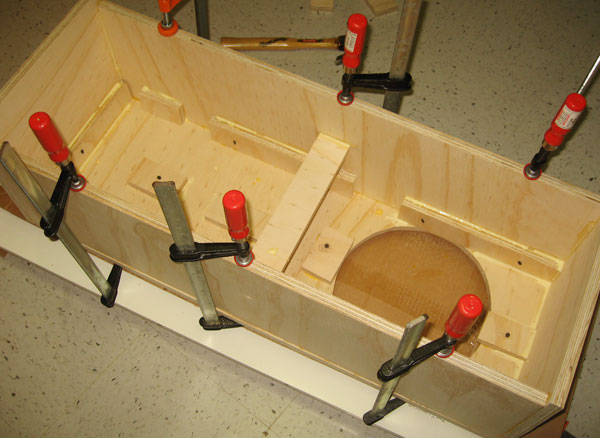

The driver has great potential! Today I listened to the 12lta for the first time and wanted to share my initial comments.

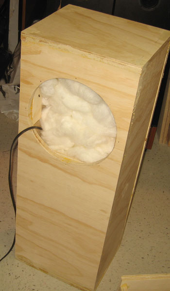

They are in 2.5 cubic foot sealed and stuffed boxes (see pic). I am powering them with a 30 watt tube amp (Cary Audio) but intend to ultimately use them with a T-amp (Dayton).
Cons:
Large driver requires large cabinet.
Lack deep bass.
Requires bass and treble extension.
Pros:
Efficient!
Big sound!
Wide range can easily be extended.
Application is everything! Finding the right way to apply the 12lta will be an interesting and fun challenge because it offers so much as a highly efficient wide range driver. It’s not as expensive as many of the full range drivers we enjoy but requires a tweeter and subwoofer to extend its frequency response. Otherwise, it’s a very large wide range ‘midrange’ driver in anything from 2.5 cubic foot or smaller. They sound like they simulate… lacking bass for such a large driver. But they offer excellent efficiency!

Based on the sims, it looks like a 4cf box (like the Hammer Dynamics) is the smallest one could pop the 12lta into and get bass. I think the Afterburner with a 2.8 cubic foot volume will be too small unless placed into corners… which may create other challenges. I think the BIB or another back horn would bring up the bass and balance it out but it will be huge… and very efficient!
Setting up only one speaker for a quick listen (around half hour) I can say this driver offers great potential! I directly compared it to the TB 1808 in the picture and they sounded very different indeed! The TB 1808 is on open baffle and has the amazing H-frames for bass support. It also uses the old Radio Shack ‘pod’ super tweeter. The 12lta is mated to an Eminence compression driver and a Dayton waveguide. To get started I chose a 1.5uf cap to connect the tweeter and put on some Jack Johnson.
1.5uf for this tweeter mated to the 12lta is within the level of ‘it works’ but isn’t optimal. There was too much ‘tweet’ there but it’s close. I will try a 1uf and see how that goes but remember, this tweeter is 103db per watt! I think the best value will be somewhere in between and maybe rolling off the tweeter at 12db rather than 6db will clean things up. Otherwise, I believe I am in the ballpark of blending these two drivers.
I am not sure if the 12lta will require a circuit. At first listen maybe it does but I have not played with toe in at all yet or dialed in the tweeter. It’s a forward sound but not as forward as the Fostex I have on hand. Overall it’s a large, dynamic, efficient sound. You can hear lots of detail. It makes a big sound that’s pushed into the room rather than set back. I can certainly see why many would love this driver… I can see why others won’t. So far, I like it enough to continue looking for the right application in my listening room. Eventually these speakers will end up in my office. Switching to the Wicked soundtrack, things were equally involving and detailed.
The bass is just not there. I connected the H-frames which added a beautiful full bass to the overall presentation but when disconnected the 12lta on its own fails in the 2.5 cf cabinet. Perhaps just sealing the 12lta in 1.5cf cabs atop the H-frames would work but so will many other drivers. They won’t offer the efficiency of the 12lta tho.
The 12lta is an efficient driver that’s exciting to listen to. It’s a beast that needs taming. I doubt it will be silky smooth as the triple the price TB 1808 or the double the price Fostex 168s (older style) but I do believe it will be an entertaining, enjoyable speaker to listen to that’s more efficient than anything I’ve heard to date.
So it’s a wide range ‘midrange’ that requires a helper woofer and tweeter to sound its best in a home environment. I believe it can be made to work very successfully in low watt systems (and probably high watt systems as well). Certainly it’s been around and found its way into excellent systems already. For now I will listen and tweak them in the 2.5cf sealed boxes and eventually add a sealed powered sub.
