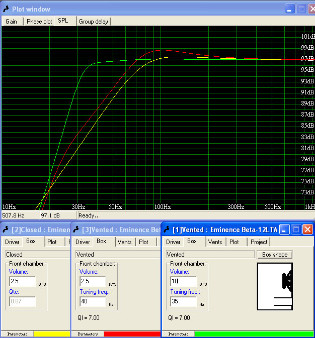

Here you go JRKO...
Probably should seal this driver up in a 2 to 3cf box and equalize it for best results for home use. You can see a 10cf box would be awsome! Not the easiest driver to figure out. But it offers so much i can't give up on it!

Thanks Godzilla. Goodness me that 10cb ft is flat to 40Hz :eek::eek::eek:
10cb ft is not that big - for home use. you probably wouldn't fit in your office!!
I was REALLY wanting to have some 15 inchers for bass duty :sad: but I dont know if I'll need them with that size cab.
Of course for Higher Fi the 2.5cb ft makes more sense and then I can raise hell with a 15 :p;):D

Thanks everyone for your input! I cut wood last night... decided to go sealed with a sub... three 2.5 cubic foot boxes exactly the same size... I was not satisfied with the sims unless going to 4cf like the Hammer Dynamics box (which looks like a really good overall compromise) or larger. I went with three smaller boxes rather than two large and will play around with positioning.
Imagine three of these Zu Audio - Omen - Standard
Two with 12lta near the top of the cabinets and one with a powered sub near the bottom... i just liked the sims of the sealed boxes best (tho bass extension was limited) and am excited to add an all sealed set of speakers to my collection! The powered sub should get me down near 35hz in my medium sized room (approx 13 x 16 with 11 foot ceilings). On their own the 12lta would manage around 65hz... that's not enough bass but i am hopeful what's there will be punchy and dynamic.
