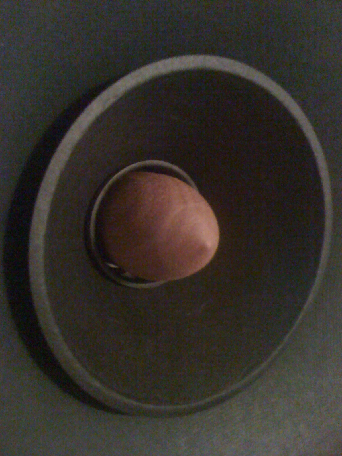

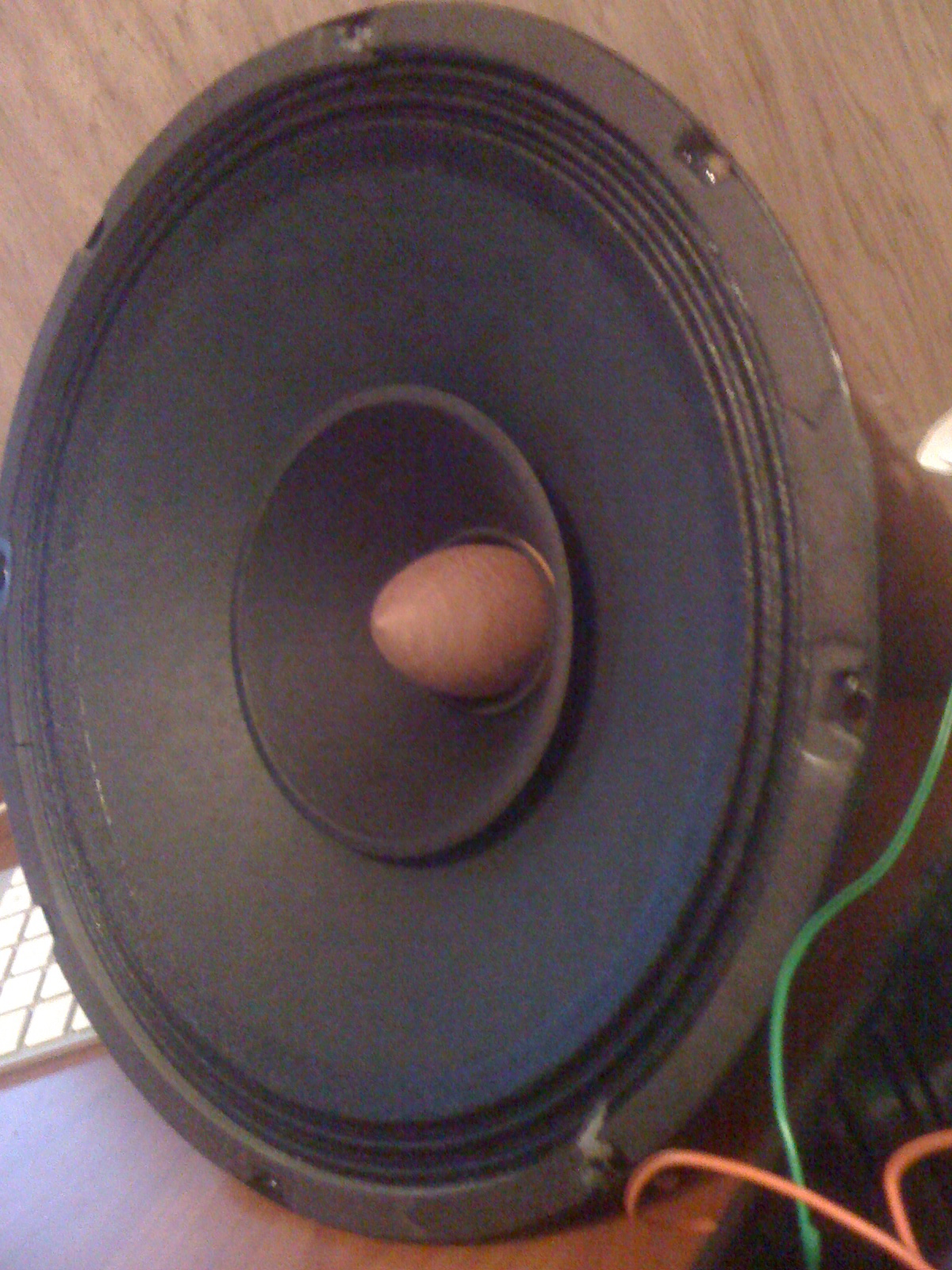

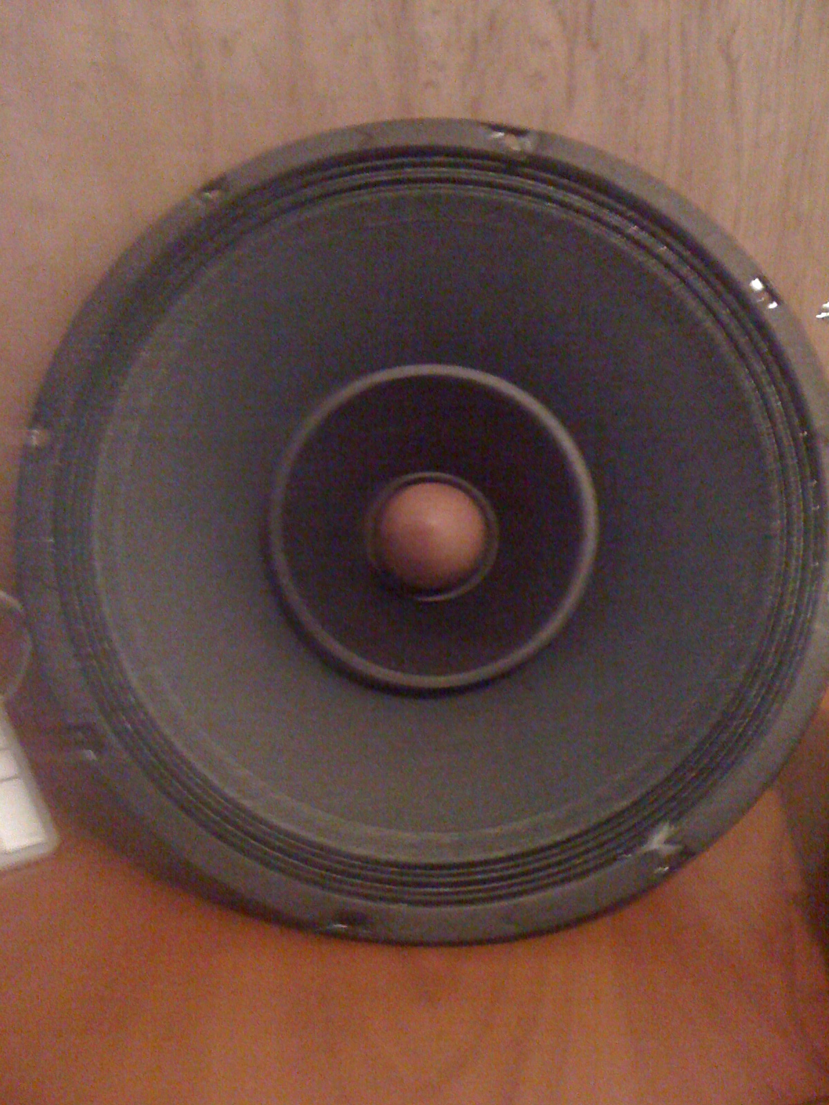

Just cut my dust cap out (easier that I thought - Thanks for the directions Godzilla & GM) and put in the phase plugs

Love the phase plugs. What are the dims? I was going to go with 3.5" x 1.25"
Suddenly the driver looks more 'hi end.' They look great!
They are according to Dave's (planet10) dims. 44mm dia 62.5mm long and about 38mm before the transition starts.
I have a second pair that are the same except they are 40mm dia - would you like them gratis?
