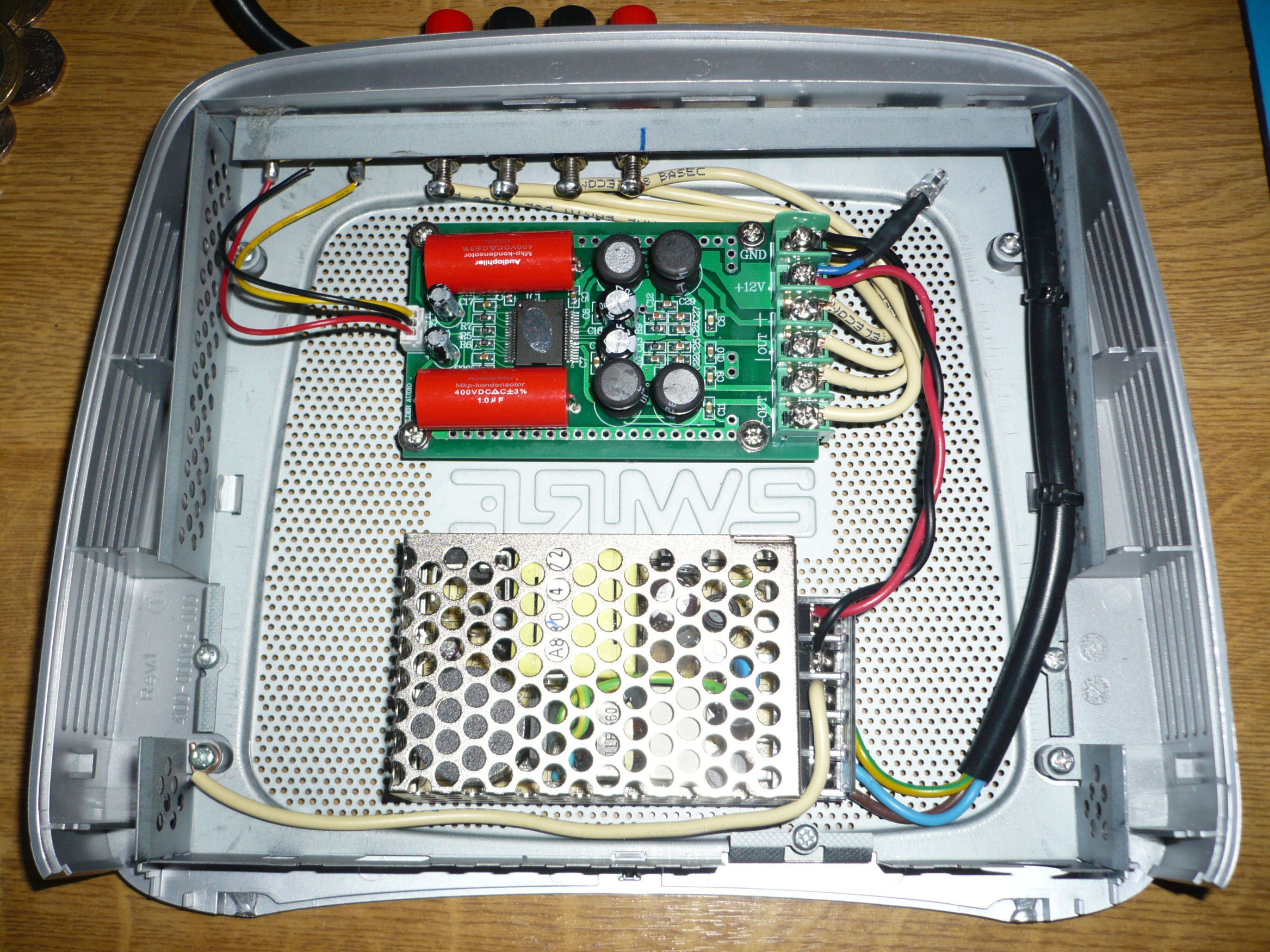

Hi, I can't quite see from you photos, but it doesn't look like yor ground connection goes to the case. If it does please ignore the following.
For a DIY project it is entirely up to you but if it was a comercial product you would require a direct connection from the ground tag on the inlet to a min size of 4mm screw or stud on the case with a shake proof washer. Its good practice to do this as it ensures if any mains leads come loose or if the switch mode lets go the box won't become live.
I'd also recomend a fused inlet if you haven't alread used one so if a mains cable does touch the box the fuse will blow in the box rather than taking out you house fuse (Which will take longer to react)

Hi
The case is grounded via the psu casing bolted in two places, also the mains inlet is a fused one with both poles fused (twin fuses).

The capacitor is a 3900uf 85v, I have a box of these so just used what is to hand (seems to do the job). The Arjen modules are pretty good out of the box, my only tip when building is keep the signal interconnects as short as possible!
Used good quality phono sockets (neutrik) and the amp is silent with no signal connected. Building these amps as been my first dabble with electronics for 20 years, so pretty impressed with the results.
Attached a picture of my first attempt using a TA2024 enclosed in an old 2Wire outer case, nice sound but not enough output for me!
I would like to build an amp in a wooden case but my woodwork skills are not great!
Rgds BITF
