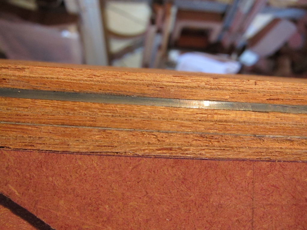

For the sides I use 3 layers of 6mm ply, 1 layer of 3mm lead sheet and 1 layer of about 2mm resin bonded fiberglass mat. I have attached the close up view of this hopefully you can see the various layers.

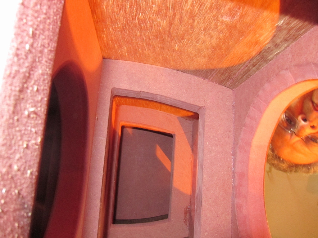

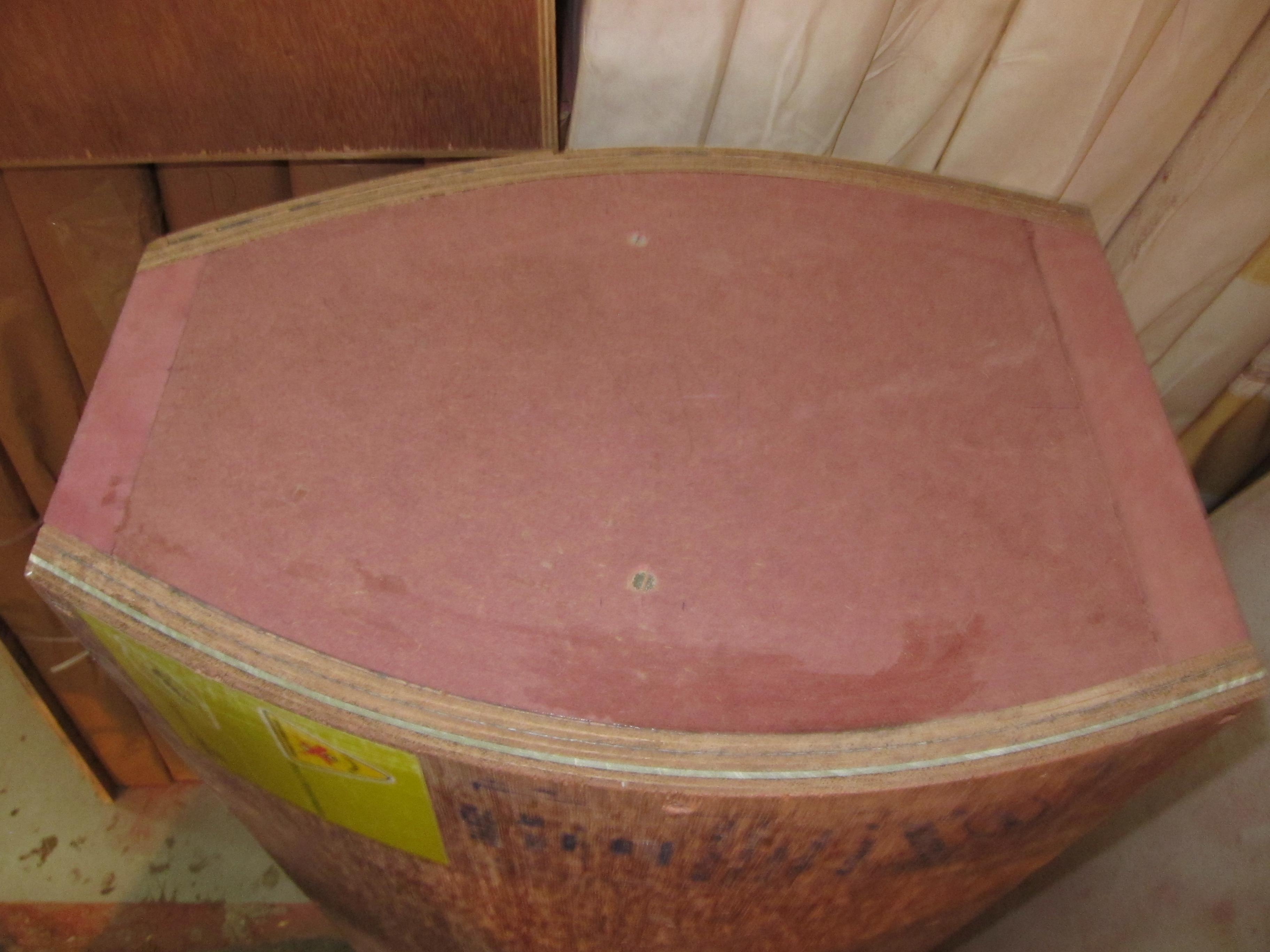

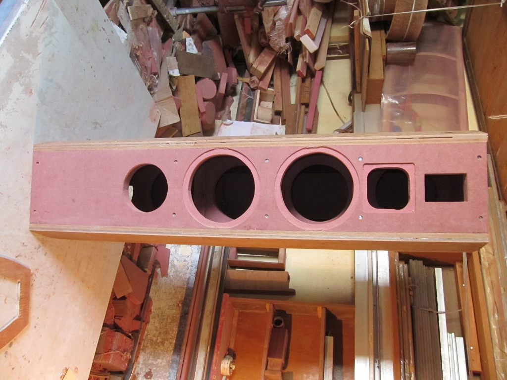

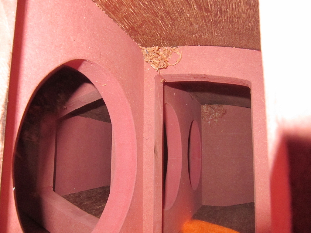

I have attached some pictures of a speaker I am building to show the layers of the sides, intrenal bracing, front baffle, curved sides (top view). My speaker will be be related to Rick Craig's Tempesta Extreme (it is his design with some cabinet differences).
