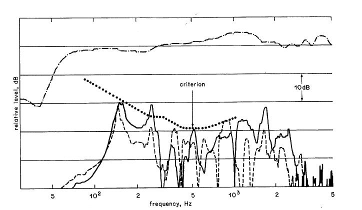

Approaching 1000 Hz is usually sufficient.
dave
You've had better luck than Harwood, who had strong resonances to above 2kHz.

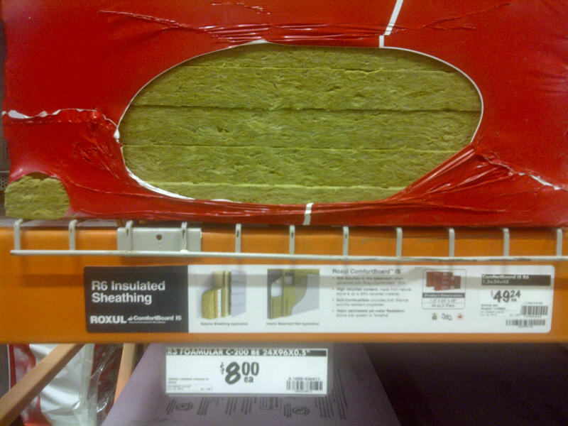

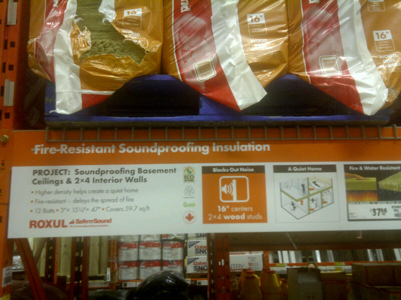

Roxul and other alternatives to fibreglass?
any idea if I can use this stuff instead of fibreglass (my local Home Depot doesn't carry the fibreglass) ?
