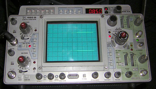

Best all around scope is still the TEK 465B. You would have to spend alot more than the original 4K selling price of this scope to get an equivelent "new" TEK scope. You could by at least three clean/used 465B scopes for your 1K dollars. Original selling price was close to 4K in the states during the last production run. Get ALOT more for your money this way and why anyone would buy anything except a Tektronix scope is bayond me... yes there are other nice scopes out there but these just can't be beat.... especially at the inexpensive- used prices they can be gotten for today. This 100 mhz scope exceeds its specs by a considerable amount..... the usable vert. channel bandwidth is almost 150 mhz!
BTW: This 465B cost me U.S. $78.60 off of E-Bay with the shipping from Idaho. It was in a rack mount and never carried in the field except by me!!
Mark

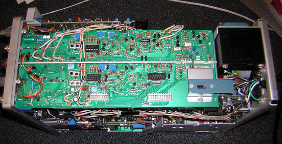

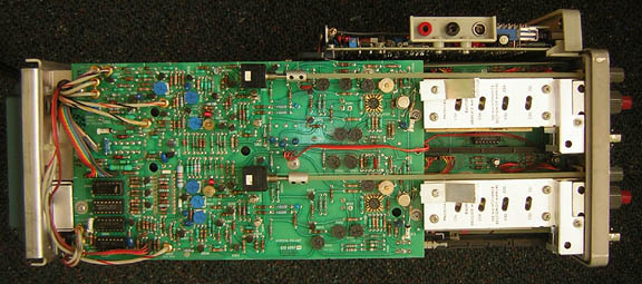

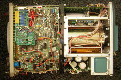

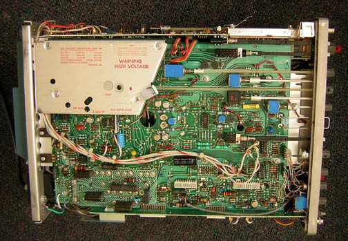

Great buys on used LeCroy DSOs right now...
Hmm. I like this topic. Here are some of my recommendations...
Digital:
LeCroy makes some real work whorse (sic) DSOs. Wonderful big crisp displays with unsurpassed measurement capabilities. Delightful (and expensive) machines. Only problem is, unless you chain them down to your workstation, they tend to make the rounds without your permission / knowledge! (hence the little joke above, hehe). It's easy to lose track of who's using and abusing your favorite office plaything.
More to the point, LeCroy recently discontinued factory support for their 9000 series DSOs (mid-90s vintage). As a result, there are tons of them flooding onto the used market at bargain prices as companies liquidate them and replace with new. Many are still in current calibration. You can get a very nice 4ch. 500MS/s for $1500, or go to the cheaper 9400 series which are larger and heavier, but have a vector scanned trace instead of a raster trace (nice!). You could get a clean 94xx for $400-$750ish. In the world of used DSOs, I rank these are IMO the best buys under $2k.
I managed to get a 9361 for only $600. Admittedly, I got an extra-good deal and it has a minor problem, but for 2 channels at 300MHz with 2.5GS/s and 25kS buffer per channel and fully loaded with all the software options, this was a bargain scope! It even has a very nice video trigger ability which will do all the HDTV formats as well as custom video formats with line select etc.. not a VM700 I'll admit, but still very nice. Most of the 93xx LeCroys have much larger buffers, often 250kS-1MS and handy little thermal printers. They're sluggish with the FFT due to the old processor inside (motorola 68K), but otherwise are very nice machines. IMHO, their big monochrome CRTs are still nicer to use than a brand new Tek with colour LCD, let alone the crappy little low-rez BW LCD you would get on something like an $800 used TDS220.
Analog:
The LeCroy sits on my home bench along side my trusty Tek 2445 - 4 channel 150MHz. The 24xx have one of the sharpest analog traces Tek ever made, a feature I certainly appreciate. And, it has a measurement cursor overlay which is nice. The 2445 cost me about $450 from eBay several years ago. You can probably get one for less now, or maybe the faster 2465. Buy two and use one for spare parts.
For audio band measurements such as THD, IMD, SNR, etc., I simply use a good soundcard. No need to indulge in an Audio Precision test set. My inexpensive 24/96 M-Audio makes very accurate measurements.
So for just over $1k, I've got a rather complete and powerful suite of waveform measurement tools. You needn't break the bank.
In general:
The Tek / HP / LeCroy stuff is mostly quite robust, but be wary of tier-2 and tier-3 brands . I rank Philips-Fluke at about tier 1.5ish, although I've never used or seen inside their scopes. The top brands usually represent a tour-de-force of engineering talent, while the lesser brands often build copy-cat designs with varying degrees of engineering talent, but almost invariably the lower quality is evident. So stick with the good brands, and if you've got the service manuals and the willingness to tackle maintenance yourself, these machines will gift you with a wonderfully instructional experience. I'm very definitely a better engineer today for all the debug and repair work I've done on various pieces of test equipment and instrumentation. Just reading the service manuals can be highly educational.
