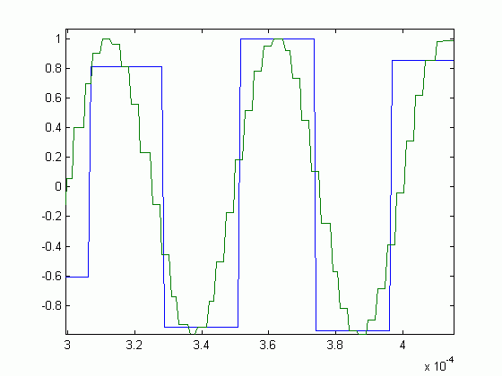

Jan and Christer, I think you are both saying almost the same thing here, and I agree with both of you. I made plot in Matlab to illustrate this.
The blue signal is a 20kHz sinewave sampled at 44100. The green curve is the same sinewave sampled at 8*44100. Then a zero-order hold is applied to both signals as in a R-2R DAC. By oversampling with a bandlimiting digital filter you eliminate the chance of the signal changing from full-scale positive to negative, thus reducing the step-size. However the sample period is also reduced, and without doing any heavy math I think the step-size is reduced by the same factor as the sample-period (in this case 8) so that the slew-rate requirements stay the same for both cases!
However one might argue that a slower slew-rate would just act as a low-pass smoothing filter, but we want to filter the signal with passive RC networks and not by transistor limitations don't we?
Also a very interesting paper here (as posted in a different thread), where the author demonstrates that slew-rate induced distortion is the same as jitter distortion :eek: and then compares two op-amps (pages 11-18) one with 500v/us and one with 50V/us for different sampling rates. Some real eye-openers here (for me at least...) Notice how the non-os case is much more sensitive to slew-rate than the higher sampling rates.
