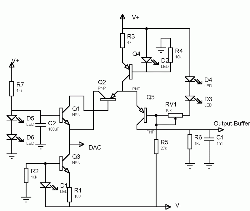

I did. Even posted kind of merger of Jocko's and Jan Diddens and Rudolf Broertjes circuit though I never built it. Will see if I can find that back and post again saving you to use that lousy searchengine.
Found it!
Its a Sziklai input folded cascode design. Or two times common base. It is drawn somewhat awkward due to that stupid schematic capture program or my computer blindness.

I'm a little unclear from your post if this is the circuit you listened to. If so, I would expect it to sound quite a bit better than any op-amp I-V stage. I'm not so fond of the Sziklai pair, as in my experience, this local feedback loop will color the sound. However, Jocko has found that the lowered input impedance here will increase bass "slam" and authority, presumably because of the lowered input impedance presented to the DAC output.
The rest of this circuit is zero feedback, which is something of a double-edged sword. This makes things much more transparent, but also much more revealing of the actual implementation. In other words, if you use (for example) a bad sounding capacitor with a feedback circuit, the coloration produced by the feedback tends to mask the problems of the capacitor. But in a zero feedback circuit, you will much more clearly what the capacitor is doing to the signal.
Elso:
Your implementation of the CFP is not quite right......
You have to be very careful to keep it from oscillating. Lower the gain some.......for starters.

Hi Jocko!,
It was just a proposal. I haver never built this one. I built something simpler from Rudolf or Thijs for real life testing. Will try to find it back. I know you are using open loop supplies.:clown:

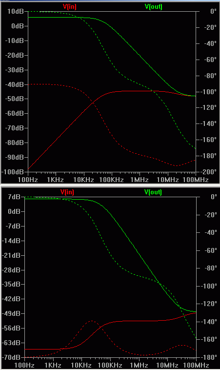

Just to give an idea of the problems that can happen when using an integrator (ie, op-amp) as an I-V converter:
a) Looking at the data sheet for the TDA1545 (sorry, I don't have the DS for the '1541), we can see that the analog output settling time is 0.2 uS. This translates to a 5 MHz signal.
b) The open-loop gain of the OPA604 at 5 MHz is approximately 5x. (Remember, it's really an integrator.)
c) Let's assume that you have the op-amp set to give 2 V output. With a gain of 5x (at 5 MHz), that means that the "virtual ground" inverting input is not a virtual ground at all. Instead, expect to see up to 400 mV of signal present there.
This is why you have to include a capacitor in parallel with the feedback resistor to roll of the frequency response of the I/V converter. If you choose a sensible -3dB point of 50kHz then there will be 100 times attenuation at 5MHz and the voltage at the inverting input drops to 4mV. Now if you choose the AD825 (as recomended by Walt Jung in the article you pointed to) it has a gain of 15 at 5MHz and so this voltage is reduced further to 1.3mV.
I ran it through LTSpice and it confirms this, here is the netlist:

Can you tell it is a slow day at work :)
I couldn't resist some plots...
Top:
OPA627: Avol=10Meg GBW=16Meg Slew=55Meg
Bottom:
AD825: Avol=4k GBW=40Meg Slew=125Meg
V(in) is inverting input, V(out) is output of opamp. Zf is 1.66kohm || 2nF.
Notice how, in the audio-band, the inverting input is 180 degrees out of phase with the current when using AD825 while it is 90 degrees out of phase when using OPA627. My gut feeling tells me this difference affects the DAC performance in some way. Inverting input voltage @5MHz is ~-50dBV = 3mV.

Just checked this with MicroCap. Model provided by ADI says at 5MHz the inverting input (closed loop; output impedance of the DAC set to 2k and I/V resistor is 1k - doubled value of the I/V resistor will double the inverting input’s impedance) has impedance of about 150 Ohm. Both AC and transient analysis show this. Since the open loop response of the model looks a bit shorter (11MHz) than shown in the datasheet (25MHz), and the phase shifts earlier, I would expect lower value in reality, maybe about half this value, but not less than that.

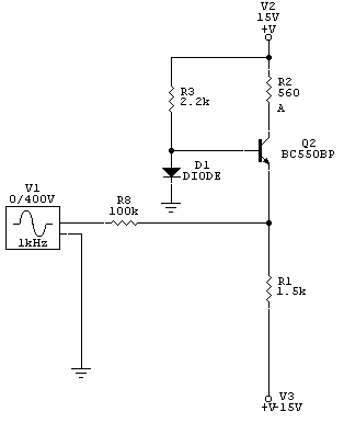

Charles,
This is the circuit I listened to with the NON-OS TDA1543.
I changed it a bit for the TDA1543: replacing D1 by two red LED's in series and R3 =15k. Also a 10µF bypass cap to ground at the base of the transistor, BC550C. R8 is omitted.
I got sound, though pretty low in volume and some hum. I do not like this sound. The timbre of the musical instruments is not right. And the sound gets on my nerves. I know this circuit is very crude. What shall I do, adding a constant current source or build my first circuit without the Sziklai?
BTW with a squarewave and the OPA604 I got the same amplitude (10mV) band of signals on my scope. Could not trigger it well.
It sounds to me like that you are probably not providing the DAC with the proper conditions for proper operation. The data sheet for the TDA1543 holds the clues to your problems.
First of all when you are using the op-amp I-V, it will hold the audio outputs at Vref that is also supplied by the DAC. In this case it is 2.2 VDC +/-0.1 VDC. Your circuit (as described) will have the audio outputs held at around 3.2 VDC (depending on the characteristics of the LEDs used). The DC compliance is stated as between 1.8 and 3.8 VDC (assuming a 5 V supply), so this may be all right but maybe not.
The AC compliance is restricted to 25 mV, which means that the input impedance of the I-V circuit must be less than 10 ohms for proper operation. For the simple circuit you have drawn the input impedance should be around 2.5 ohms (assuming ~10 mA bias), which should be adequate. However I would double-check the actual bias current, and also measure the actual signal level at the DAC pin.
A Sziklai pair will help in this regard, but I would probably keep the single transistor and bump the bias current up to 25 mA to get the input impedance down to 1 ohm or so. (You may or may not need a different transistor to do this safely -- I'm not familiar with the European devices.)
Next, the PSRR of your circuit is dismal -- zero! Any hum or noise on the rail is directly coupled into the audio signal.
Finally, all the little details will matter. What brand of capacitors, what kind of PS regulators, et cetera, et cetera. In the end however, I think you will find the journey well worth it.

Jocko Homo said:
Er, ah.....I mean Elso.........
Yeah, I would not expect that circuit to sound good at all. No wonder that your initial impression was not good.
Jocko
Yeah I should have listened.........to your initial suggestion having a common base stage between constant current sources.......right? Just wanted to do a quicky.......
