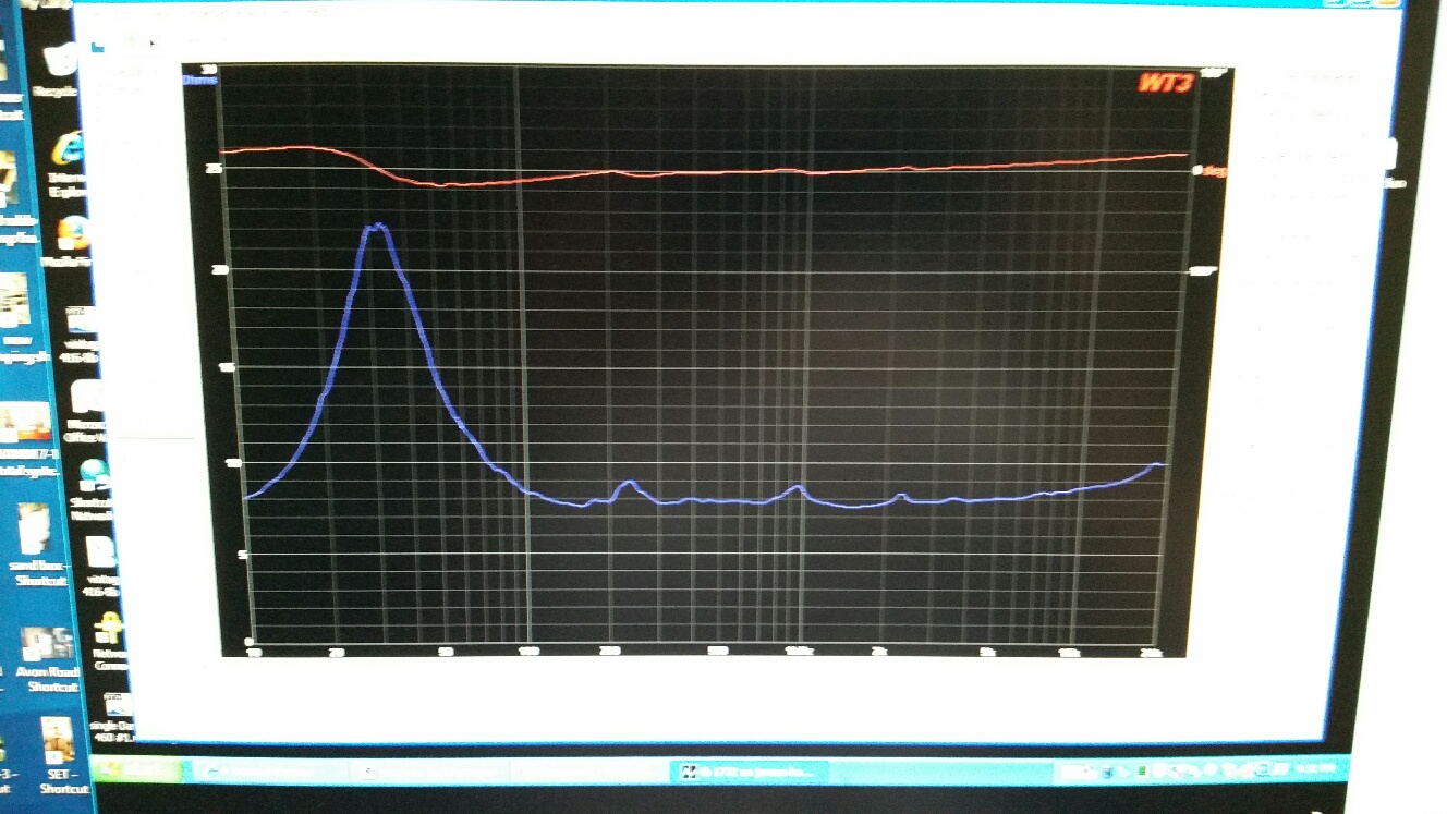

I have included the phase and impedance measurement of my mid-range section. I don't see the dip down to 5 ohms. I have no idea where you got that (?) CHECK THAT. The file is too big to upload here. I took a picture from the screen instead. Probably can't see much from it. Darn
You are right Scott: your driver's impedance doesn't fall as much as I had seen on the manufacturer's graph http://www.tb-speaker.com/uploads/files/c437a19a817c805066d11d113e29b0a5.pdf

On the graph supplied by TB,
the db is scale is on the left, the impedance scale is on the right.
Since the very first time I heard this driver, I knew I wanted it. It just sounded "right". (and "right" is a personal subjective opinion)
Indeed. I must have looked at the wrong axis. So minimum impedance is about 8ohm.
