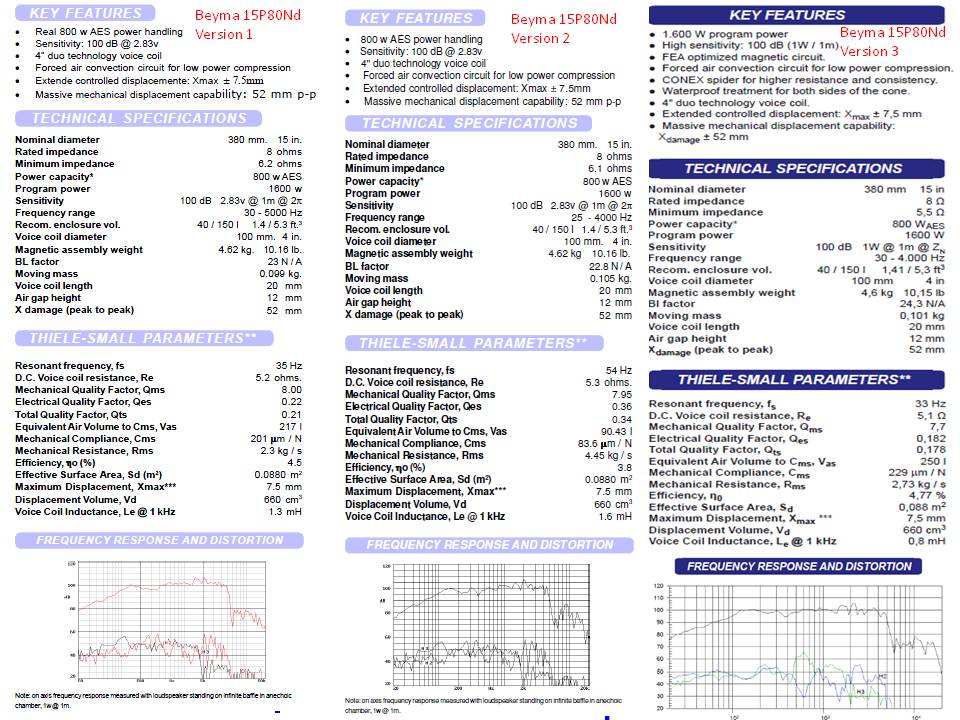

Actually, I discovered that Beyma have altered the published specs!!!
15P80ND was originally advertised as Fs = 35Hz from their earlier Beyma datasheet Number 028, and in Beyma's website and printed literature. Then sometime around summer 2011, the published Beyma spec suddenly switched to 54Hz as you correctly observe from the current datasheet Number 109. So maybe 35Hz was a misprint and 54Hz is the correct value???
When I researched and shortlisted this driver in the first place, it was largely using the old datasheet, and when I purchased them in August 2011, the dealer already had existing stock in their warehouse so they may even be drivers manufactured before the specs changed. I guess I'm not 100% certain which datasheet applies to the drivers I own, or whether there ever were any real world differences - ie. I don't know if the actual manufactured driver hardware has changed in design and performance compared to previous product, or whether the newest datasheets are merely corrections and revisions to the published figures for the same identical product all along.
I'm fairly certain the original datasheet had misprints - for instance, the net weight was quoted before as 3.6kg (ridiculously light!) and now corrected to 6kg. They've also amended many other T-S parameters for this driver, including slight reduction to quoted BL factor, slight increase to Mms, big increase to Fs, and large changes to Vas, Cms, Rms, and smaller but significant changes to Le, Qts, Qms, and Qes.
In any case the WinISD simulations I ran on the original T-S parameters and even Beyma's most recent published T-S parameters as well so not seem to be met very well by the actual product in real life, and there's also a hell of a lot of "coughing" air noise coming from the vent at the back of the top plate even in normal use, which I find objectionable. I've gone off Beyma's design a bit to be honest, and I don't entirely trust their spec sheets now either. I also found the TPL150/H wasn't anywhere near as flat as the published graphs would lead you to believe.
The 15P80ND is still a high quality woofer, but I'm happy to pay more money for something even better, such as the BMS or indeed the Faital Pro model I ended up choosing to buy, because I love low bass, dude!
I know this is an old post, and somewhat OT, but I asked Beyma about this yesterday because now the spec sheet says FS=33hz on the 15P80Nd. Got an answer this morning that the tech department had confirmed that the specs available now is correct.
It appears that Beyma built three different versions of the 15P80Nd speaker(attached). Not small changes... Version2 has Qts=0.34 while Version3 has Qts=0.179. Version3 has Le=0.8mH while Version2 has Le=1.6mH. The MMs stays from 99-105g.
The latest Version3 looks suited for a high efficiency midbass because of the low Qts = 0.179, Le=0.8mH, Fs=33.

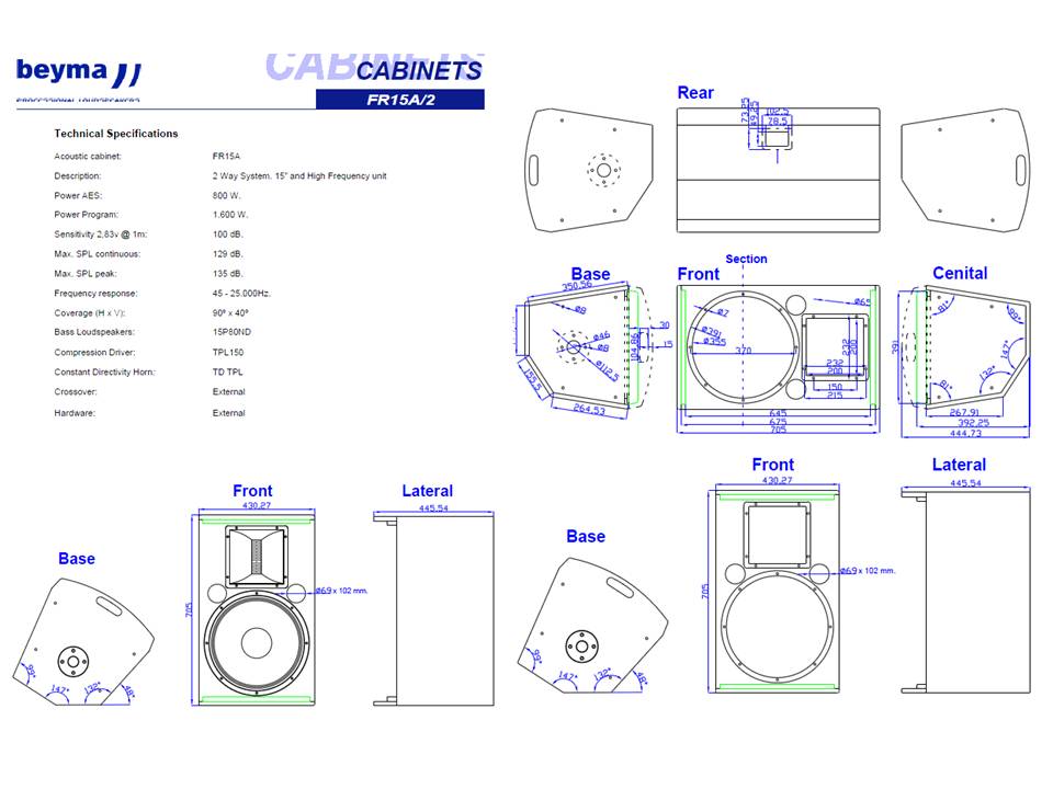

Beyma also has a FR15A/2 CAD DIY cabinet for the 15P80Nd and TPL150H AMT tweeter with a very low 1,000 xover. FR15A/2 CAD. Home audio quality would favor a 1600Hz Xover.

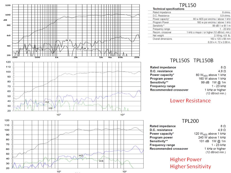

What is the difference between TPL150 and new TPL200?
From the datasheets, it seems that Beyma has manufactured at least three versions of the TPL AMT tweeters.
TPL-150 (80W, 5.9 ohms)
TPL-150Silver and TPL-150Black Lower resistance (80W, 4.9 ohms)
TPL-200 (120W, 4.9 ohms) Higher Power
It is possible that the research in this 2010 Beyma AES paper resulted in construction changes used in the latest TPL pleated membranes and motor.
http://www.beyma.com/uploads/descargas/1355215096.pdf

How do I know which version I have..?
You could measure the resistance of the voice coil. The newest third version V3 is 5.5ohms, first version V1 is 6.1 ohms, second version V2 is 6.2 ohms... this should separate V3 from (V1 or V2).
To separate V1 vs. V2
You could measure the impedance Z over say 20-100Hz in order to see the resonance Fs frequency peak. V1 =35Hz Fs, V2=54Hz Fs. This testing is done over low frequencies where most DVMs should be accurate.
BEST... build or purchase a T/S parameter test jig, You want accurate T/S parameters before you invest in Xover and cabinet design.
