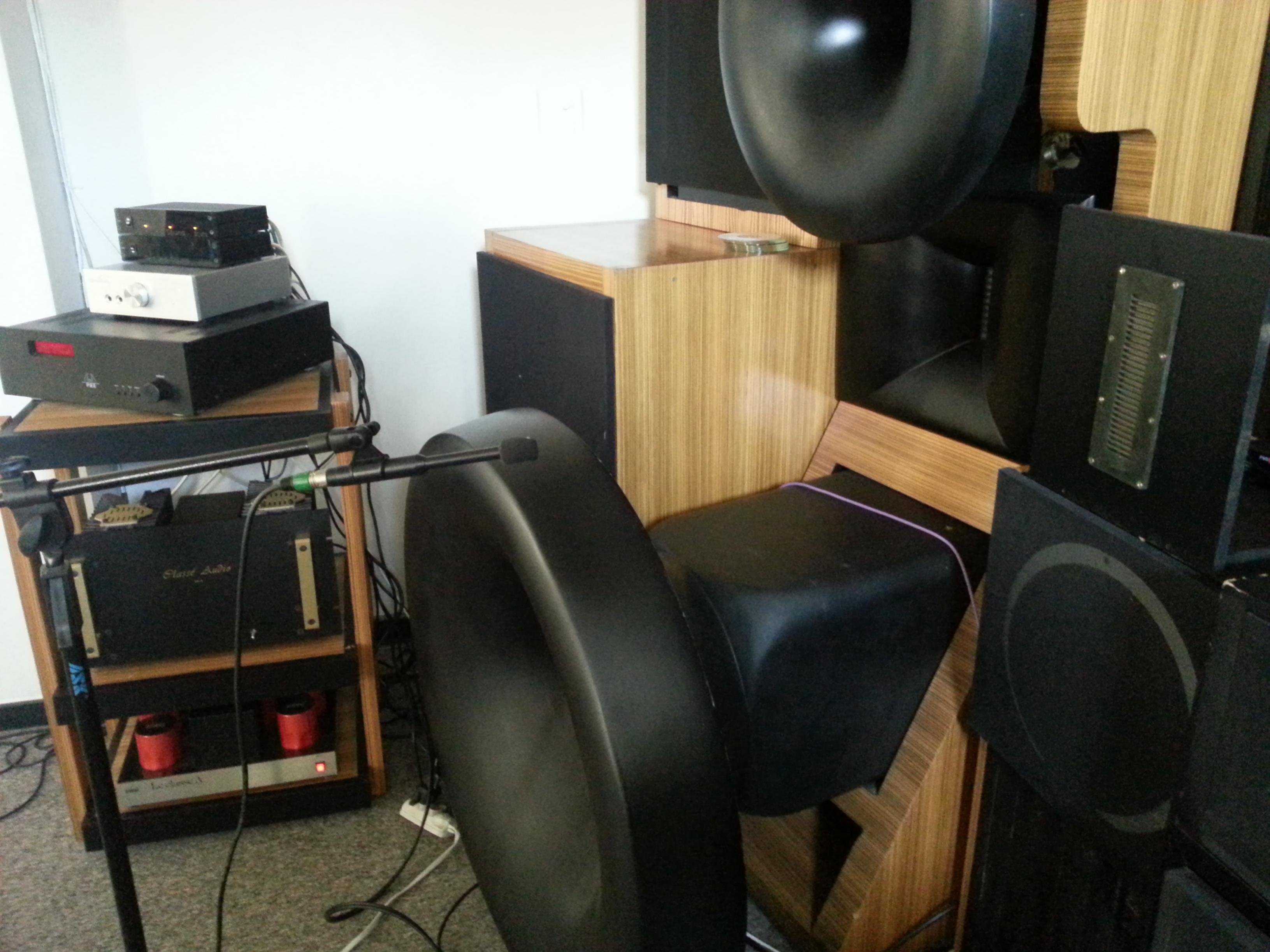

Raymond ( RayCtech ) sent me a pair of his midrange amt's for testing. I made a baffle for them ( 35cm x 30cm ). Back, its open, so it runs dipol. Today i hooked them up for the first time mounted on the baffle. I crossed them at 300hz , first order. Below,i use the Beyma 12p80Nd up to 300hz/24db.Since these are prototypes, and where folded by hand, they are not 100%, so at higher spl , at peak, there are some resonances, but nothing too much to bother. Integration with the woofer is not perfect, i will have to tweak and make some adjustments in the next days. Will do maybe also some measurements. So what are the first listening impressions? I would say, my reaction is similar as with the Beyma TPL150, when i listened to it the first time. It sounds very, lets say unspectacular. But in a positive way. It is extremely neutral,natural, open, revealing,fast, with correct timbre and tone. Voices sound simply as they should. I played already all kind of music, classical, jazz, vocals. It covers a very wide range, just as a guess, flat up to 10khz. More to come....:=))
Angelo
on the first picture, a size comparison with the Beyma TPL150

Am I to understand Beyma TPL150 is finally out ?
I think there is too big difference in radiation pattern between 12" midrange and TPL150 at the cross over. How about a smaller midrange, 6-8" ?

I like the combo TPL150/12p80nd very very much. I have no experience with smaller cone midrange drivers.

Maybe I was not able to follow your explanation, but I got the impression the AMT crossed at 200Hz was better than TPL150 and Beyma 12" ?
Elias
the main difference is that Ray's amts extend the purity, naturalness and speed of the TPL150 down to 200hz, and even lower. And there is no crossover from 200hz up. Thats quit a achievement. A supertweeter is necessary for frequencies above 15khz.

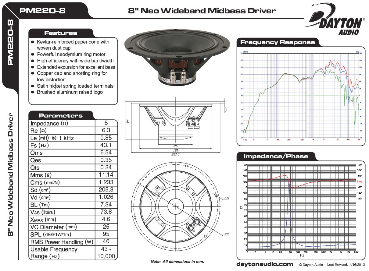

Someone told me the Dayton Audio PS220-8 is VERY good sounding , and at us$ 256,00 a pair rather inexpensive :
Dayton Audio PS220-8 8" Point Source Full-Range Neo Driver | 295-346
if using only for lower midrange, the whizzer could be cut off.
Someone told me the Dayton Audio PS220-8 is VERY good sounding.
The Dayton PS220-8 is a full range design with a whizzer cone and a phase plug.
Dayton also sells the PM220-8 midbass with a standard dust cap. The T/S specs model well, but the bumpy SPL/freq curve raises concerns.
