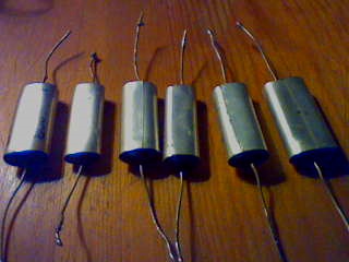

Caps in the picture are quite good, polyesther caps :D
They are not incapsulated, thus you can see they are a bit different in size
Values does vary a bit
They are not all of same value
Well, actually the biggest looking is one of the smaller values
And the smalles looking isnt exactly the lowest value at all
And within the same closest value, they atually sound slightly different
On many caps you dont notice the size difference because they are incapsulated in standard "holster"
But I bet the difference is still there, just not visible

I think toose are made in Bulgaria. Notorious for breakdown. The shoping is BAD:
Oh, might not be recommended fore tube amps ;)
Those are fore crossovers and work quite well
Monacor caps
Out of many caps I do have a big one that failed because one lead getting loose, but was stricktly my own doing, thats all
I have handeled them quite a lot, in and out of curcuit maybe hundred times without failure
I measure them too
Unfortunately prices have gone up lately

Yeah, we always need to be very careful not to stress the point where lead leaves the cap
I always bend the lead over my finger, if possible, or use something smaller
I always try to bend with a smooth curve, not sharp
Its also very easy to straigthen again, no problem
I have done it that way hundreds of times, even with the same cap
Bending leads and straightening again, over and over again, without any problems
But NEVER bend by just pulling in the lead, then it fails easily
