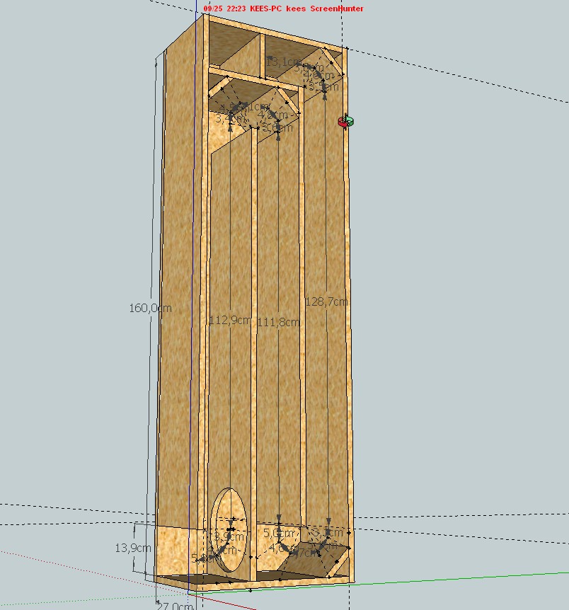

This is my open baffle measurement I use open baffle with subwoofer T_TQWT isobaric wsp26 s visaton woofers (xmax 22 mm).
I do remove the two baffles and make two 18 liter Aperiodic ones who has 60 hz highpass filter (6dB) as test.
But I want in future make horns, a tapped horn with two little horns who go to 60 a 80 hz, best for sub is 50 a 60 Hz bt this is offtopic now.
