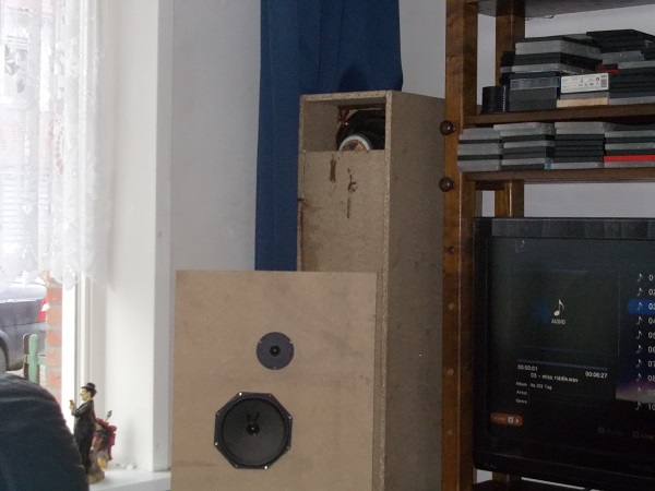

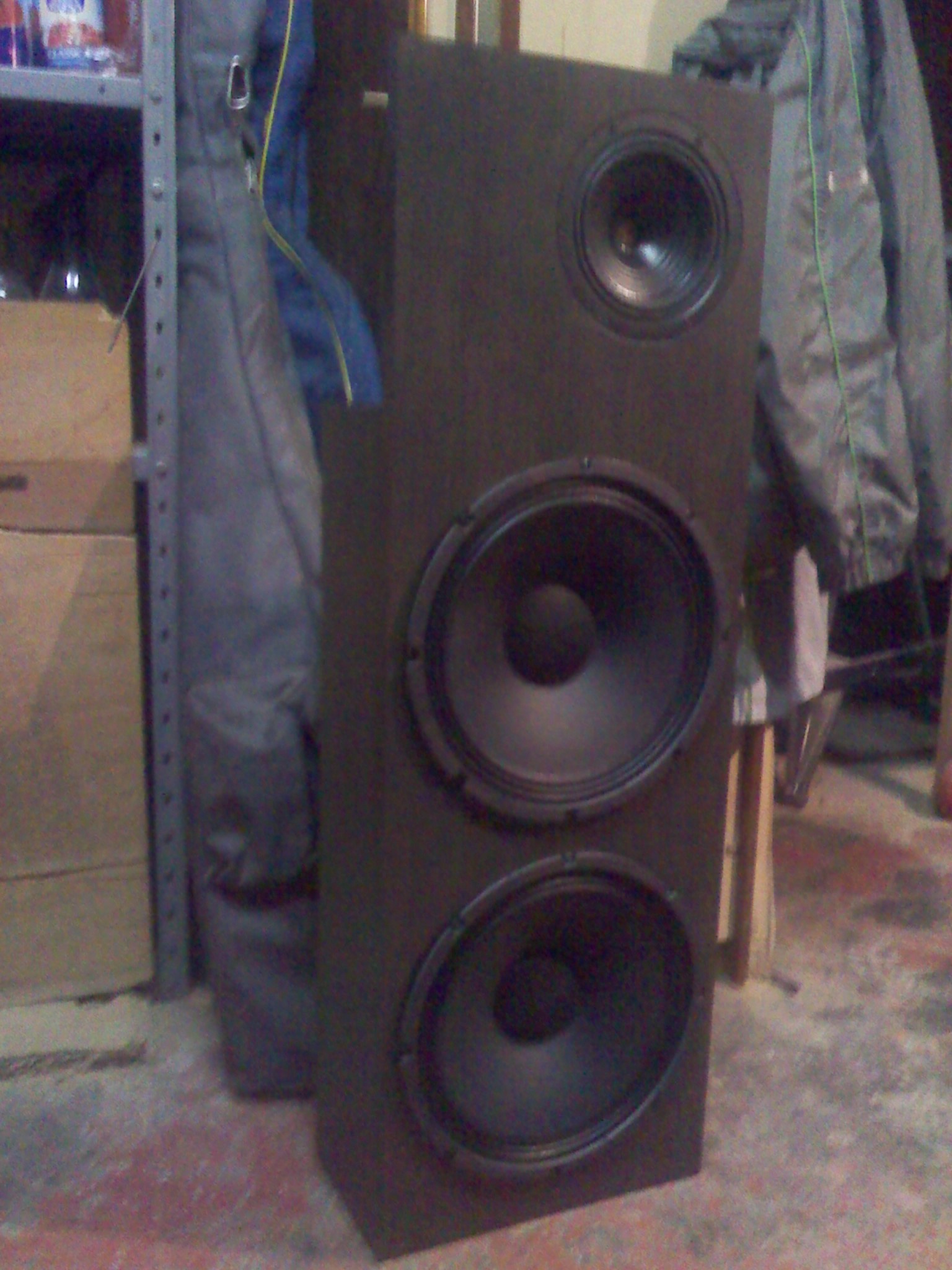

My Ob (Pagliacci)
If any interested, one day i will write about them. Exciting, inexpensive, not too big, full passive XO, easy to drive, thought in every aspect and with a full range never seen here and very transparent. They are "I Pagliacci"

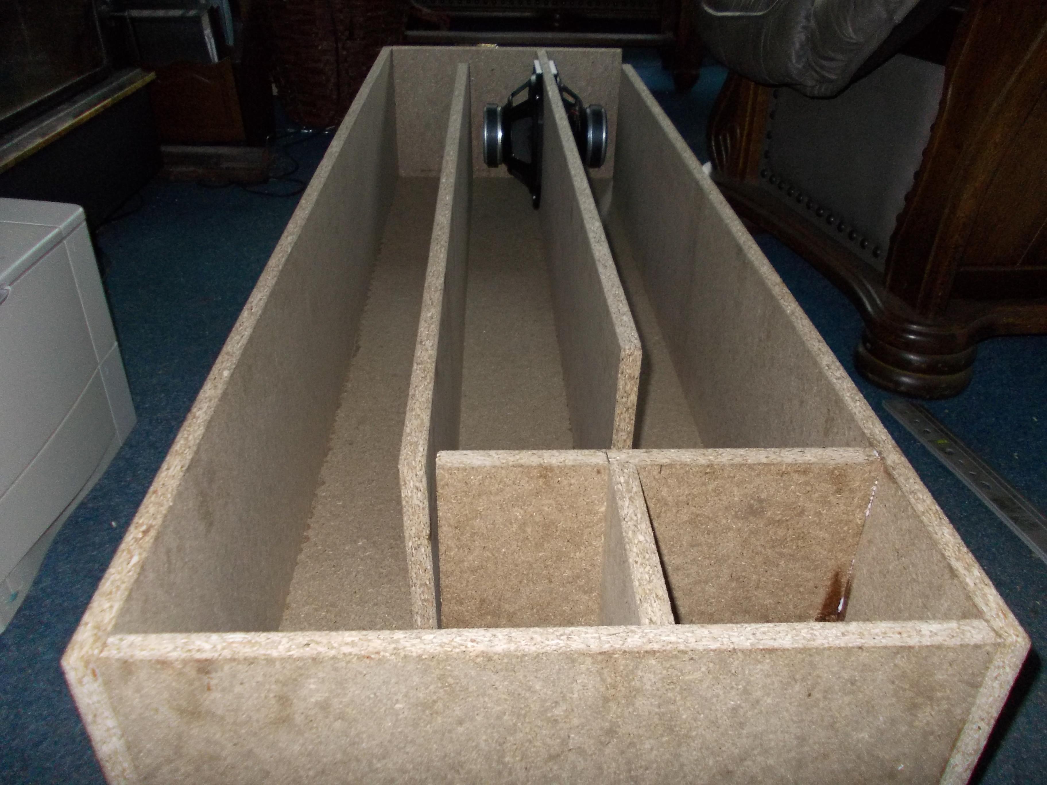

My plan was a max 10 inch woofer and an folded baffle for space.
I do use a sub from 60 to lower in my case 15 Hz.
I have a long time seen that electuur has a subwoofer system who has one box on two channels with a special crossover filter but i can not find it anymore, I have now one sub on left channel, this is not a good idea because I now miss info from right bass, and with modern technologie of recording bass has to be also both channels, so maybe that crossover has of to be use, maybe visaton has some info about this type of filter.

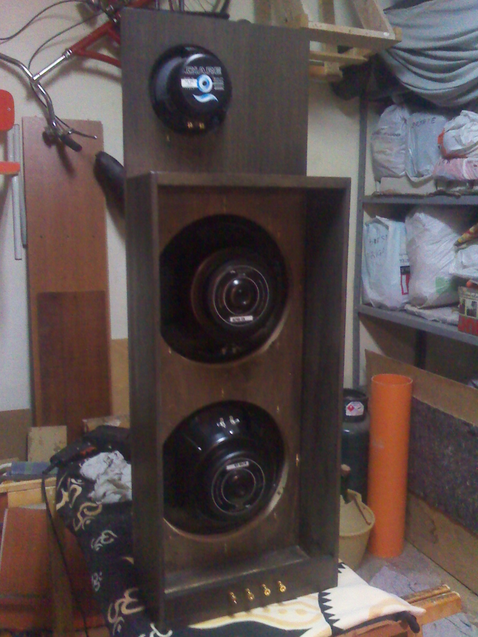

Thank you everybody for advice. My intention was to use Peerless 10' 8 Ohm, in sealed box of approx. 70 or so liters, attached to the lower part or half of an OB. OB should be 120cm tall and some 45cm wide. FR should be Visatone B 80, 6 Ohm placed at 90cm, maybe even lower-80cm? Cross freq. at 200Hz? Simple discrete Xover. Active or bi- amplification does not belong to 'hard core' or old school for my taste.
Alas, I don't know enough of the technicalias and calculation on this subject. So next post will have my questions if you don't mind?
