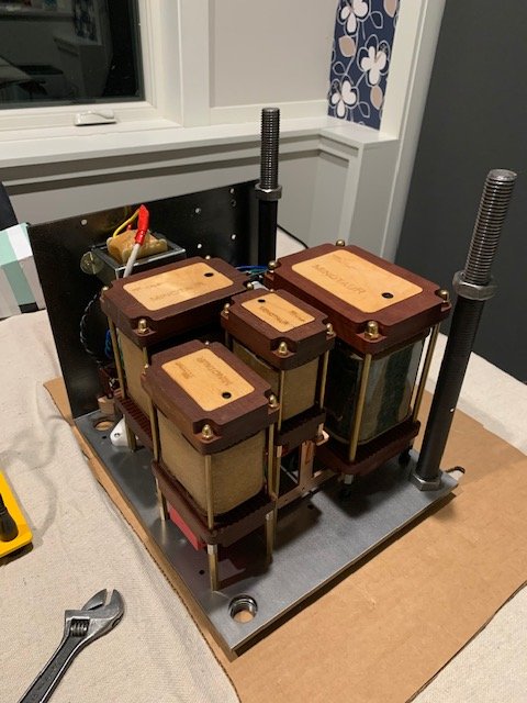

Hi Everyone. Regarding iron, I have owned a few over the years. Monolith SX-11 Nano, IntactAudio Nickel, J&K Audio. I sold these units, not because they were poor sounding. They are very good products. Rather, in my opinion, the finest are produced by Muse Coils (Alexander). His Minotaur series is the creme de la creme. Just one man's opinion. Here is a photo of lastest product using all Muse Coils. Simply the best in my experience.
