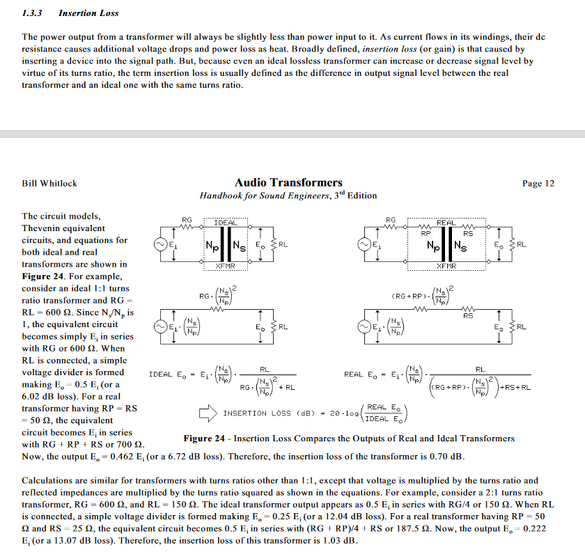

A 5000 Ohm primary that has no DCR, versus a primary (5000 + 500 Ohms) that has 500 Ohms DCR.
1 Volt across 5000 Ohms = 0.2 mA
1 Volt appears across the 5000 Ohms primary (that has no DCR).
The resultant power is transferred to the output (if there are no other losses).
1 Volt across 5500 Ohms = 0.18 mA
0.18 mA across 5000 Ohms = 0.909V
Where did the other 0.09V go?
0.909V + 0.09V = 0.999V
0.09V is across the 500 Ohm DCR.
0.18mA (0.09V) across the 500 Ohm DCR does not appear in the output signal power.
0.18mA (0.909 Volts) appears across the 5000 Ohm primary, and is transferred as signal power to the output (if there are no other losses).
Power = (E squared)/R
1V squared = 1
0.909V squared = 0.826.
OK, so it is only a -0.8287 dB loss with DCR, versus the power without DCR loss.
And so 10 Watts from the output tube, becomes 8.26 Watts
Now, does it matter if the only DCR is in the primary, and it is 10% of the primary impedance . . . versus a primary with DCR of 5% of its impedance plus the effect of a secondary with DCR that is 5% of its secondary impedance.
The total loss either way is due to a total of 10% DCR.
Right?

This explains it, using the appropriate formulas:

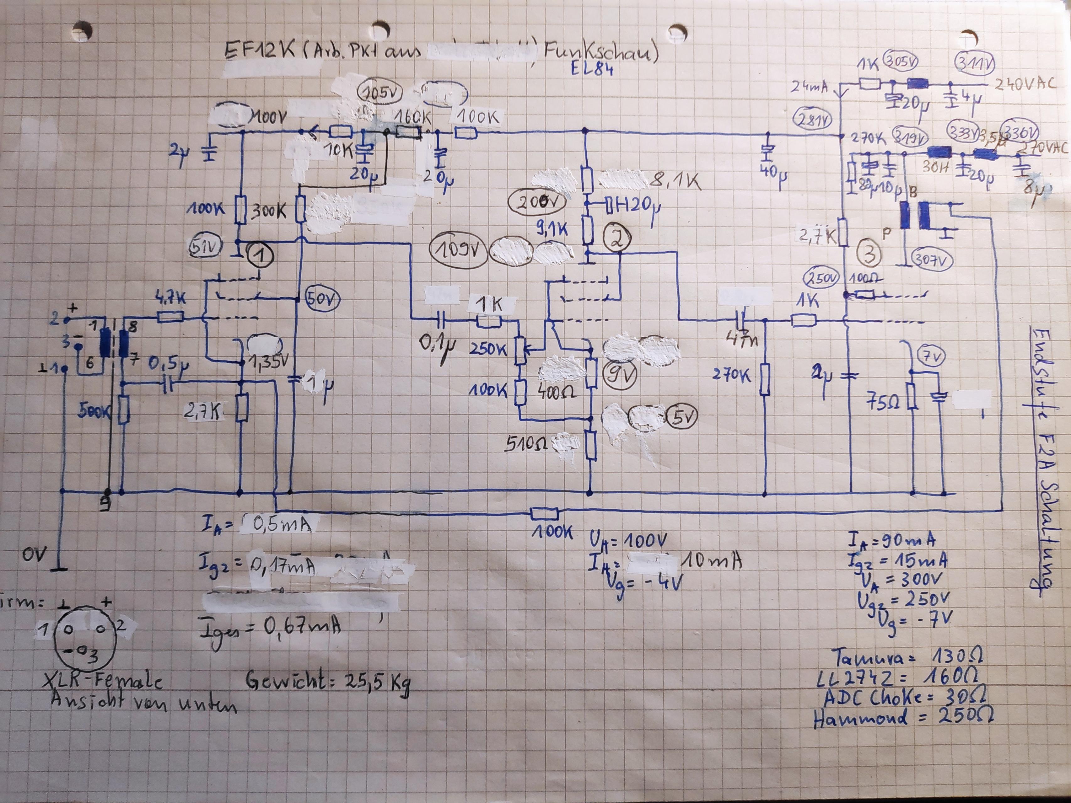

do you have a schematic for your F2A amp? I have a pair and I haven't used them yet.
The 6C4C seems to be a dual anode plate tube, like a 2A3.
Without knowing this tube in detail, I've always preferred single plate tubes like an AD1/RE604 over double plates. The price seems reasonable, but I paid not much more for my stash of F2A Siemens, a 10K hour pentode with the same output rating like a 300B.
How long ago did you buy your F2a. Ebay today F2a 500$ a pair vs 6C4C 80$ a pair.
But if the the F2a in triode, is a linear as the schematic suggest. I might understand the price. Especially when you look at how easy it is to drive.
Here you go. But this is one is hyper sensitive at the input...just saying.do you have a schematic for your F2A amp? I have a pair and I haven't used them yet.
Bought F2A five years ago, price was reasonable
