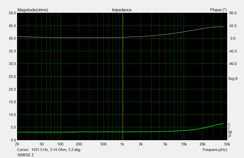

Since influence the sound is difficult to determine in a single measurement, I try to measure my amps in every way I know, to try to understand better sound differences (I need not say that often it ends unsuccessful ...).
But ... an easy measurement to perform in tube amps, and I almost never see been done, and more importantly, I've found it the ultimate explanation for the difference in some particular cases, it is the measurement of output impedance in all frequencies.
How to do it? Very simple, for those who have a sound card and the ARTA / LIMP: measures to the secondary output transformer as if measuring a speaker. This will show you the output impedance in a wide frequency range. I include here a measurement that I did with my 300B amplifier with custom made toroid OT (forgive me, in case I forgot to save with the scale to 10R, it would be easier to read). Note that the final audio freq, have a change in the ri and a consequent defasage in the damping factor, which no longer operate at 0 °. In fact, it is almost 40° in 20kHz. And that this transformer has only 3mH leakage inductance re 3k5 in the primary!
High leakage trafos will have much more than 45° in HF.
I noticed, several times, that amplifiers with high phase in HF DF sometimes sound more harsh, and amplifiers with zero or little lag in this area tend to sound smoother and softer. I do not know why (amplifier, tweeter interaction?), Or if it was just my luck ...
But this is only ONE parameter among many others to be considered, and most time supercedes this parameter.
The cure? only NFB, local or global, or an dream trafo...
I have an PP amp with PL509 with almost zero degree in 20kHz but it uses CFB directly at speakers balanced output (another custom made OT).

Hi Alexandre,
thanks for the post! So, just to make things clearer. Do you connect the souncard to the output of the amp as in figure 3.1 of the manual?http://www.artalabs.hr/download/LIMP-user-manual.pdf
and the amplifier's input is shorted to ground?
many thanks, obrigado, Erik
Hi Erik,
Sorry about my long delay.
Yes, in my testing gig I used this circuit as per fig. 3.1, but only because my Asus Xonar has a decent hphones output. Some audio boards struggle to deliver full output even in 100R, and introduce errors.
Is good practice to include input clamping to not damage the audio board if some signal is applied accidentally in the amp's input (eg.: some grounding disconnection) when the audio board is connected to the amp in this manner (measuring the output Z as a speaker).
After the reading node (left in soundcard) is necessary to use good gauge wire to not introduce impedance errors, or create a overlay with the residual shorting measurement to subtract from actual measurement. And is good to maintain short wiring due to inductance involved in low impedance world.
The amplifier input is shorted to ground to minimize noise.
