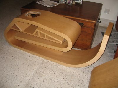

despotic931 said:Out of curiosity how do you think this build of the Dallas III was done?
Obviously it was laminated with numerous thin sheets of plywood and glued together, all mounted on a flat frame, using pegs where the bends were to be made. If you lay out a flat base, and draw a cross section of what you wish to make, you can drill holes at strategic points and make pegs/dowels all along the curves to act as strong points.
As you glue each thin sheet, you continue to wrap them around the contoured shape that is kept in place by those pegs. Once the sheets are glued up, then they all are clamped tightly and allowed to dry. When the lamination dries, the pegs are removed and the shape will be permanently set.
There may be some variations to this, but that is how you make contoured, laminated shapes, without having to go to the kerfed plywood, which can also be used, but not as well IMO.

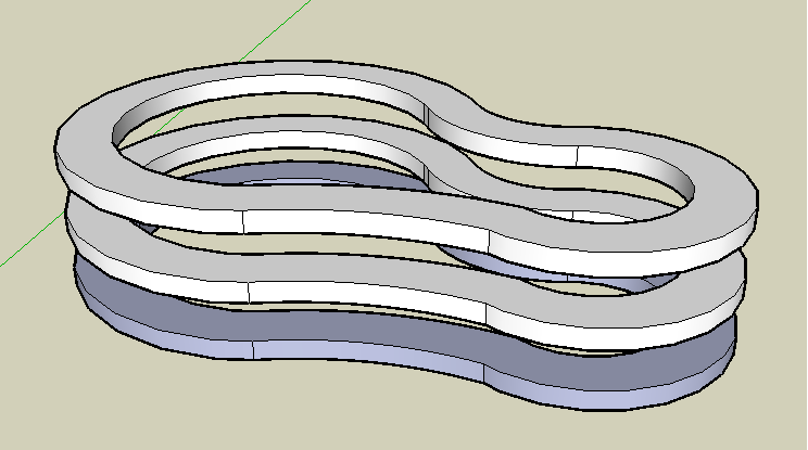

That looks like a laminated build up that's been veneered inside and out. Laminations cut on a CNC router perhaps.
See graphic below.

I wouldn’t know how exactly they did it without having a closer look at the piece itself. Nevertheless, there are few different ways you could do it.
Certainty it’s a pain in the behind.
Let’s break the job in parts.
1 to 1 Template needed to lay out the parts and figure out joint angles. (side view if you will)
As you notice, there are straight parts and radiuses involved. Straight parts wouldn’t present any problems except joint angles and orientation. Curved parts are more of the pain. You could make lamination jig and vacuum it (if you have it) or you could make a jig for the router and make enough of the exact same parts for each profile to build up to the width.
The amusing part is to join all this insanity in to one coherent piece.
If I had to veneer it, I’d work each part separately, taken my time and build jigs for vacuuming. Original maker could contact cement all the parts or use heat sensitive glue. Edges were probably veneered last to cover the joints.
I suspect that there’s made in 4 parts and joints are blind splines.
This job would take me about a week and a half to do it my way but I would be able to produce same exact pieces relatively quickly after.
